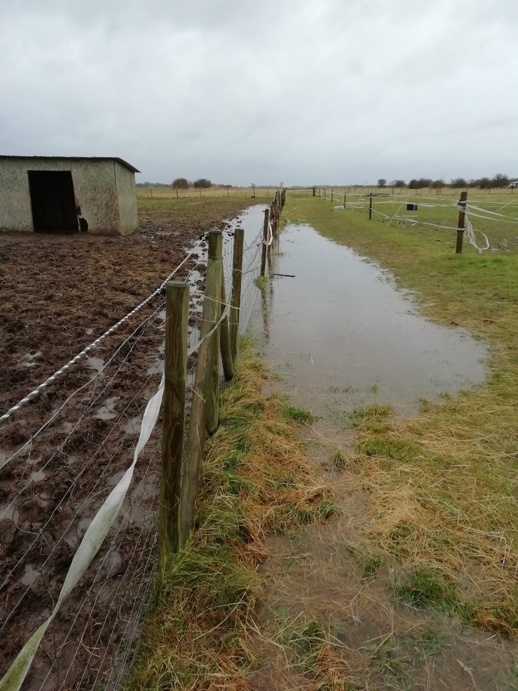

If it wasn’t for a business rates increase of 9000pa I’d move to Lincolnshire
Oi wat you mean no hills?! the waters not laying there because its flat!!Youd save a fortune in fuel as there are no hills

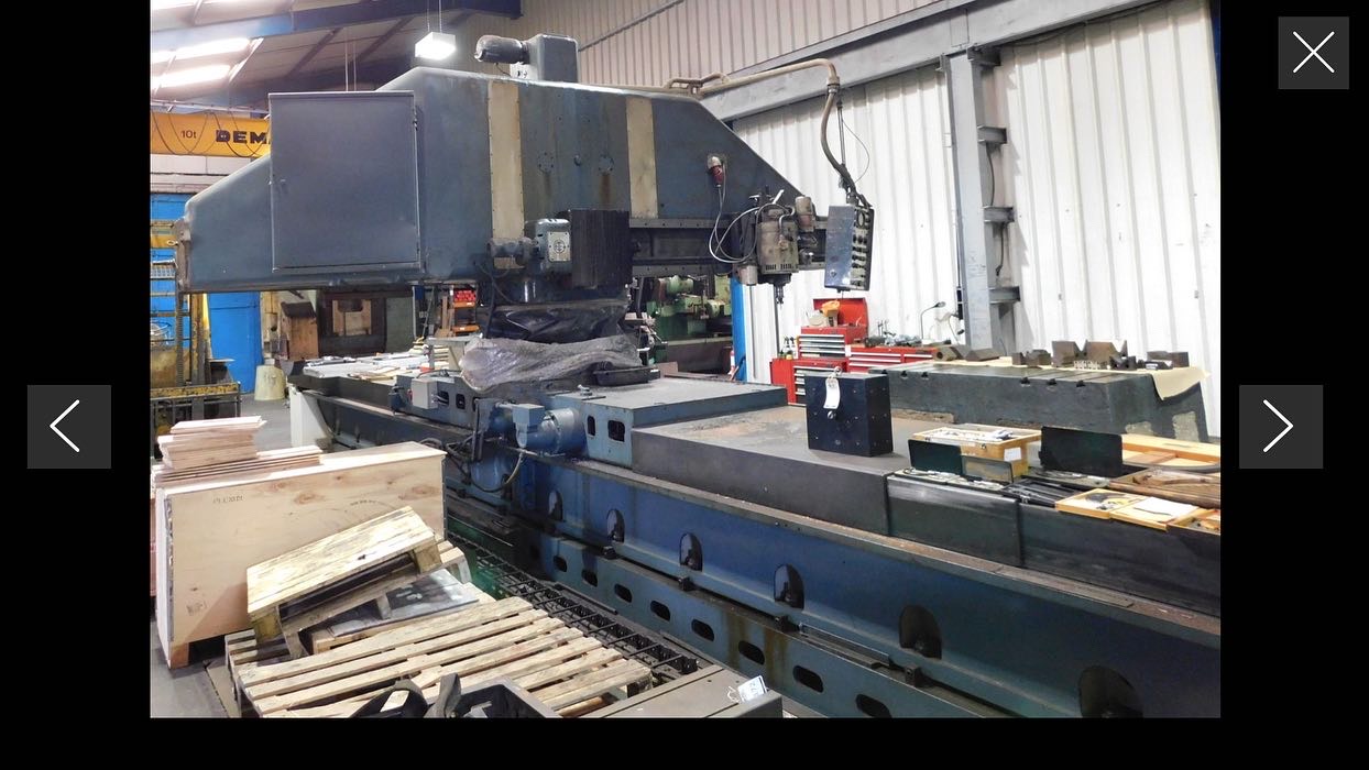

The travelling column machine was the last one in the uk that had the capacity to grind wide beds . Two day removal policy insured it went to scrap. I now know the landlord didn’t inforce this
Nearest place for machine widths over 1250mm is Poland
The machine above was scrapedAssuming all goes well and it makes the trip on the 9th, that may actually turn out to have been a blessing in disguise - possibly put off a lot of potential bidders?
My machine is 1250 wide and 2500 length
I thought it was 3000 grinding length
So short bed lathes and milling machines
Is that 1250 by 2500 grinding capacity? Still useful.The machine above was scraped
Aye going to do most lathesIs that 1250 by 2500 grinding capacity? Still useful.
