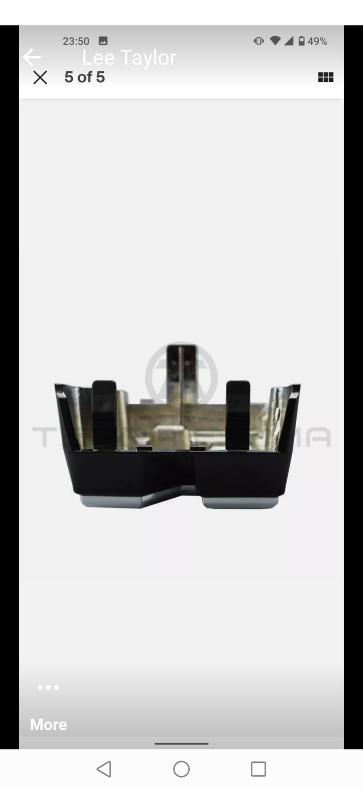

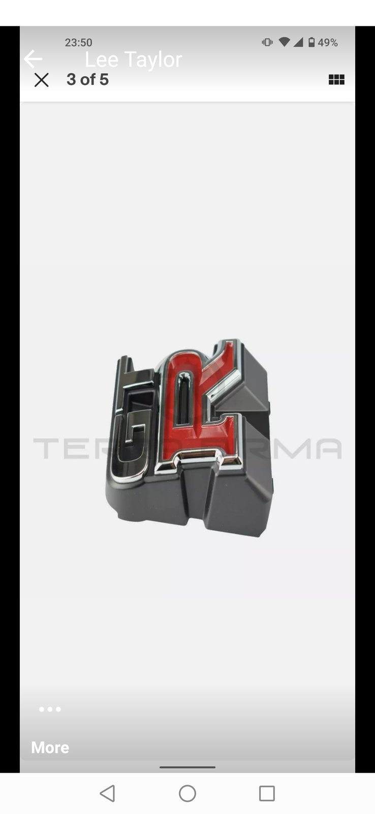

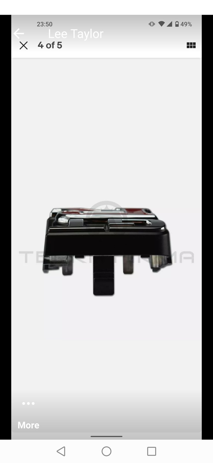

Just the outer mate.. I need to be able to extrude the profile so it's thicker at the bottom than the top eventually but getting the profile is a start.Do you need it profiled or do you just want the outer profile
We already have the badge. https://www.ebay.com/itm/123561538057
The screen cast will help immensely.I’ll knock it out for you tomorrow if I get a chance. I’ll screencast it too.
Not got that far to even try yet mate...small steps.Extrude with taper
