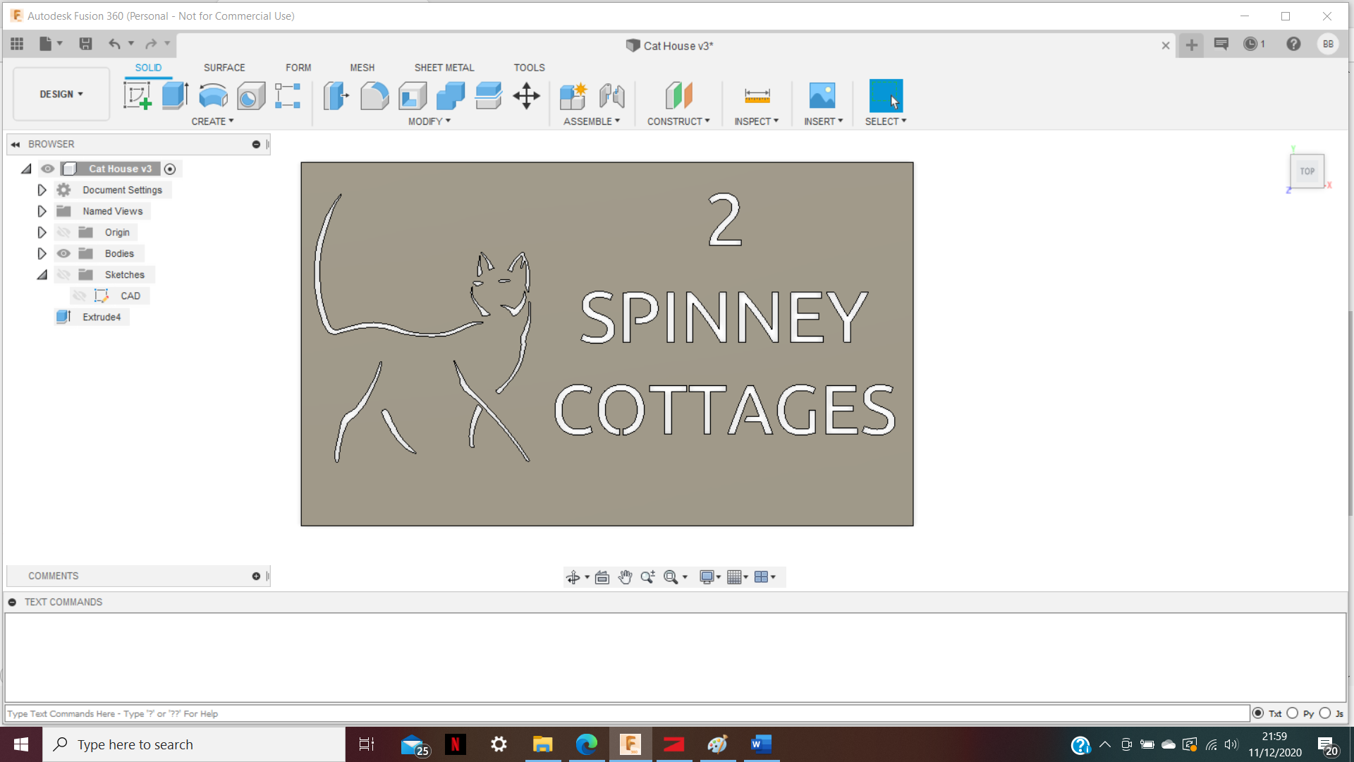

Well I took a screenshot of the image from the PDF, put that into BobArt and vectorised then saved as a dxf. Put that in Fusion and then just extruded to get the model.
That’s certainly quick and painlessBobCAD is great for things like this.
