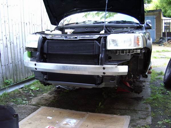

Check your radiator(s) while the front end's off as it's the best way to change them...
then try and restore some colour to it with the heat gun
, or look at the GTecniq stuff - pricey but good.
I used it as a trial on my last car - restored colour and shed/beaded water, but I can't remember what durability was like [it was c. 4 years ago.....]

???? looks like the apprentice did it 3hrs !! i had one freelander that had a bad alternator at some point and boiled the battery which put battery acid in the grommet ( forms a little cup) for the nsf brake pipe, just under the battery impossible to see, but rotted the pipe through in one precise spot, the pipe was perfect every where else, bar for the 10mm in the grommet and it burst!!it seems it was a bit of a pain as it took them over 3 hours......
Freelander-9 by Stuart Burrows, on FlickrNo DAB?Minor update, front end all nailed back together and just waiting for some bolts as the under tray was held on mostly with optimism, i've put more bolts in but I want matching
