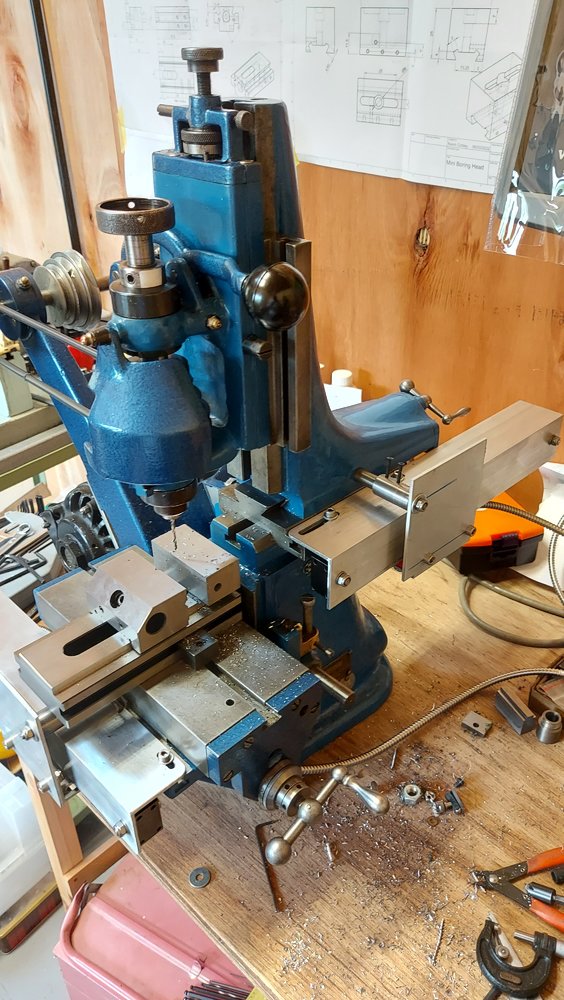

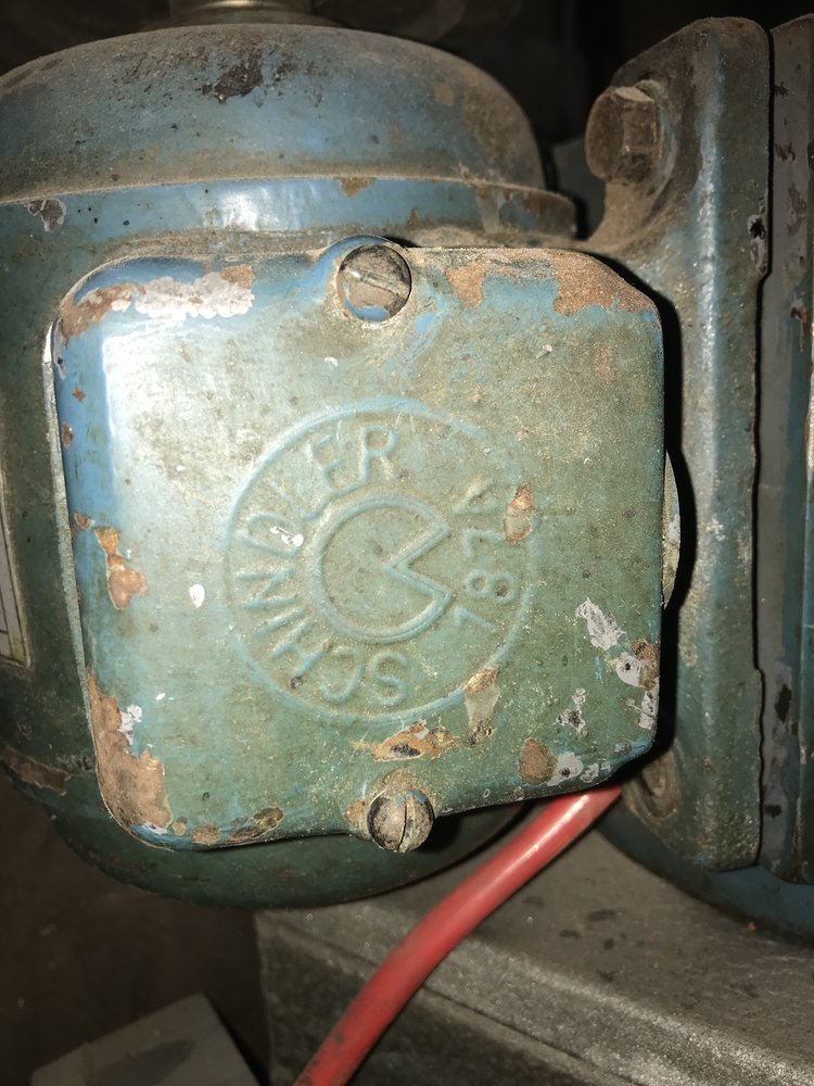

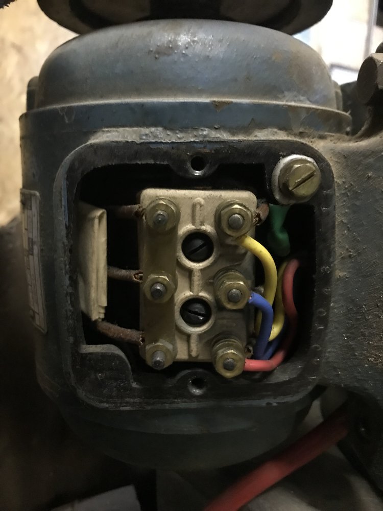

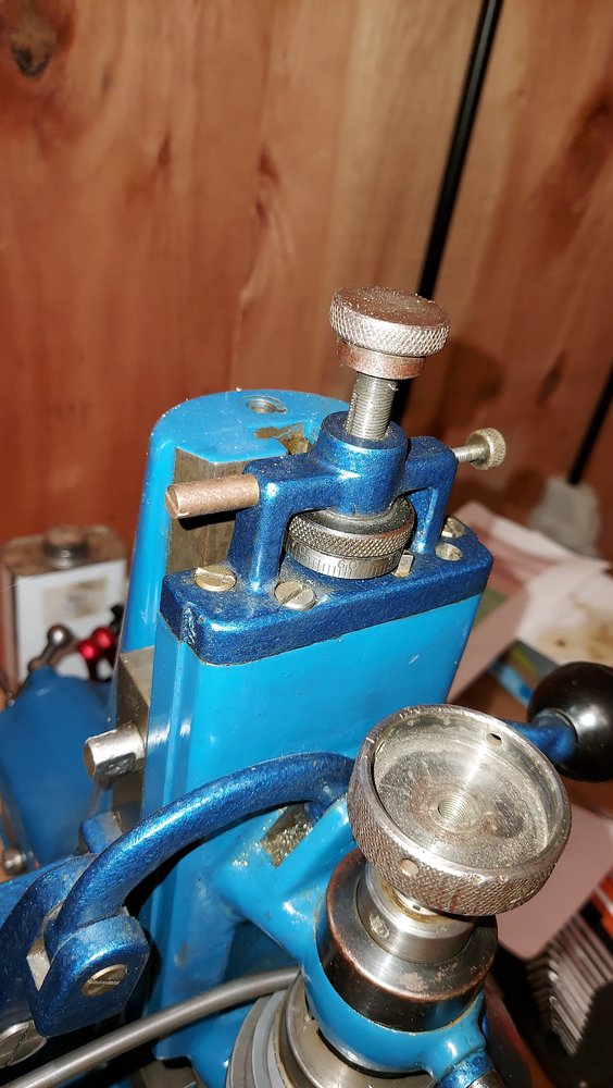

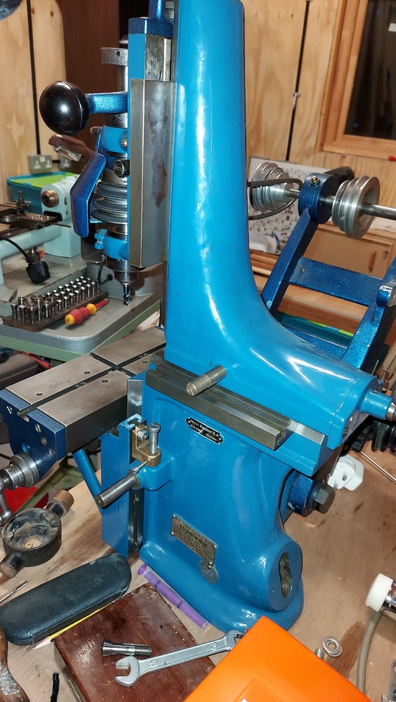

I have (hopefully) attached 3 photos of one of my original Hauser motors. It currently is setup up for 415v star - but sometime soon the "bridges" will be rotated to enable 240v delta operation with a VSD (Australia)I too have a Hauser mill, very different to yours, did they ever build two identical machines? The one I have is similar to the green one on Lathes UK http://www.lathes.co.uk/hauser/page6.html but has the motor bolted onto the heavy main casting. My machine too has lost whatever levers it had for moving the tables, except the vertical slide one. At present I am stuck as the motor is three phase but wired star. I did post about it on here but nobody seemed to know if it should be fed three phase as it is, or if the capacitors, etc, had originally been mounted separate, so 240v and cap wires fed into to the motor. Anyone else got a Hauser with it's original motor? Those tiny and expensive collets that they take are a bit of a pain, I only have a collet for 1/4" dia cutters on my machine.
