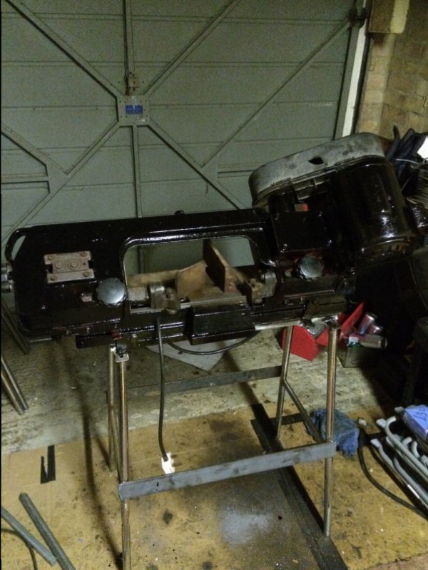

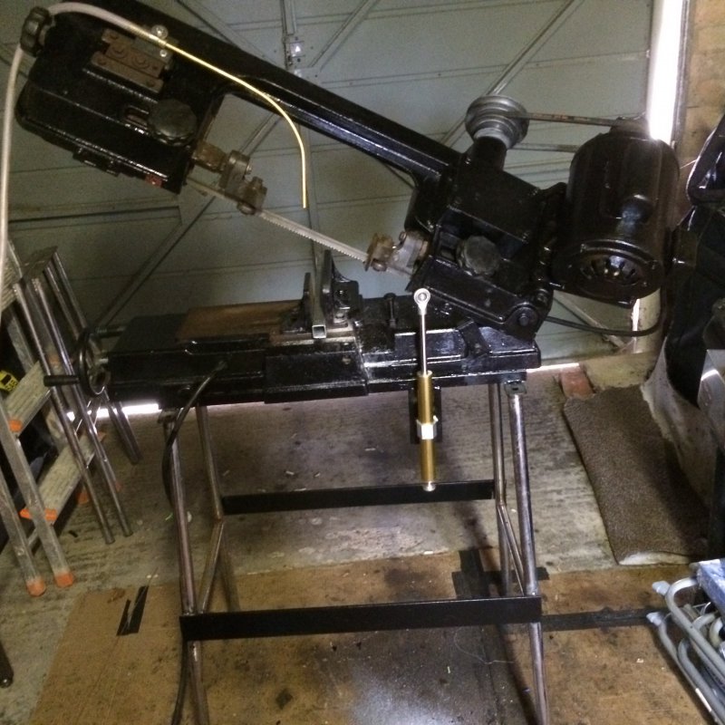

The only down side is I can't see my self jacking it right up before every cut.
Doesn't need jacking, that could be blanked off as lifting the bow refills the cylinder through the one way valves used by the jacking piston.

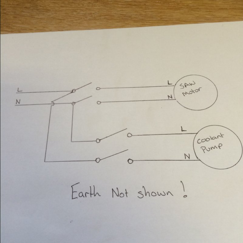

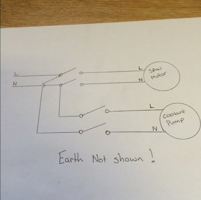

It's simple as though. Just literally class it as a single, separate mains lead to each item, the pump and the motor. Then, snip the cables in half and use double pole switches to reconnect the two halves of each cable.
