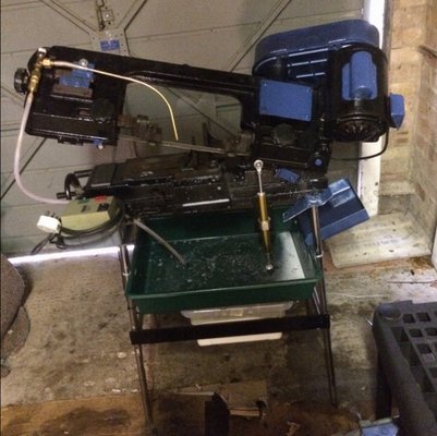

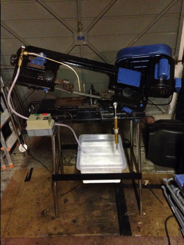

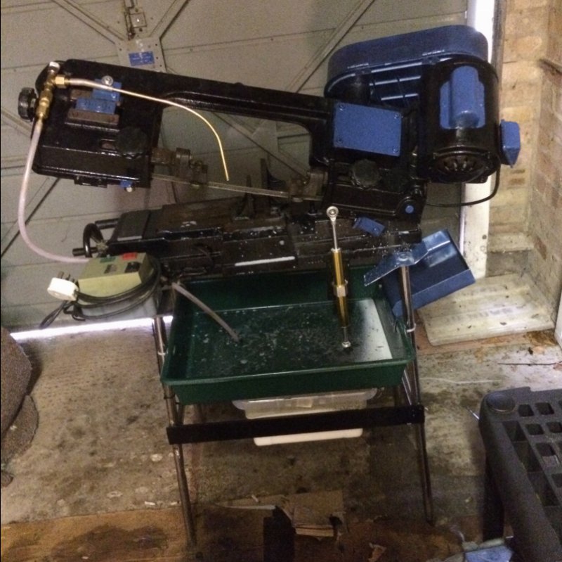

Ok so we are at the final stages.
A splash of blue breaks it up a bit.
15ltr tank and I decided to take wallaces advice and fit/make a flow tap. I butchered an old regulator flow meter and used some brass fittings which has worked perfect for a good fine adjustment on the fluid flow as I didn't fancy dunking my hand to adjust at the pump. I'm now waiting on a decent heavy duty garden tray and some fine filter mesh, then I think I can call it a day. Should be this week with a bit of luck.
Just needs some neon's under it now bruv init
Those bits of blue really set it off, and that tray looks a lot less lossy.
