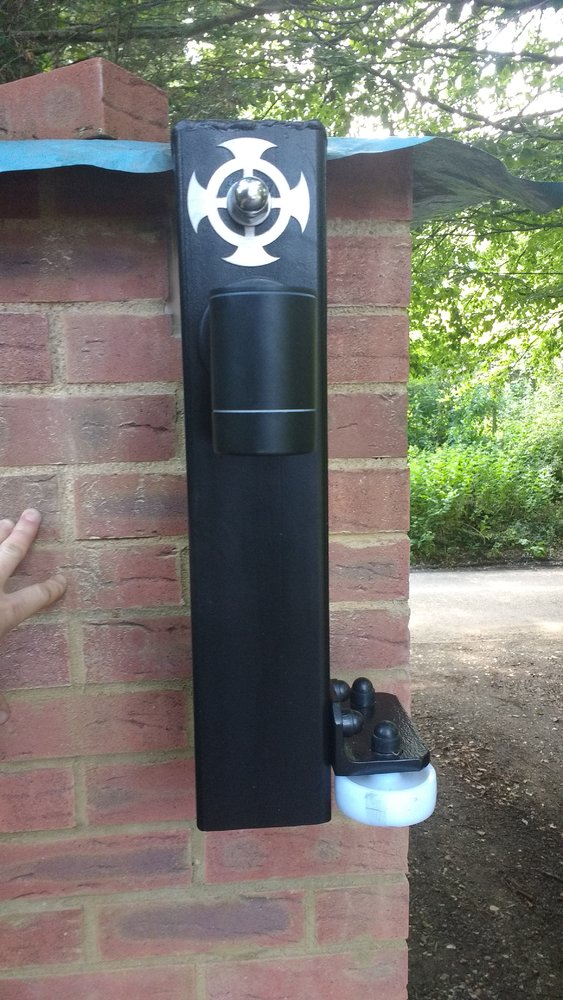

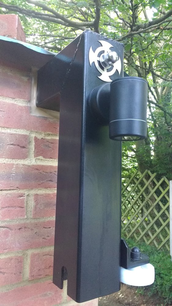

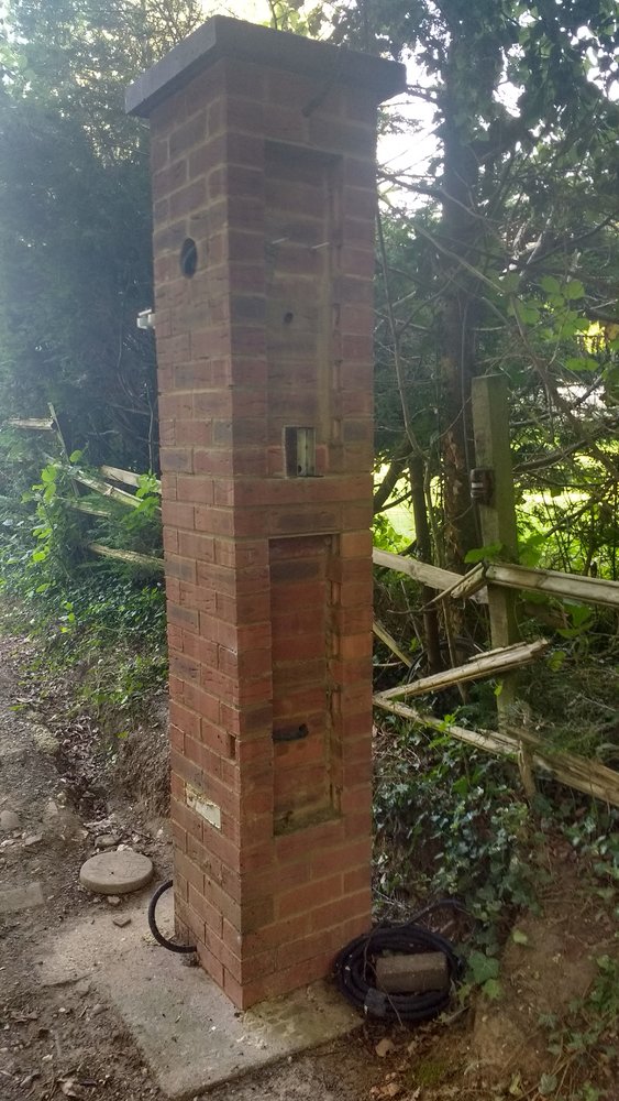

Like that! SWMBO won't know the difference!
Here you go.

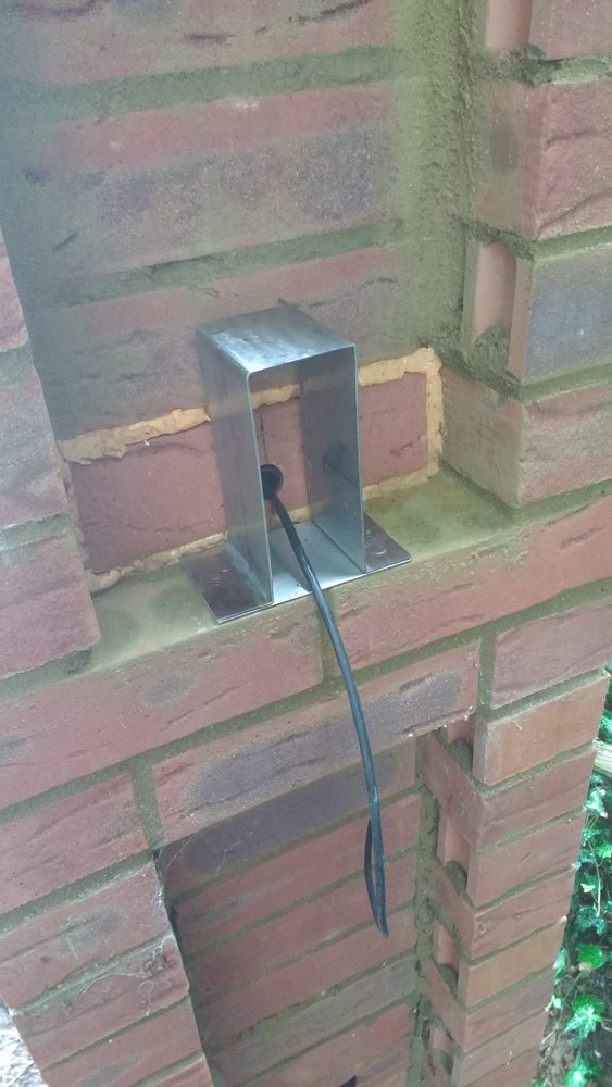

What kind of settings did you use for what I presume is .6/.8 SS plate?Little st/st mounting, bezel thing for the video doorbell. Made from an old door kick plate stick welded with 316 rods. Need to knock up as internal plate with a couple of rivnuts on and tack that in:

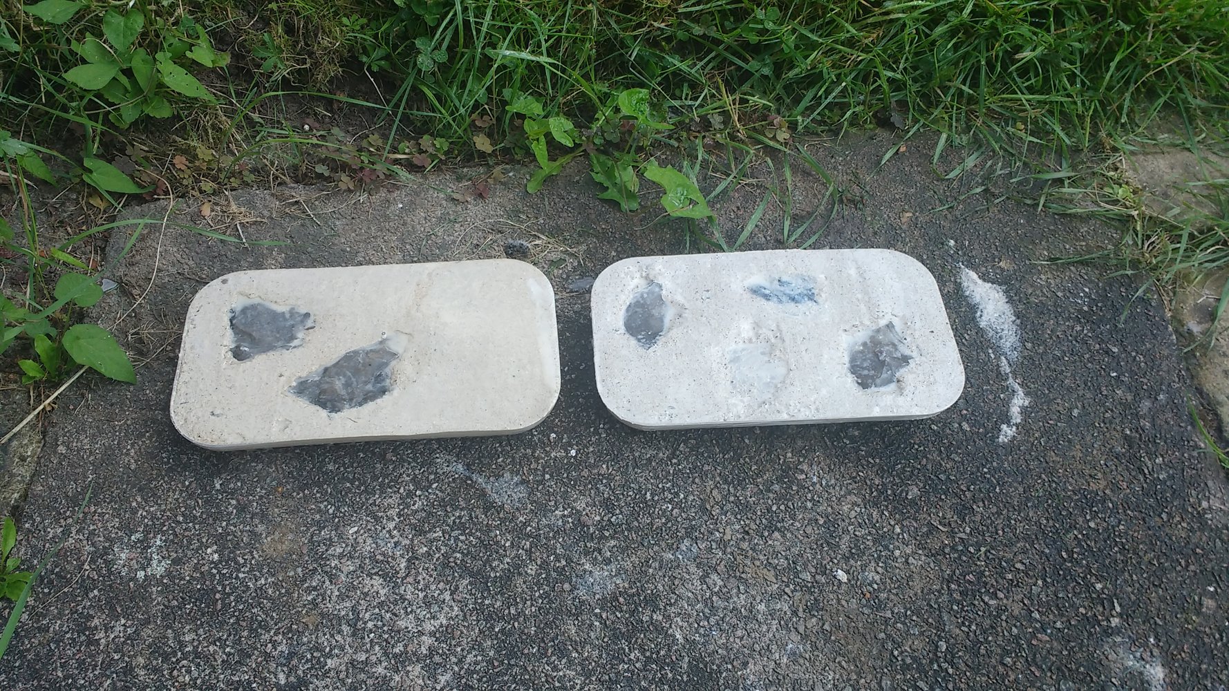

Consistency's a tiny bit too sloppy, needs to be firm enough so it holds the flints up but doesn't mess the surfaces too much. Don't do too much at atime or it might slip down, no rush.

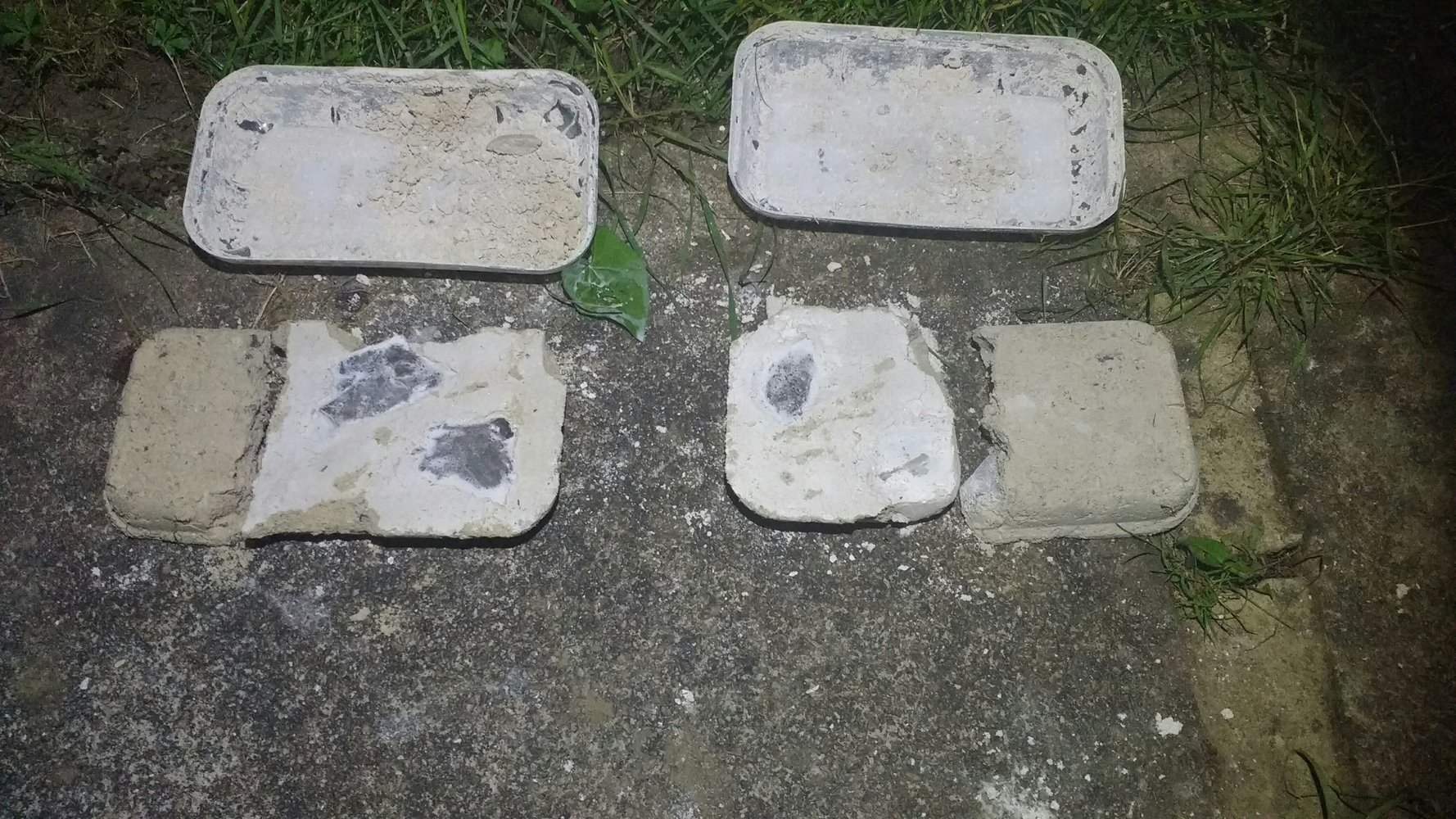

The one on the left, the 1 lime : 1.5 sharp : 0.5 soft (for colour), although more of a mortar colour, well it seems softer and you can gouge it with your nail easier.
I'm wondering if there's an option to up the lime content (if that's what increases strength) but still make it less white?
Hope that makes sense!
Or should I just give the samples a few more days to dry out as in will everything just get harder with time?

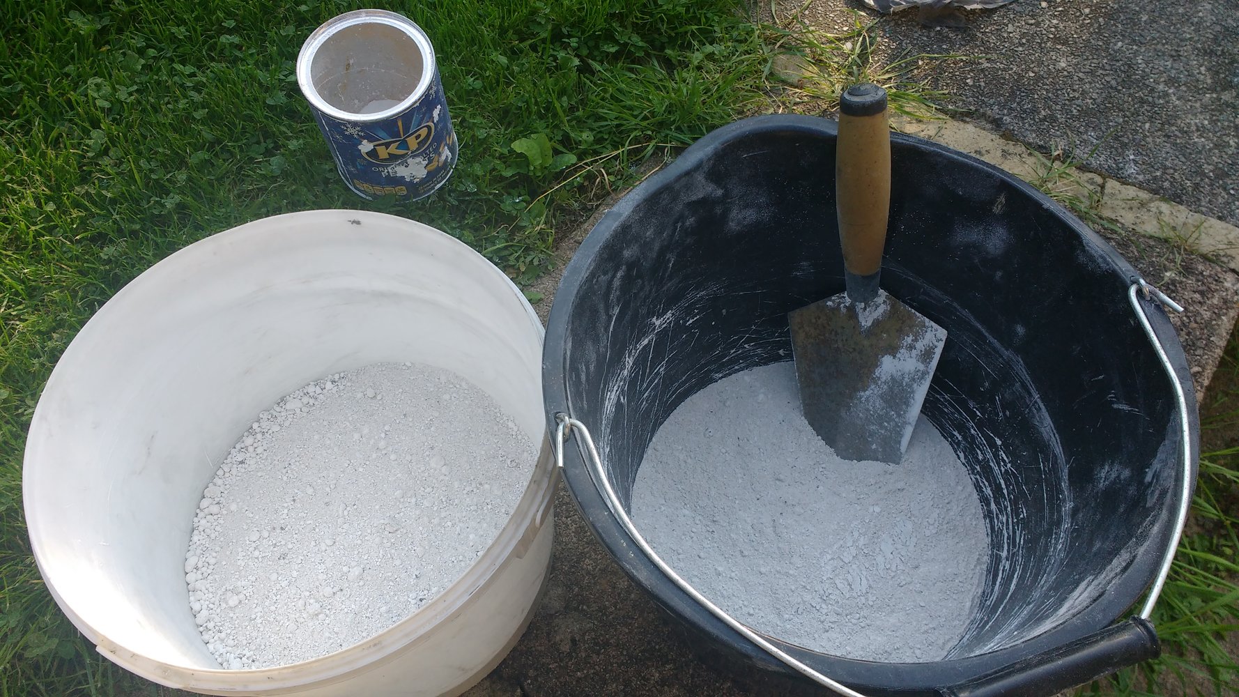

Check my first post on this:
'use a stiff mix using sharp grit sand around 2:1. For a yellower look add some builders sand'
Your mix is different, add yellow not substitute for grit, which might make it a bit fatty.
However it's all a bit suck it and see, no hard and fast rules, cos materials vary around the country.
Drying takes time, lime work is slow, one of the main reasons it went out of general use.
Apart from that carry on have fun!
