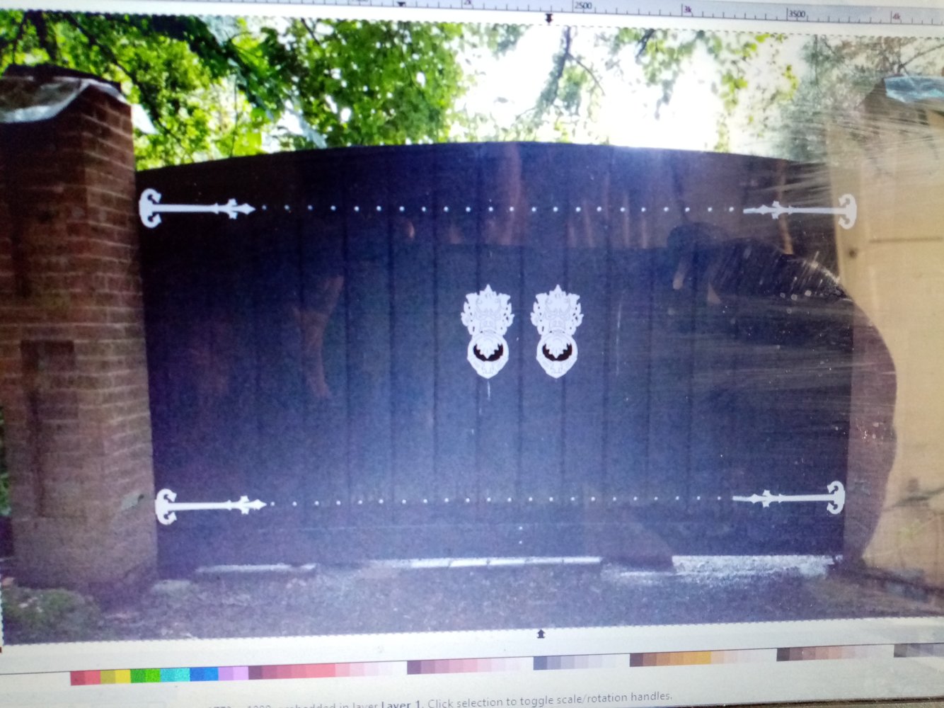

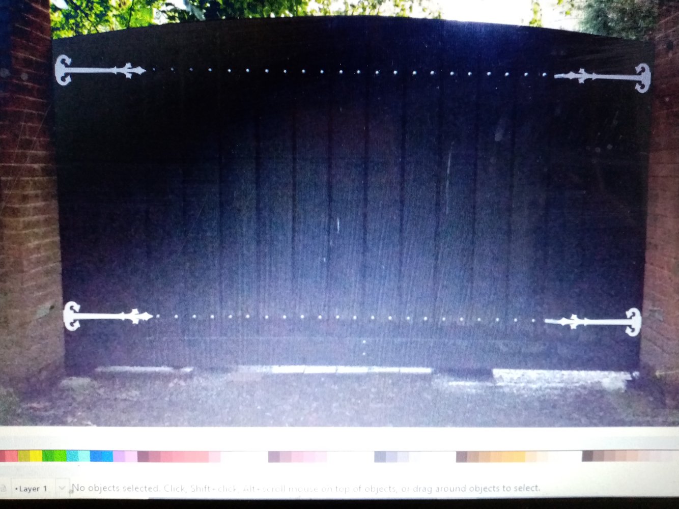

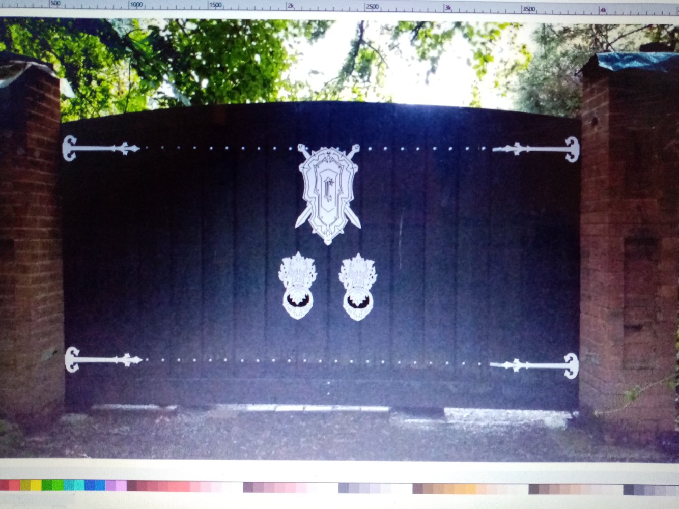

I got a price for hinges to the DXF @Aff kindly did that are nom. 350mm long.
£22ea, water jet in 6mm Gr304 stainless which I don't think is too bad.
However 350mm is aesthetically too short. I reckon they need to be about 500mm long. Wondering if I could go down to 3mm.
Just been and stuck some white tape on at 500mm long.
I'll probably have them cut blank as the coach bolt centres aren't exactly regular though they are on a straight line.
I might mock up the hinges in tin foil to get a better feel before I commit to having them cut.
There'll also likely be a vertical stainless strip of some sort dead centre and a mock lock/clasp/GoT shield etc in the middle eventually.
