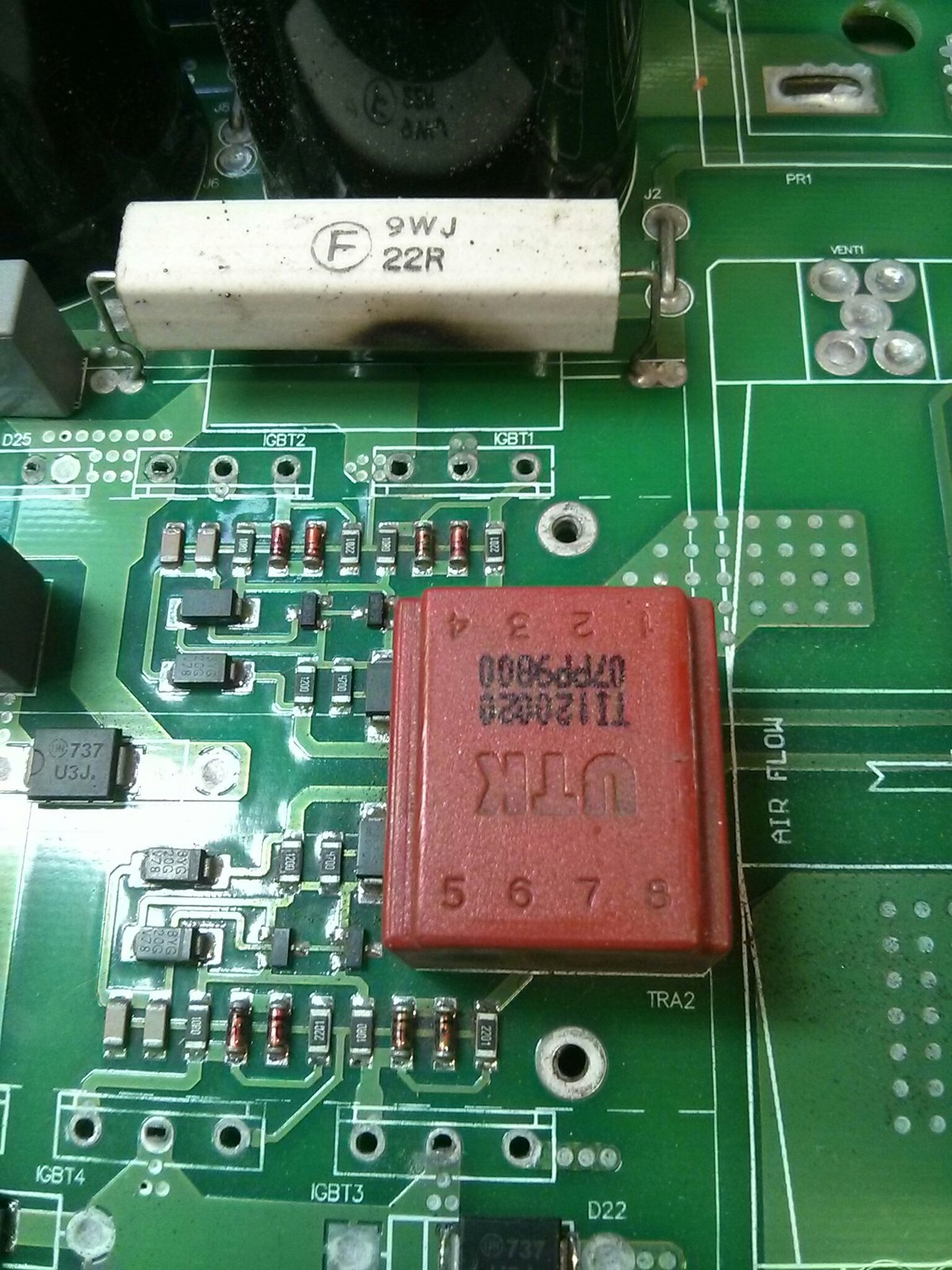

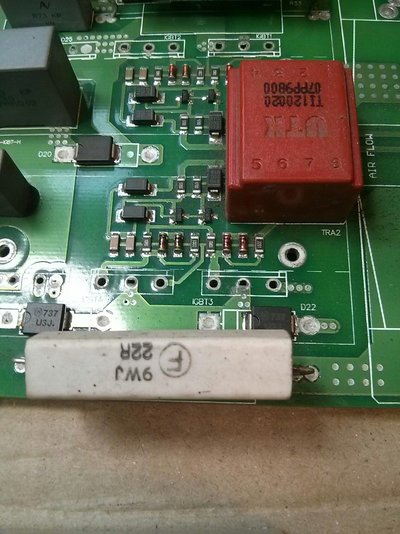

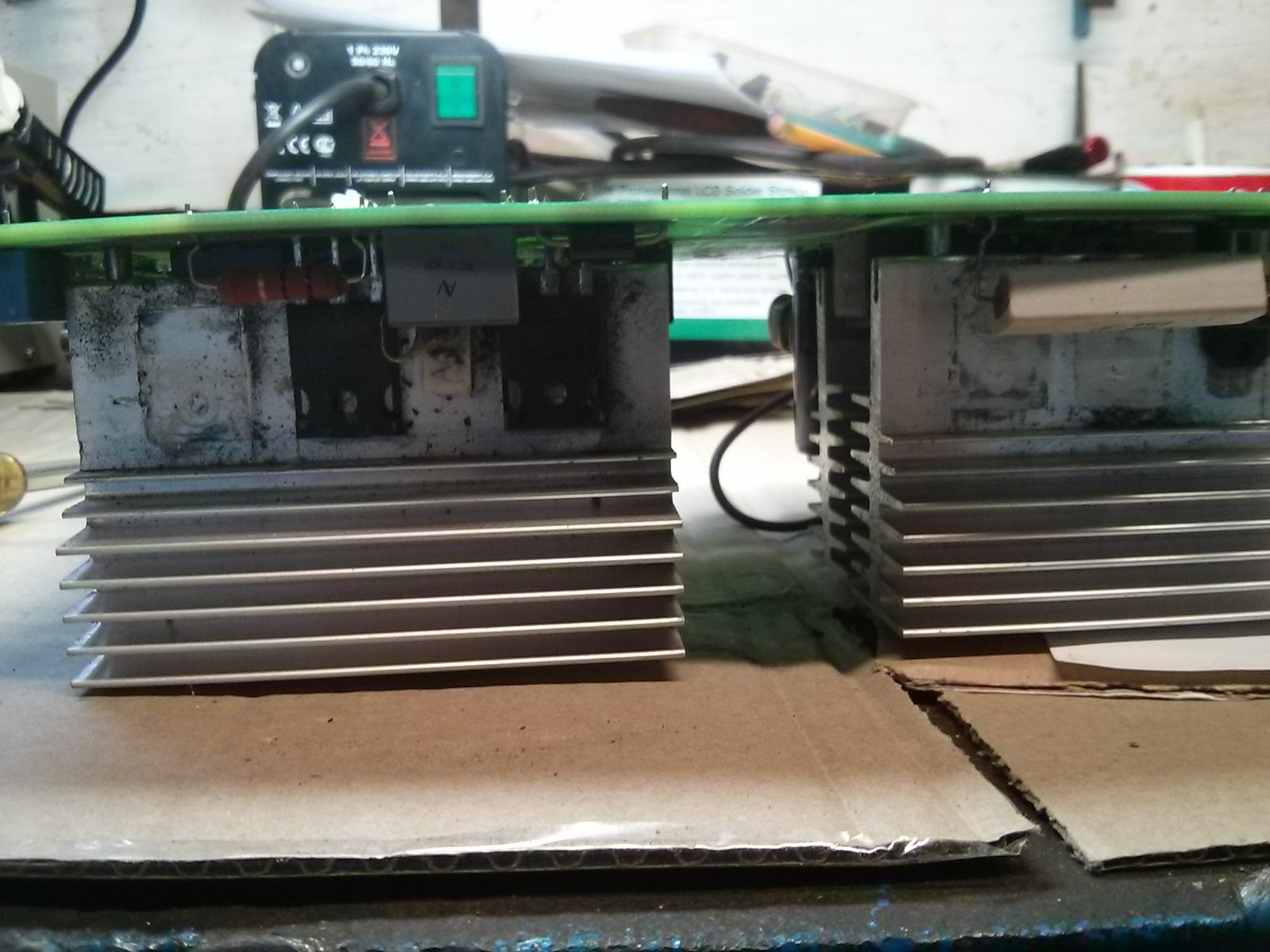

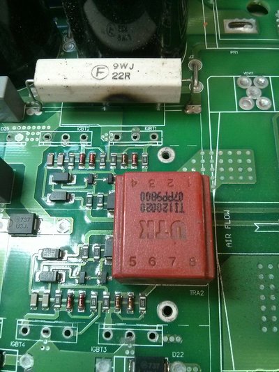

    Thanks Eddie. My vac pump thingy came yesterday so I managed to get bits removed. So far Ive removed 2 of the heat sinks with some IGBT's and rectifiers and diodes. I have 4 dead IGBT's (some are good to prove procedure luckily) and a dead diode. One of the IGBT's actually got vey hot and burnt the surface of the 22R. So if overheating caused by fan not working caused the components to fail would this cause the shorting which blows the resistor?. I will carry on removing all of the bigger stuff to check out of circuit now im this far and clean as I go. IMG_20200829_164307.jpg IMG_20200829_152712.jpg IMG_20200829_164313.jpg

    If the welder was running at high power levels without a fan, then yes, overheating could cause those components to fail short-circuit, although I would have expected there to be an overheat protection sensor on the heatsinks. Alternatively, maybe IGBT 1 failed short, and then caused the other three to fail.
    When powering-up with these shorts, the soft-start resistor is acting like a fuse in line with a short of the mains.

    Eddie, your reply arrived as I was typing the previous. Re overheat yes the heat sinks have what I suspected is a temp sensor too. 1 of the IGBT's was definately shorted while the others (so far) have been open or just not working. At each collection on the sinks there is also a rectifier (fesf type) and these are checking ok so far. There are also 2 smaller voltage regs (7812) for 12v, but what would be the likely input voltage for these? They are on the board rather than the sinks.
    The shorted IGBT has given me some hope now, thanks again :)
