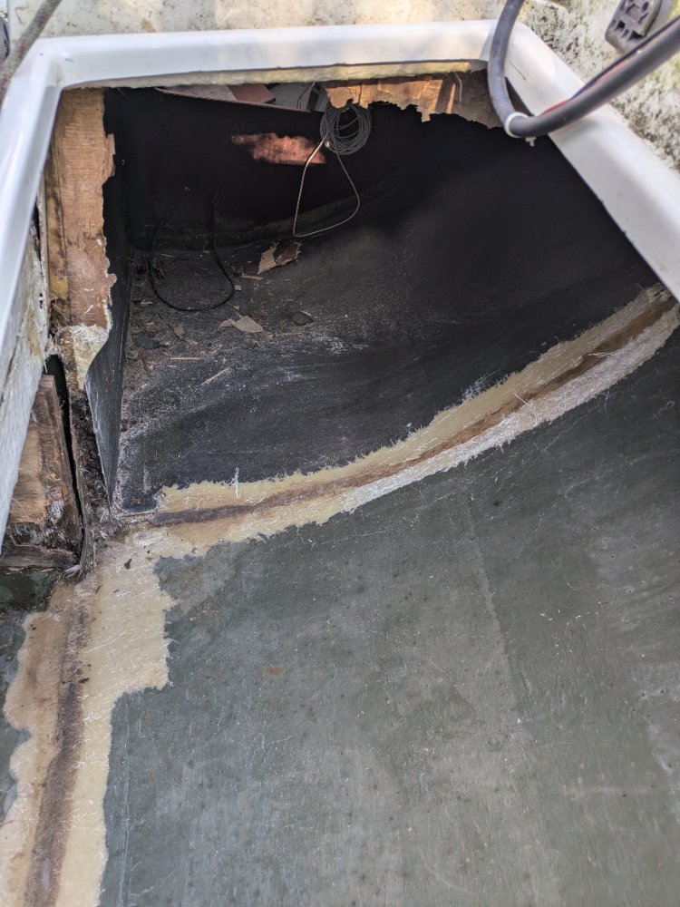

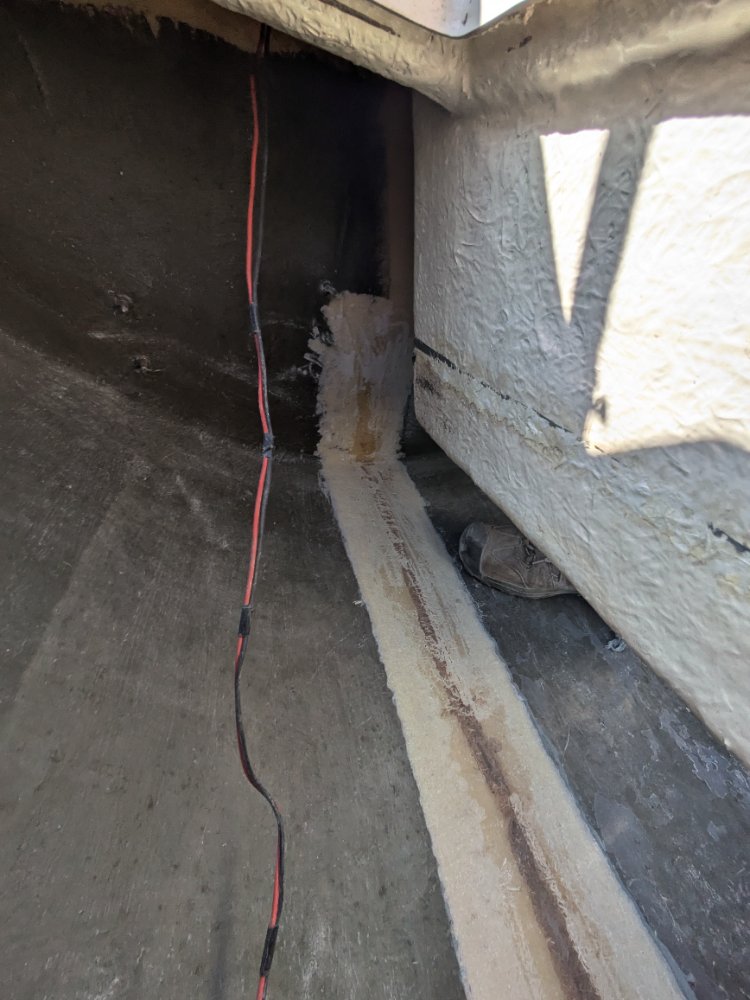

That was a big worry that I had...there are 2 props just behind the main bulkhead (in line horizontally with 6&7) so I suspect removing the stiffeners in this area would likely result in movement.If there's a lot of pressure on the stand, the hull can deform locally when you take the internal stiffener away.
Woke up this morning having second thoughts about the whole endeavour!
This boat has a fixed keel which makes recovery a bit of a faff...I need to decide if it's worth putting so much time into it.
