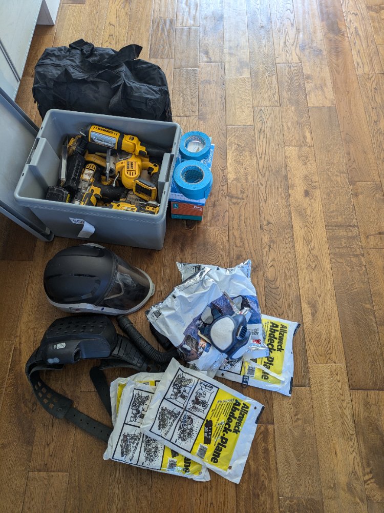

A big cheap office fan is the cheapest answer to that.Did some of this sort of work for Colvic craft when they were at Earls Colne airfield many moons ago.
100% with what Barking Mat says.
The one thing that is more important that all the other tools will be ventilation, you really need forced ventilation. when they were laying up the large moulds, they had massive fans blowing fresh air in all the time as the fumes from the resin sink and will sit in the keel. doesn't take a lot of fumes to make you quite ill.
