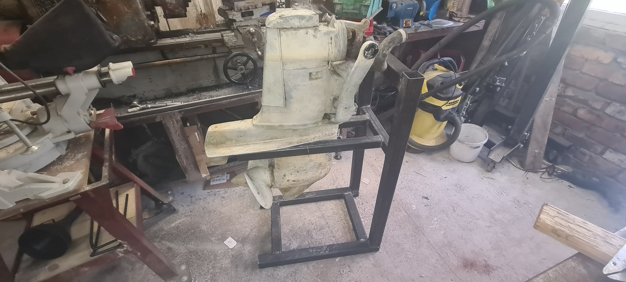

I checked over the drives, should of done this ages ago as thye would of been the decider on how the running goes.

Knocked up a drive stand to make life easier

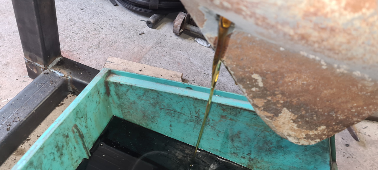

One drive had real black oil in it. prop shaft was clean and from any signs of stuff wrapped up.
the black oil in the tub is from the other drive, shows a big difference towards this one.
All feels good, UJ is good, no prop play. prop hub is fine and as said al changes gears well : Thats a good few £k saved i hope ha ha
gear change is good, one is a little slower than the other, the one that had black oil is quicker but then these drives are best tested with an engine stuck on and running. i havnt turned them a whole lot as i belive that can damage the clutch.

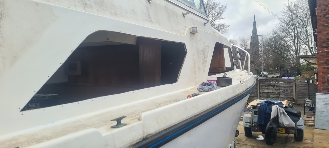

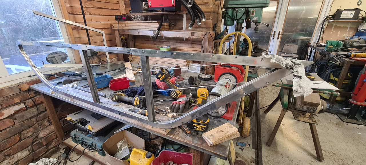

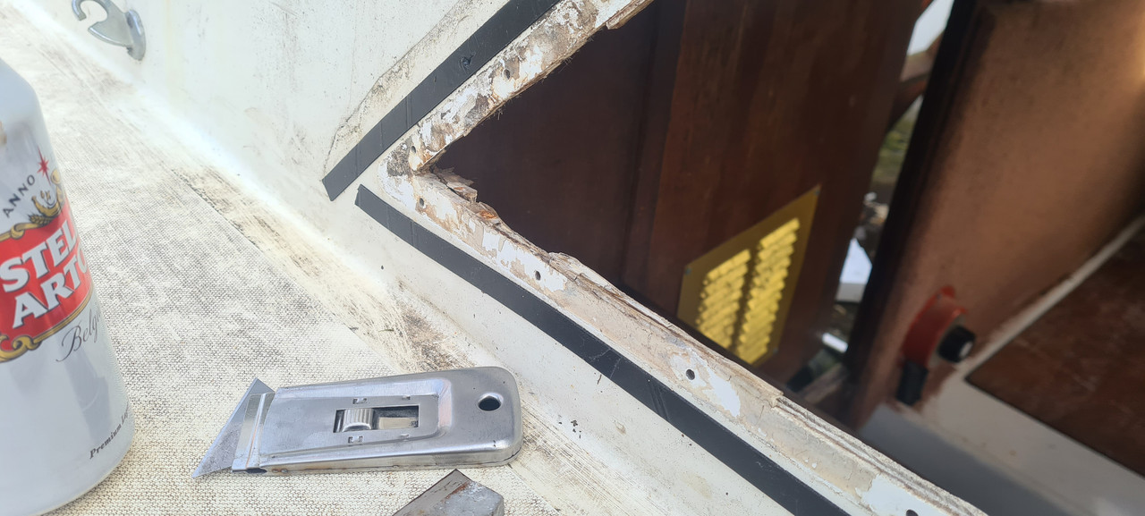

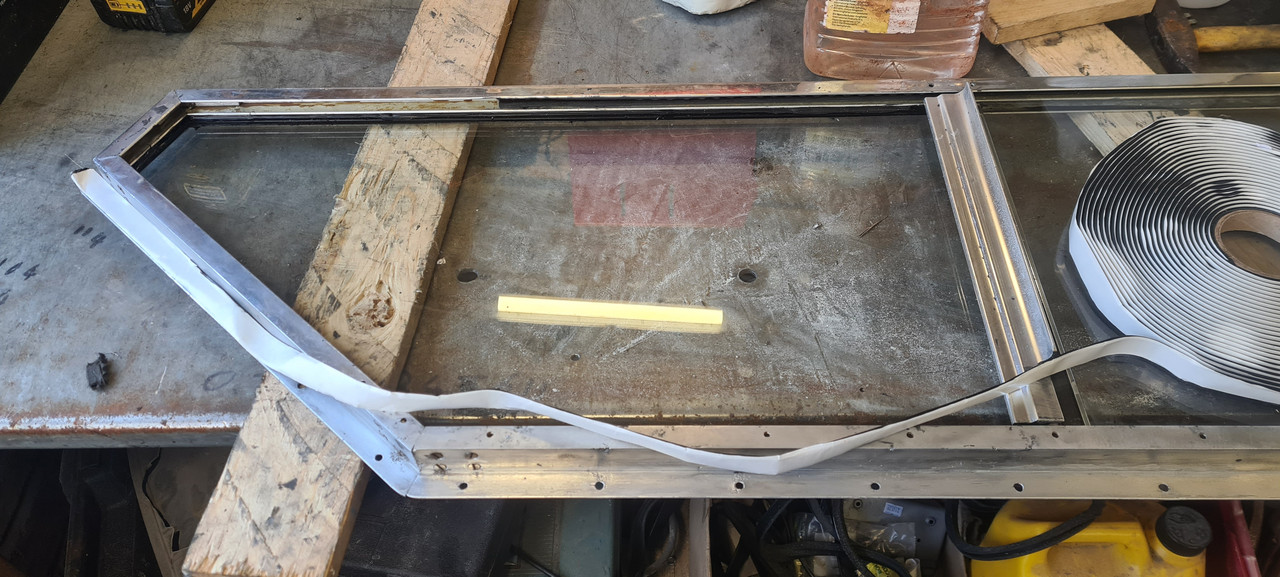

As there is little more i can do to them but for cleaning and refiling with oil i cracked on with the windows, no pun intended there lol.
Hate doing windows
I am thinking on using a different method to reseal these. i have cleaned them back, well two of the 12 if you include the flybridge windows. I usually use the rubber U channel and felt runner seals but this time i am thinking on just using either a High Modulus sealant adhesive or a Low Modulus one. OR Butyl that i use to fit the frames into the boat. Gun grade here though not strip.
I love the Puraflex 40 as its as good as the Sikaflex 291i and half the price and has been great over the years. I know it will be a pain in the **** to remove the glass from the frame in the future , but that should only have to happen if the window gets broken, in over 30 years i have never had a broken window on a boat. So maybe no reason not to use HM sealant. i say this as i have a load of Puraflex 40 here.
I have the Butyl aswell but i dont like the idea of that alone a st doesnt set very much. Then though its great for sealing in the frames to the boat.
Decisions decisions hey ha ha
OMH to think 10 windows to go AAARRRRrrrrrrrr

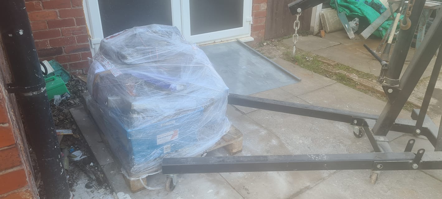

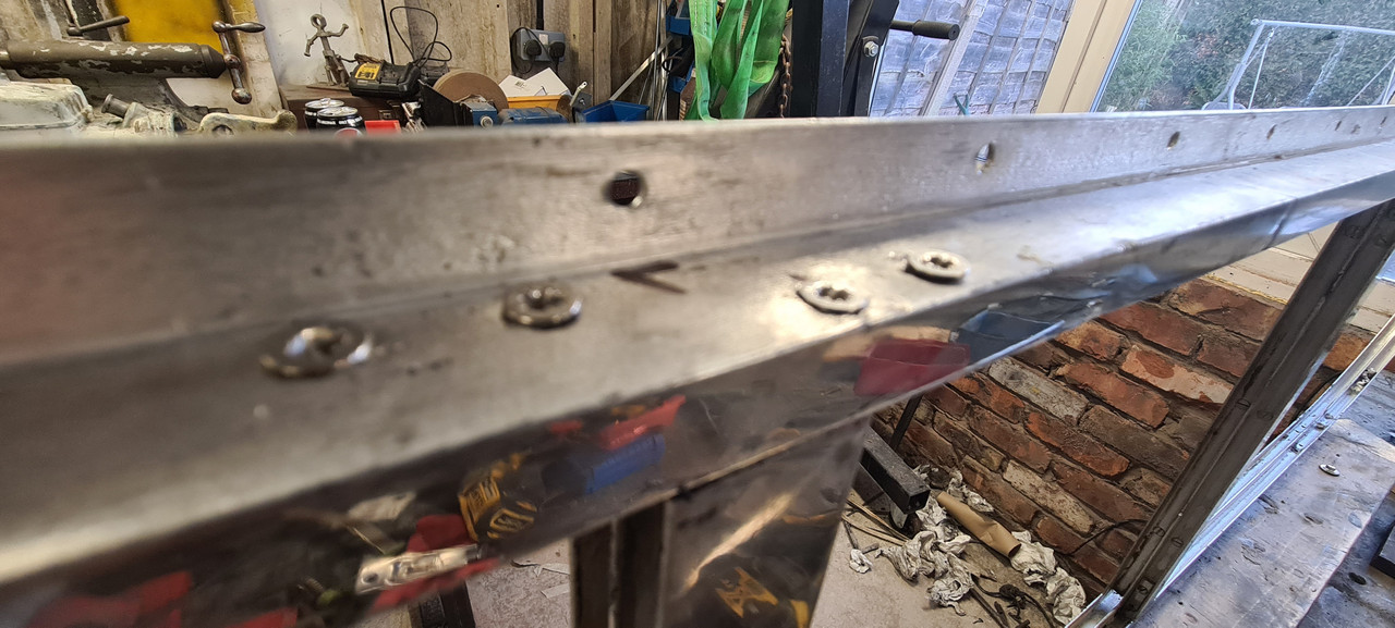

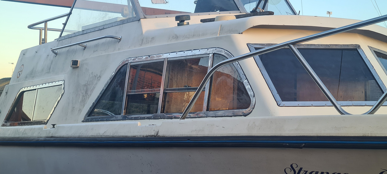

Hate doing windows
