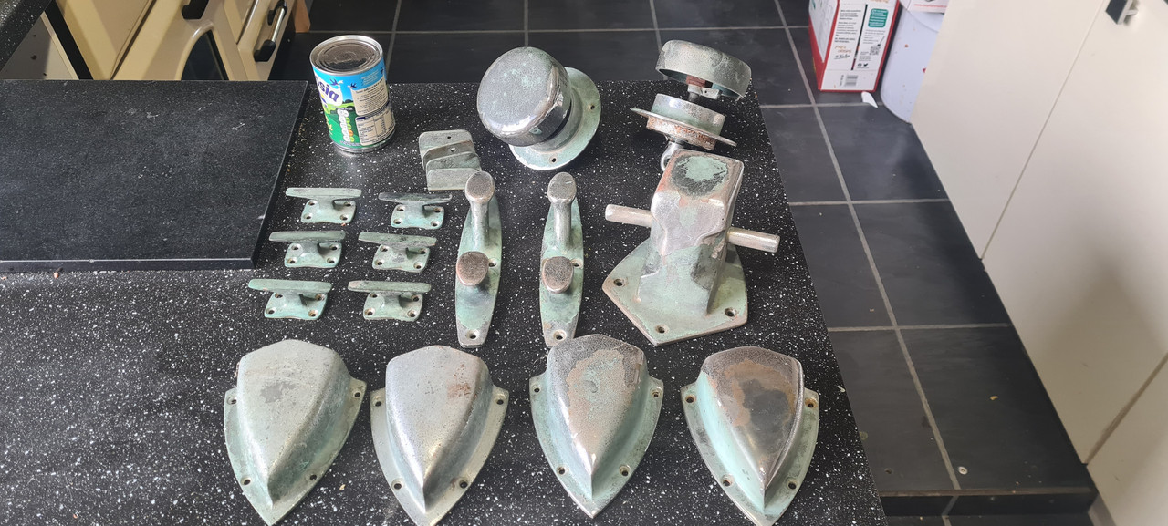

These little sods are what is few left of the deck fittings to be removed for rechroming.
These vents are fixed using machine screw tapped into the 8mm GRP superstructure and in well, well the very last screw will not but so ill be trying the set of damaged screw removers, never used them before so its time to see fi the work.
And to get them off is to cut out a section of the internal skin to get to the nuts. Not a bad thing as there under the gunnel and can be fixed back inplace.
