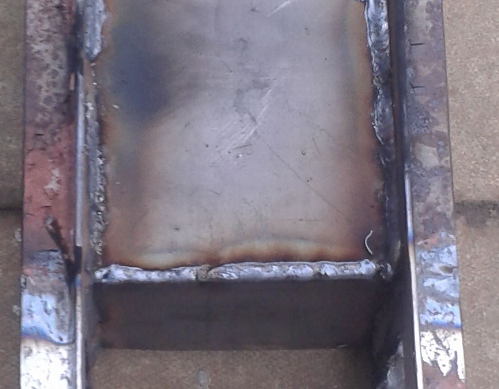

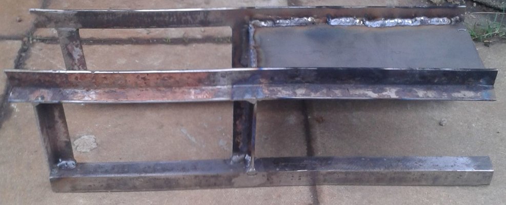

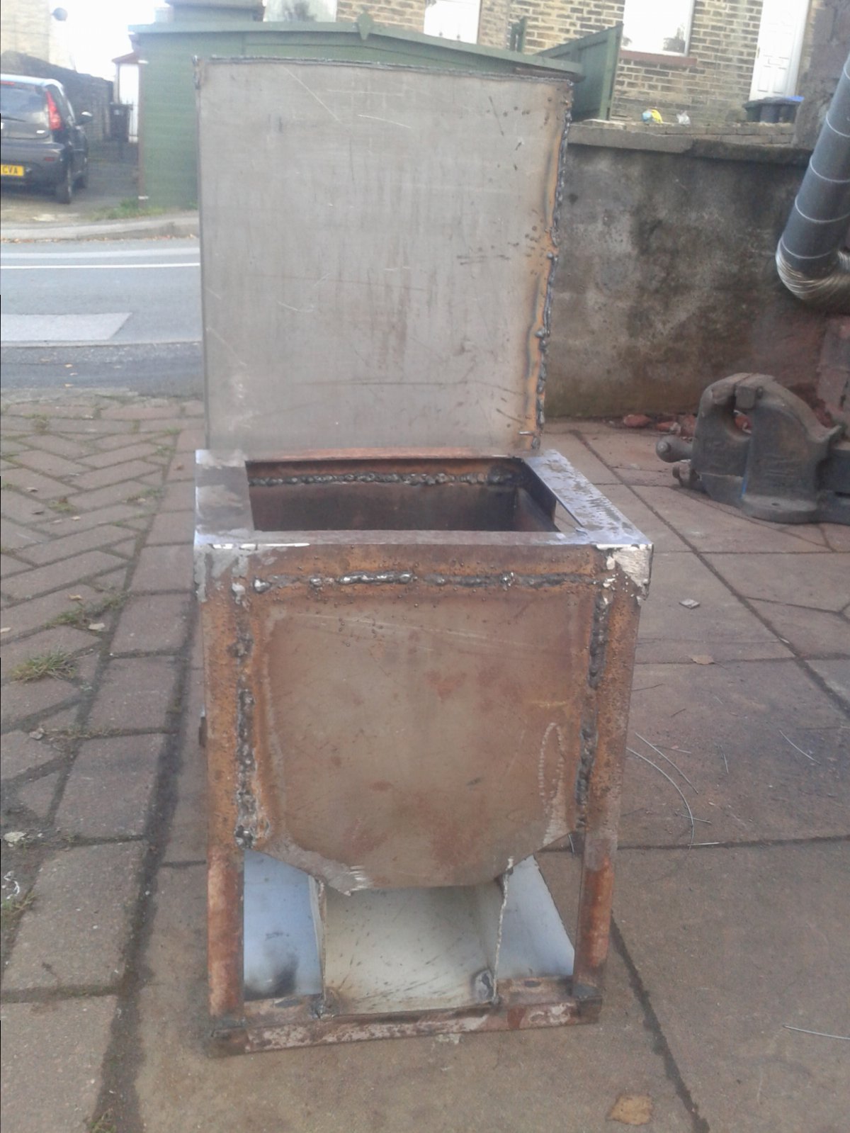

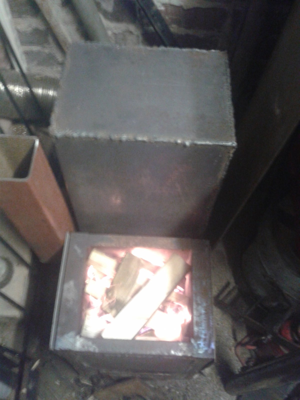

What is it?will post mine as still playing with them
1st one gasless 2nd one is arc the third and forth is gas mig welding i still hate gasless but will do it
View attachment 100319 View attachment 100320 View attachment 100321 View attachment 100322
i said i wouldny do any whipping on structural steel stuff. didnt say it was as strong at all... my dads a 6g coded welder been doing it 30+ years and he tells me not to do it but he also says you can do it all the way up until when its really needed. i understand welding ive always spoke about it to my dad. i understand your disturbig the weld pool jumping forward etc that creates inclusions. im not stupid. im just saying for ALOT of MIG work it doesnt even matter. and where it does matter you should be using the likes of stick anyways tbh for structuralSo you're saying we are wrong? The combined knowledge of Richard, who is a certified welding inspector and backpurge who is a professional welder (running his own business iirc). I've been in places where people have passed tests, whipping, im not saying you can'y , but testing and research done, has shown that 7 out of 10 times, that weld would have defects and inclusions.
You should buy yourself a book, "The science and practice of welding", you may reconsider your opinions. Or go and look on instagram for a fellow with the username mig_man. Karl is a time served mig welder working in probably one of the largest structural engineering firms in the uk with more certifications than you could shake a stick at. There are no whip & pause welds on his page I can assure you of that.

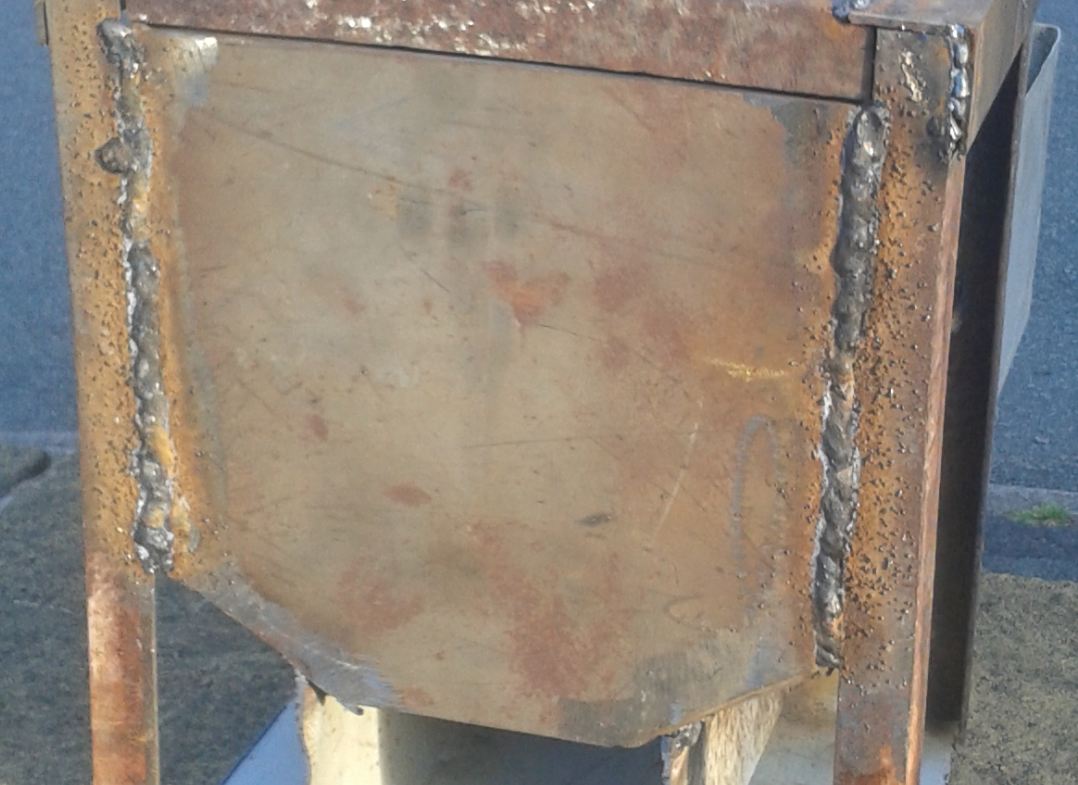

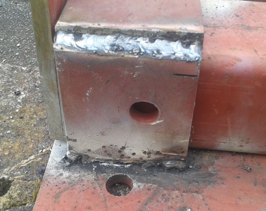

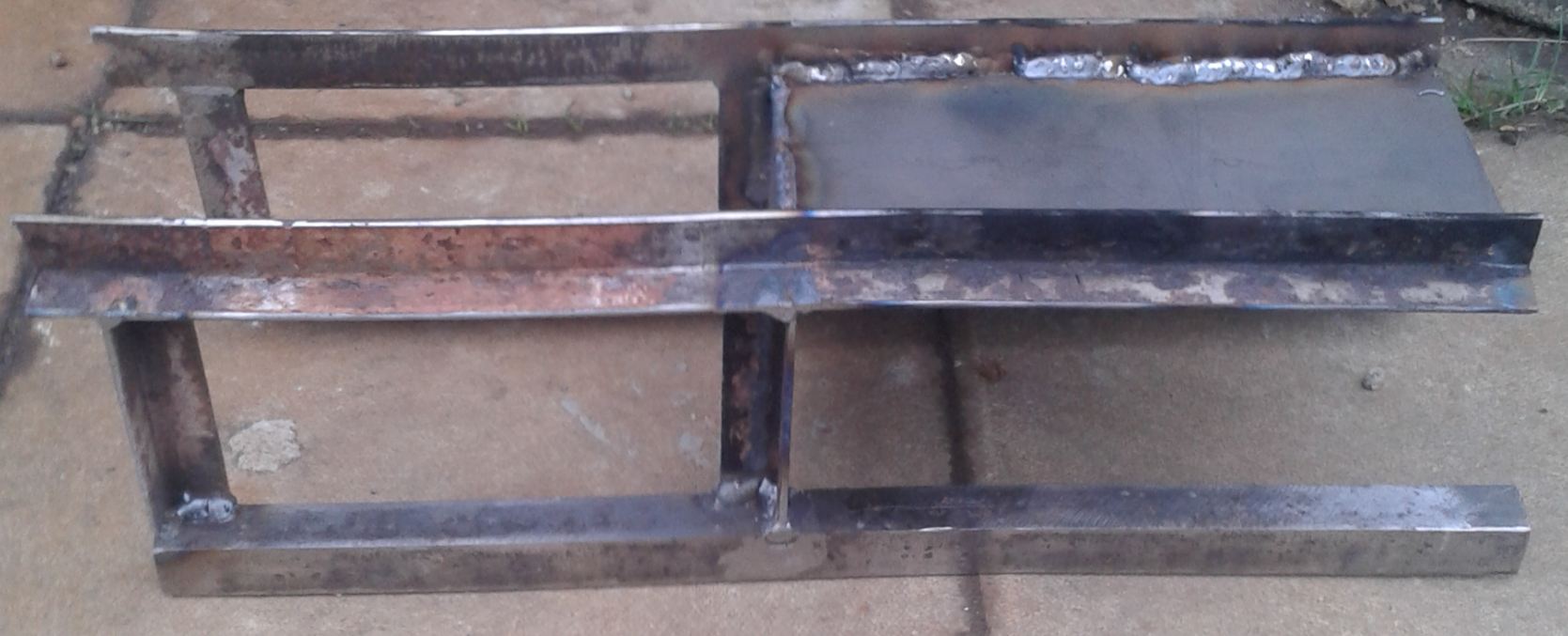

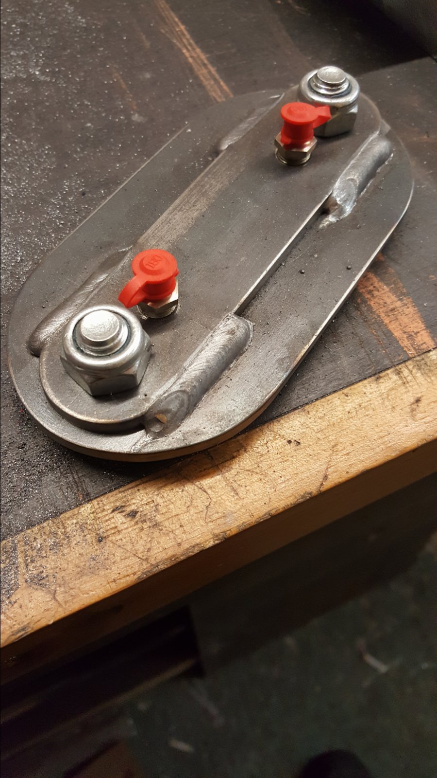

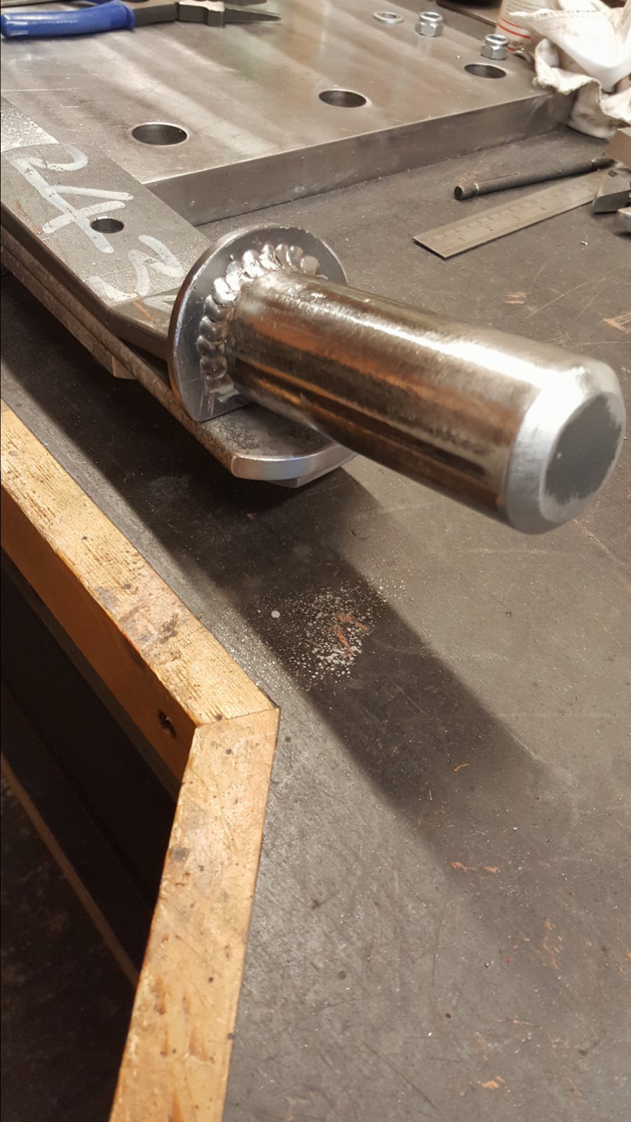

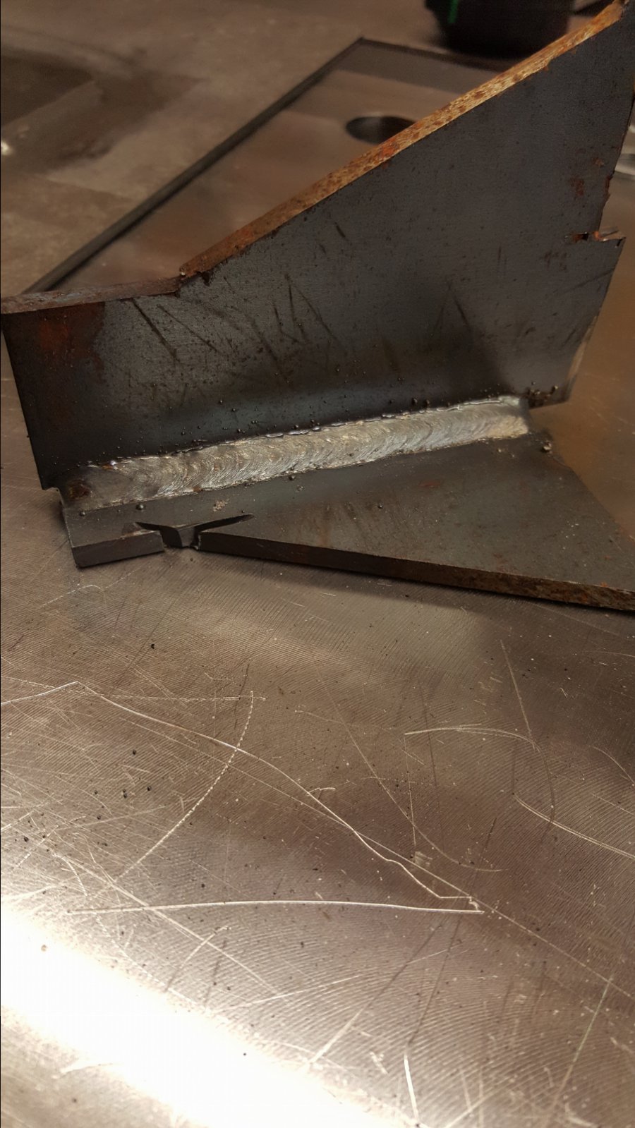

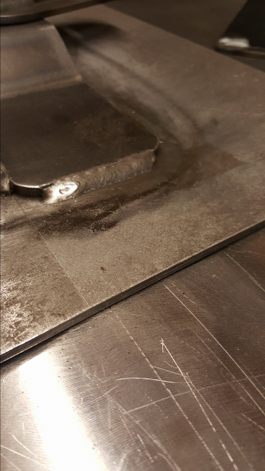

not bad at all bro. on the plate would of ran abit further to the end. and wudnt of jumped as much on the bar. thats about it. good work broHere are some of my welds. All be it am not happy with them.View attachment 100298 View attachment 100299 View attachment 100300 View attachment 100301 View attachment 100302
Yes I should of pushed all the way to the corners more.. and the handles I spot welded as I could not get a good weld to sit right.not bad at all bro. on the plate would of ran abit further to the end. and wudnt of jumped as much on the bar. thats about it. good work bro
yea i thought it was spotted can tell by the dots in the middle haha. just thought you may have jumped loads. its holding anywaysYes I should of pushed all the way to the corners more.. and the handles I spot welded as I could not get a good weld to sit right.
