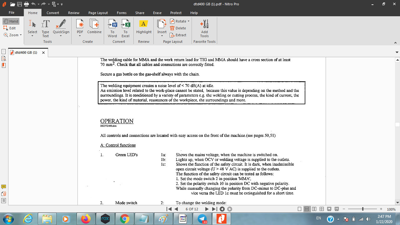

Thank you bobbes, I already noticed, but plz check the attached pic for 1b section, I don't have voltage on output, this is the problem.Hi Hossein, If the machine is running you don't need a testboard. Herewith the user manual. It gives you information about the LED's.

First you can try to make a connection with a small wire between J anf K on the remote control connector. That must have the same results as the torch switch.
