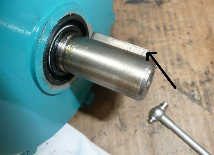

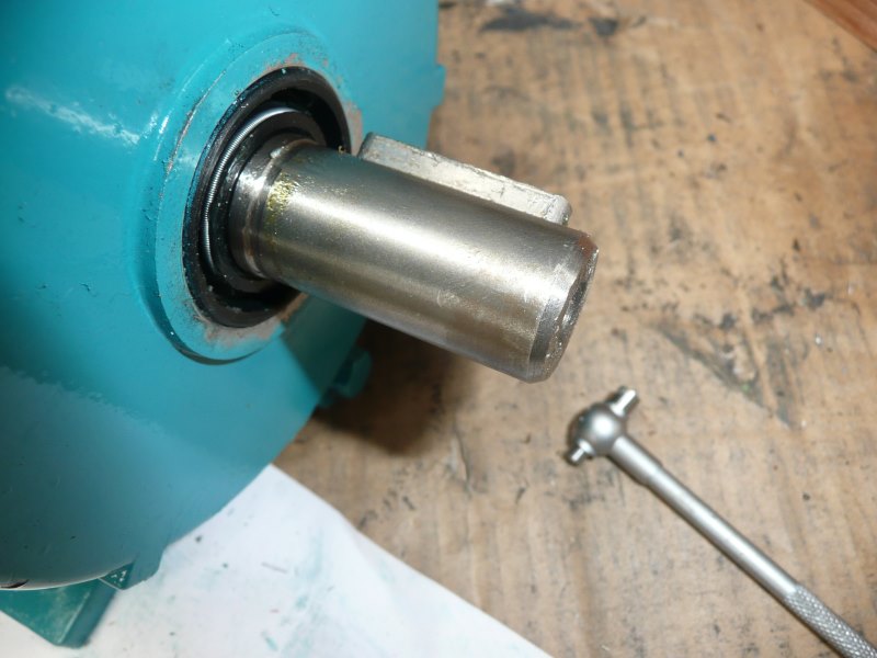

You may be right there, never thought of that, I was just about to stick it on the motor but it has one of those captive keys and they can be PITA to get out.
Chisel or screwdriver on front edge and a sharp upward chap with a hammer will knock the key out easily.
Doh! More haste, less speed.
