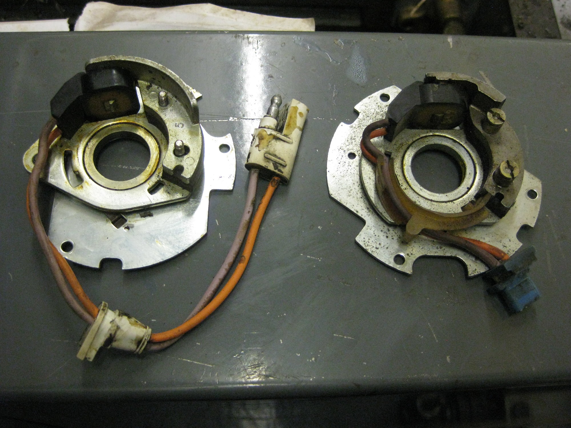

Both the DM8 and the DLM8 distributor setups are electronically identical. The DM8 uses a GM HEI module. The DLM8 uses the same electronics in a Lucas made module that hangs on the side of the dizzy. DM8 stator and pickup on the left; DLM8 setup on the right. The only difference is the amplifier connector. This GM HEI type setup is fitted to huge numbers of 4, 6 and 8 cylinder non-GM 80s & 90s cars, only disappearing when conventional distributors were replaced by crank triggering and coil packs.
I've seen a couple of RV8s (including my own) that had a strange 'rev limit' effect going on - seemed to pull hard enough but would hit about 5000rpm and just stop, then pick up when the revs fell. Turned out to be that pickup coil breaking down. On mine it eventually failed open-circuit and the car just wouldn't start.
For info, the coil should measure about 3000 Ohms or less; if it's substantially higher than that then it has to be suspect.
