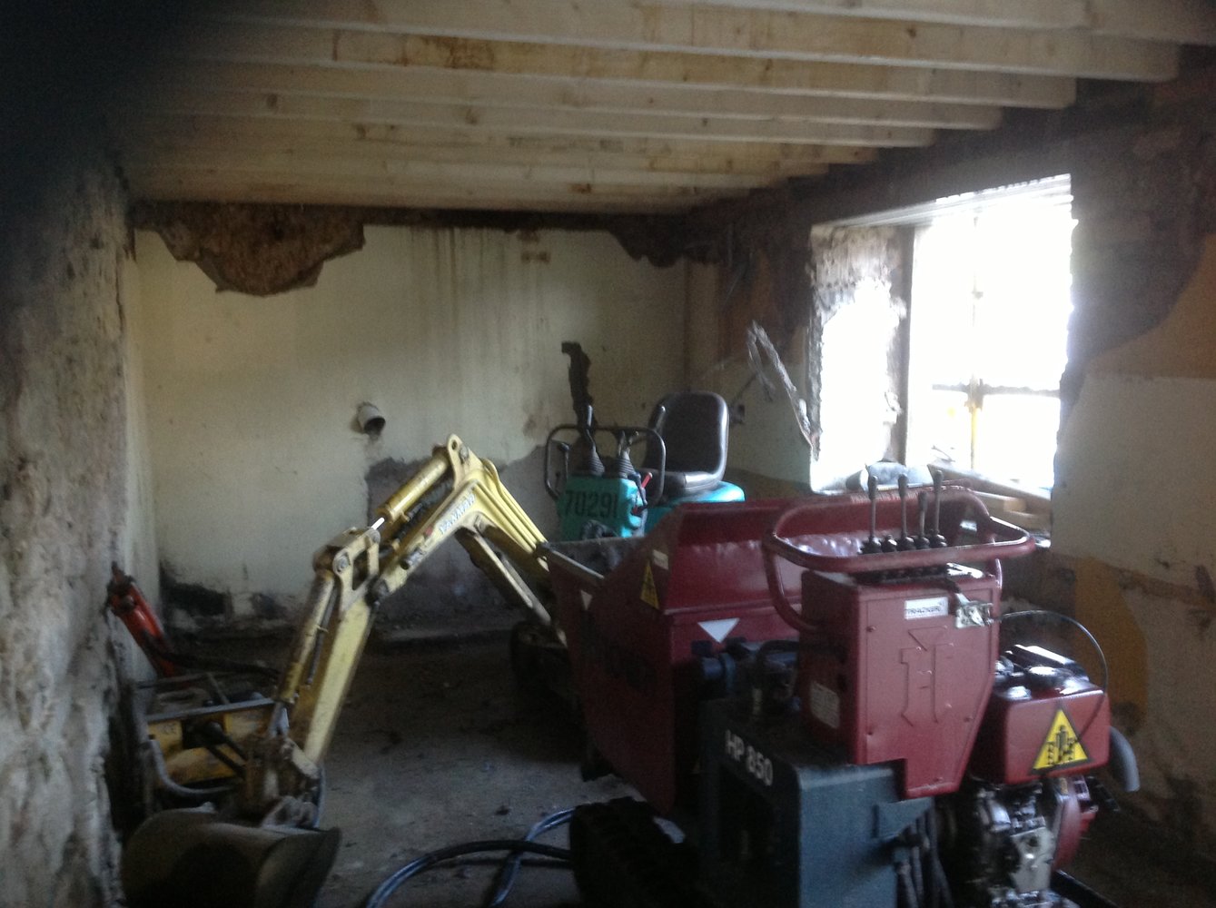

Our kitchen, had a pecker for the digger too.I'm struggling to get anyone here to pump it. Company in Cupar who have pump, been chasing him for a quote with no luck yet. I'm hoping they will do it as they also do anhydrate screed.
Were living in the house and doing it a bit at a time. Most of ours is suspended timber. Its a lot of work, wouldn't fancy howking out concrete floors unless could get some machinery in to help.
