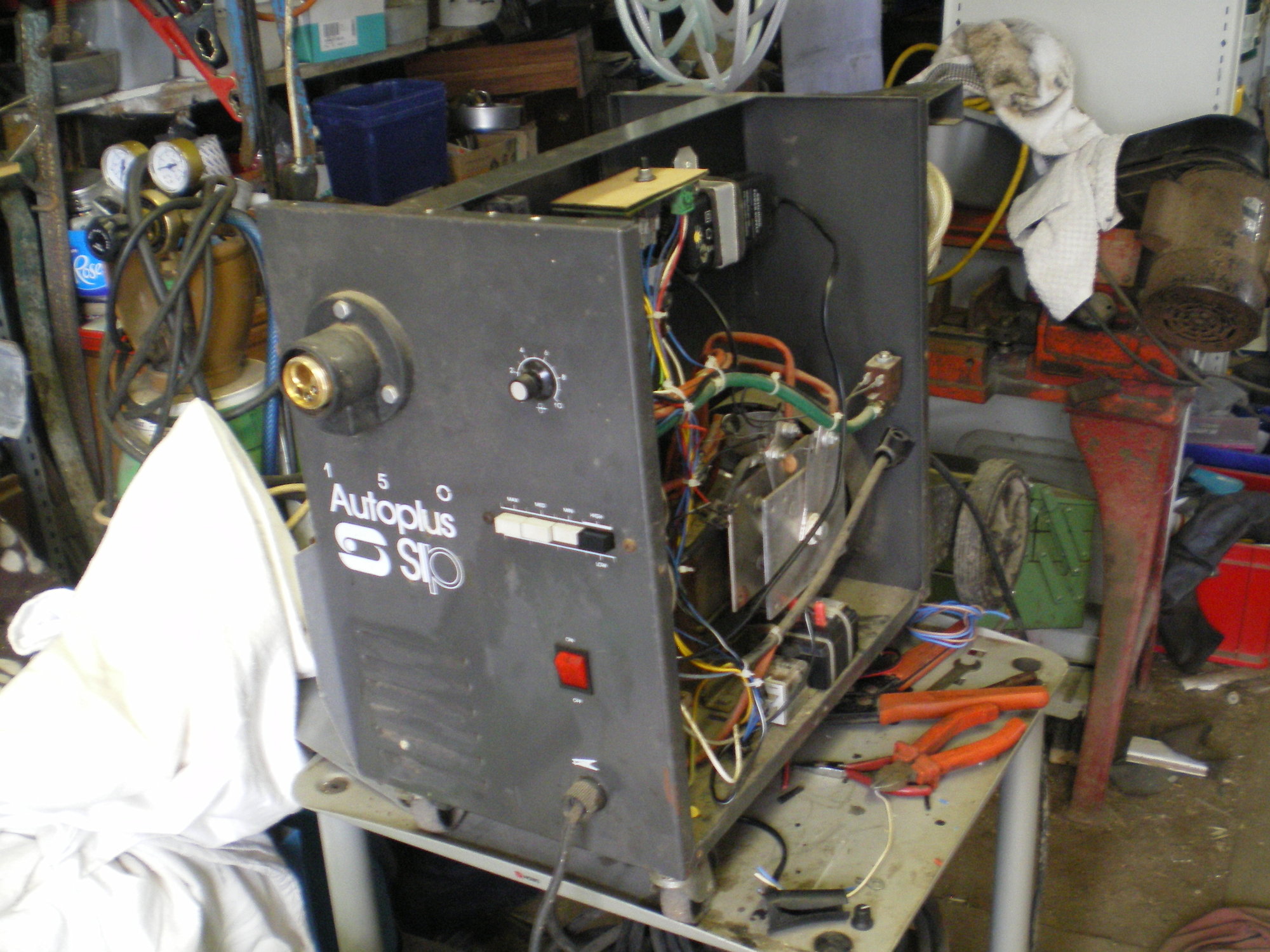

Thank you for that charliecambs. I admit I think I've well overstressed about this speed controler. I know most on here who've done the various Sip wirefeed mods have had a 2 to 4amp supply and have had no problems so either it's perfectly fine or they have been lucky- and I doubt everyone has just been lucky. That includes me as I did a Topmig a couple of years ago and used a 3.5amp HP laptop switchmode block supplying the standard board which worked fine for the few months I had it.
My worry was that on this occasion I'm using a PWM controler instead of simply supplying the power to the original Sip board which uses a transistor with a 100volt and 25amp rating. Way overspec'd for the job but therefore probably pretty safe driving an inductive motor load sometimes under non-ideal conditions. I have no idea how rugged the output components of the 'Chinese' PWM board are so thought it best to make sure they were well up to the job and well protected. I'm an old worryguts.
