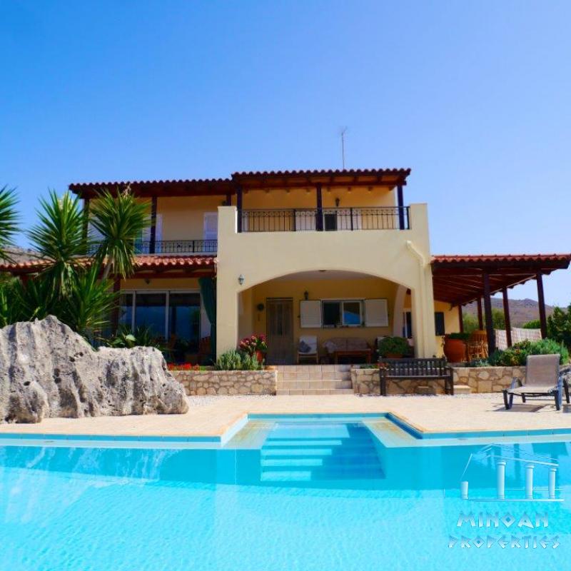

What is the 5 gal airless sprayer? can you send me a pic. The paint sprayers that I am talking about, full airless don't have a pot, they draw pint straight from the paint can via a spear, compress it (up to 3300psi), (bigger industrial ones go to 7250psi) and push it up a high pressure paint hose of generally 15meters. The 'cheapos' well over time, unfortunately are not so good, the Graco's, Wagner's / Titan's, even Seiwa's are all good, that is what we have here. There are others, certainly however the ones I mentioned do give the best performance. The problem with cheapo's is that they will stop when you least need them to, the big name brands also stop, mainly due to poor maintenance.part of my house is 3 stories......
I'm pretty able but at 74 using a lambs wool roller up a ladder is getting too much/heavy......and she doesn't want me up a ladder for days.....
had quotes from locals and lets just say it aint the Fourth Bridge......lab only costings start at €2500.....ps, I can do the job in 5 days on my own but a bit fxxxed after..hahaha...
even using the best paint I still have to paint most of it again each spring to make the property smart for the tourists....
there are a 3 tall almost blank walls u cant see in the photo.....what u do see is easy by roller .....

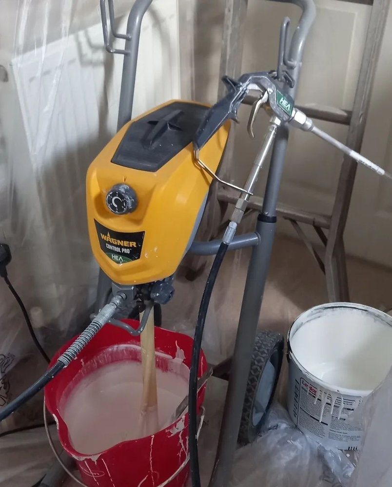

Wagner for me too , pain to mask up but easy once sorted
