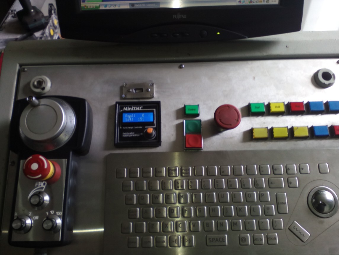

Yes I am using Mach.I was starting the arc ok but then it dropped and carried on with the job without a flame. I was Not using the THC. Are you using Mach 3 ?
Sounds like the pilot arc was started but when your dropped and moved the actual arc was not initiated. Do you not have an Arc OK signal back to Mach? That signal stops the motion if there is no signal. What THC do you have?
