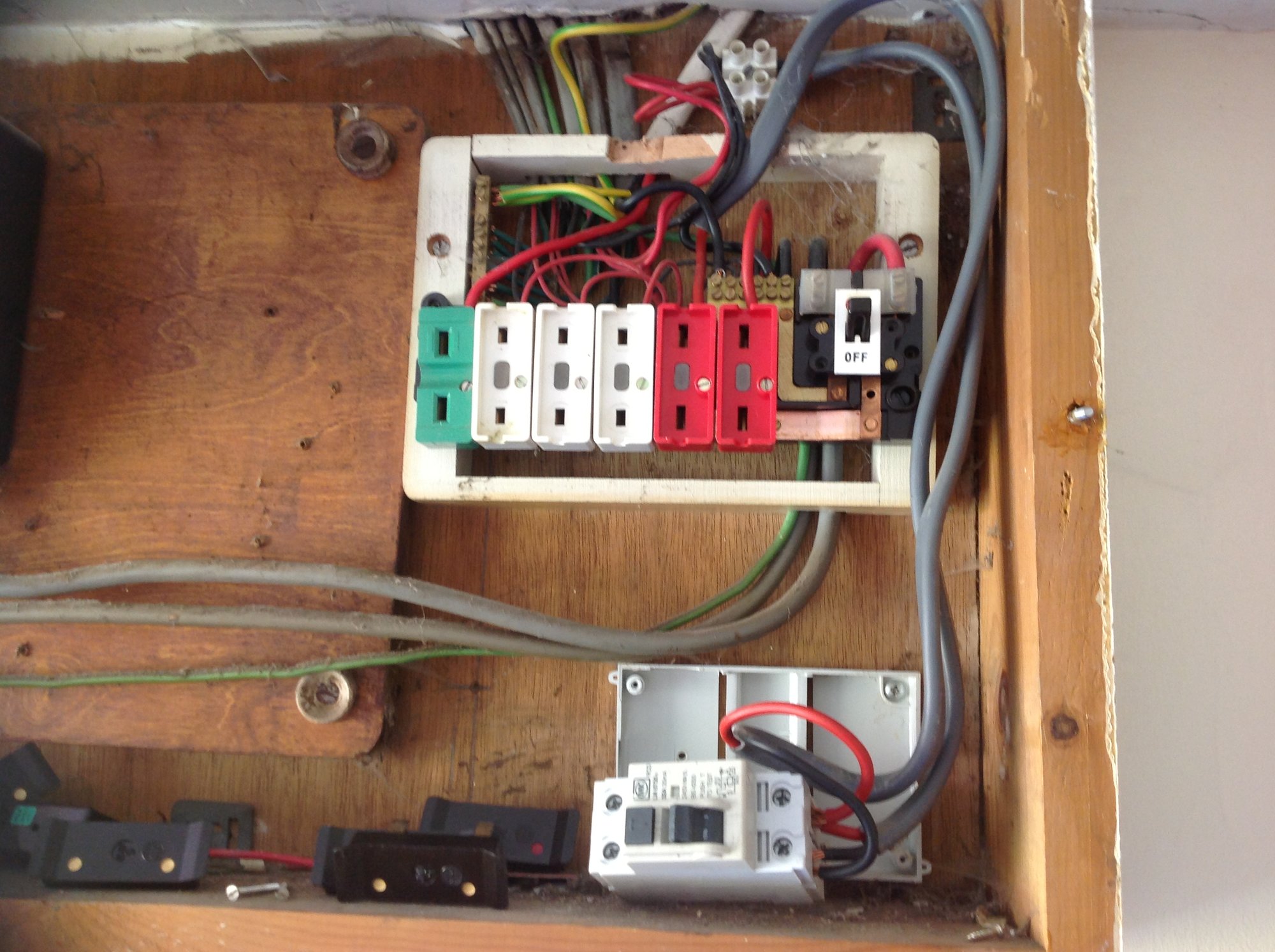

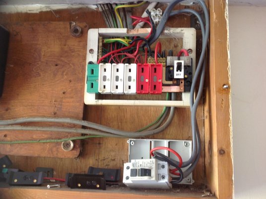

Its amazing we all survived with these, as found in my house when I bought it. Spot the deliberate mistake.
