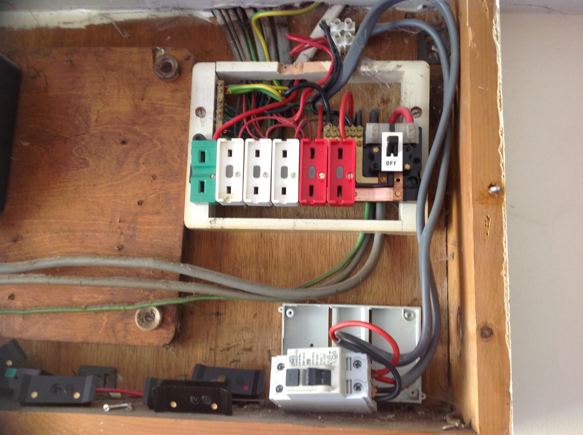

yea someones added an rcd on to a circuit and it was probably tripping so they coupled the wires together to bypass it and extended the output cable to it with block conectors outside the dbIts amazing we all survived with these, as found in my house when I bought it. Spot the deliberate mistake.
