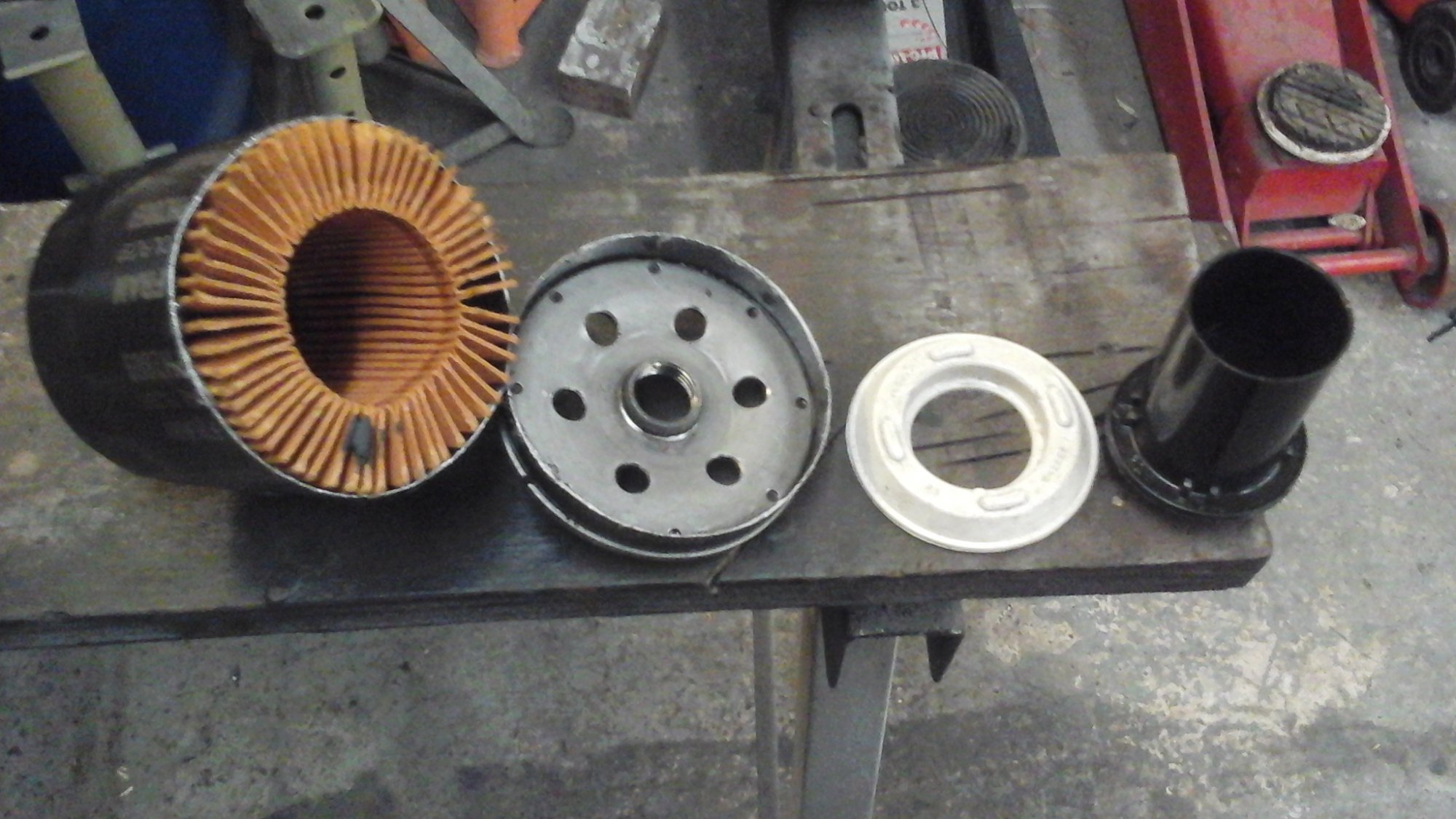

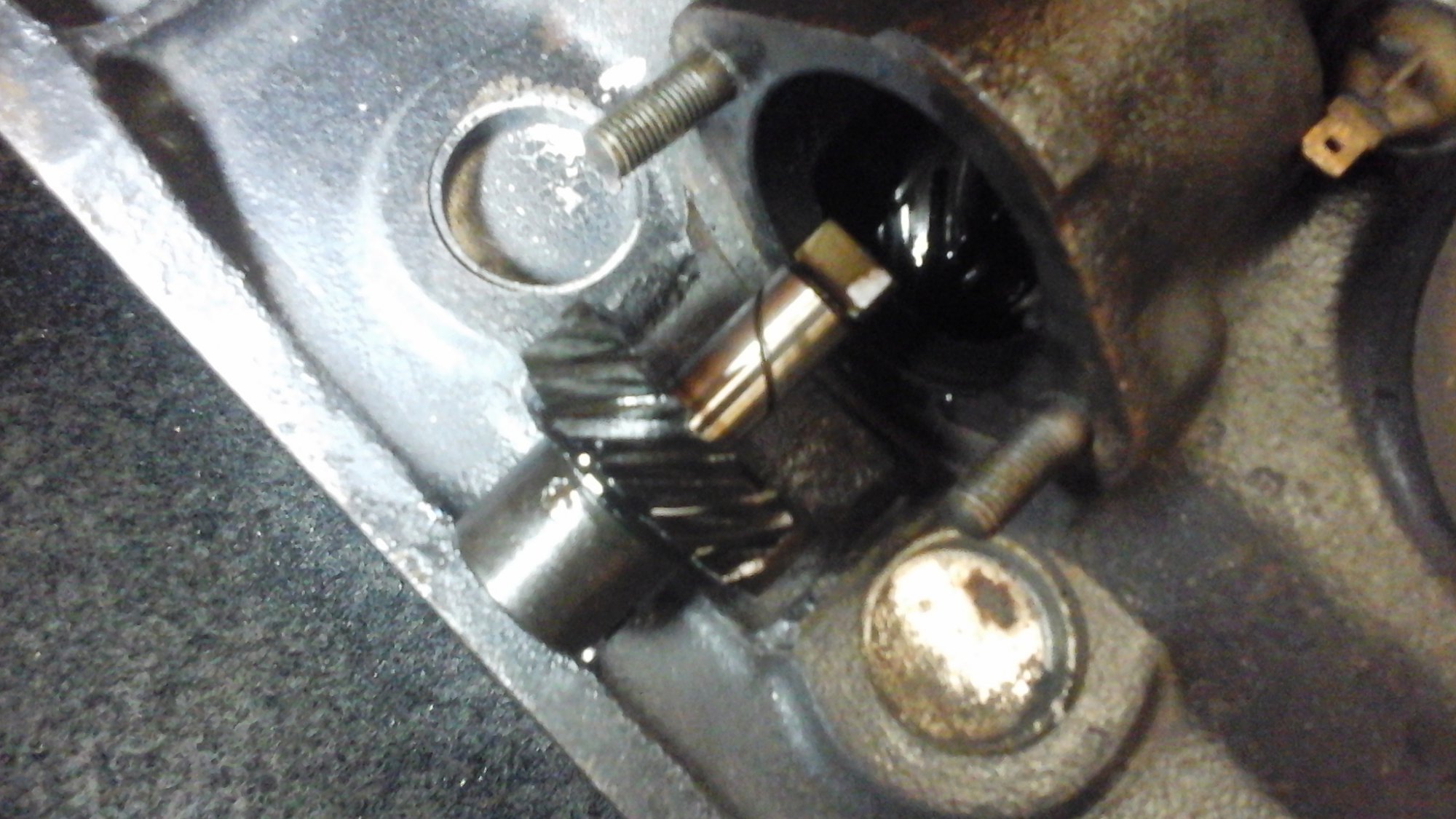

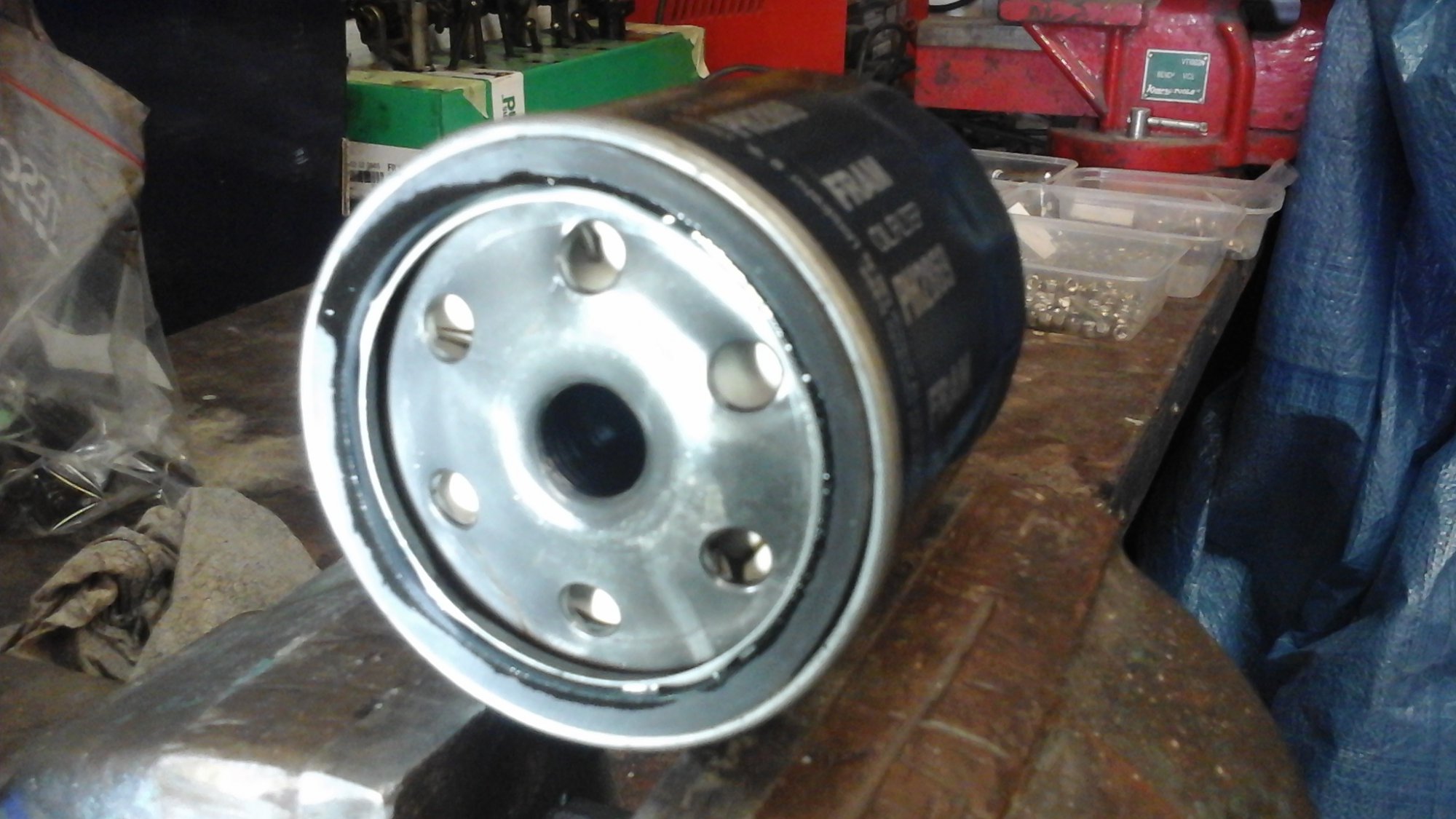

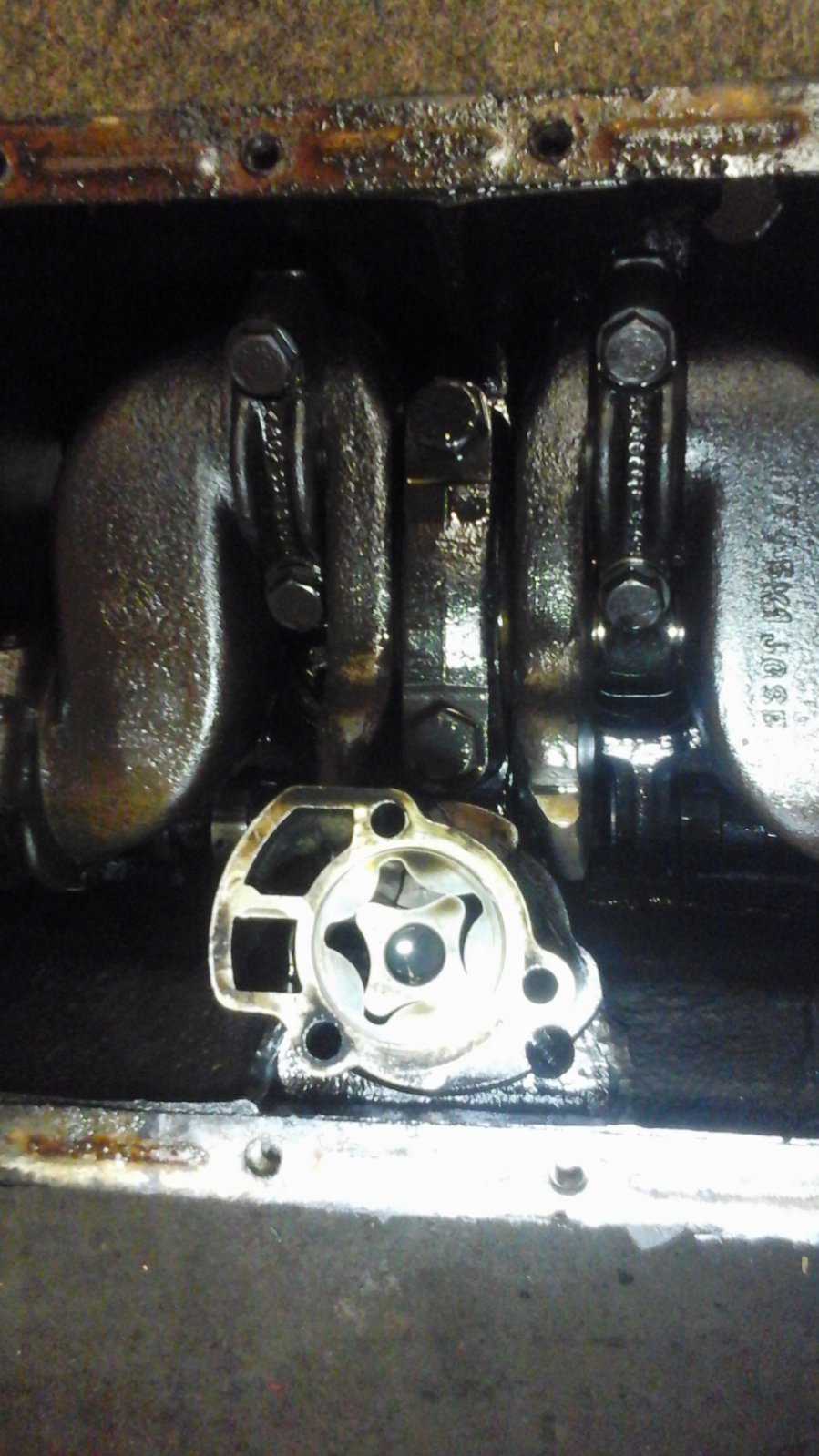

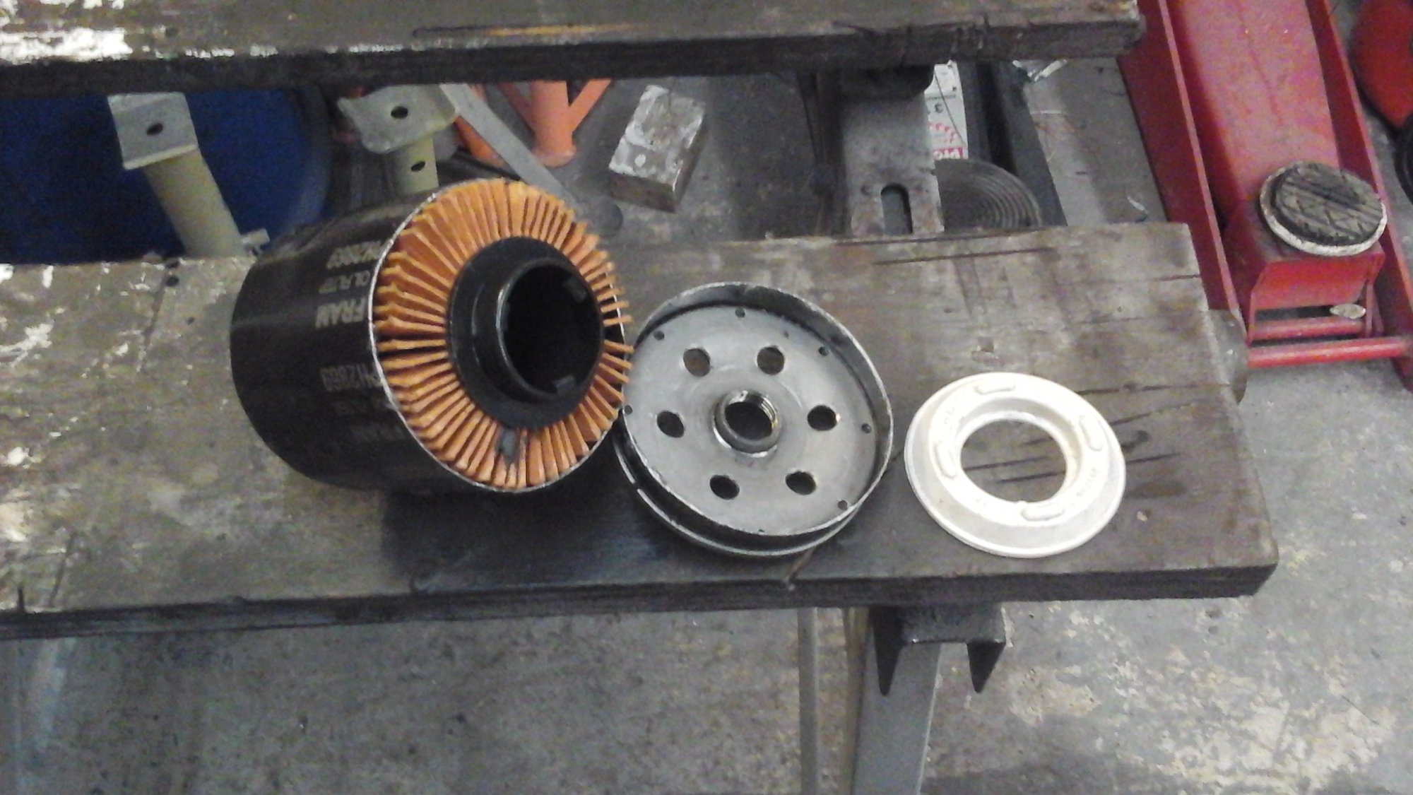

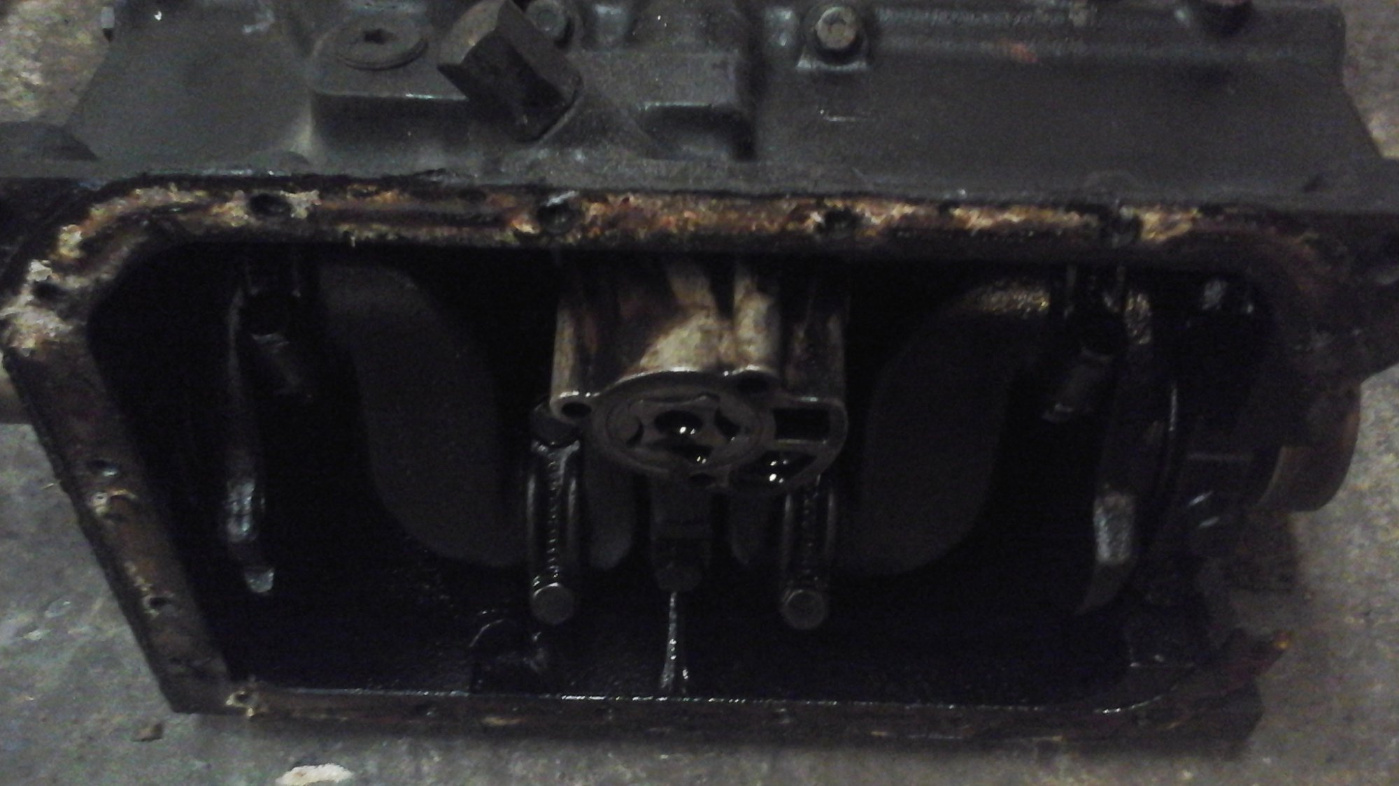

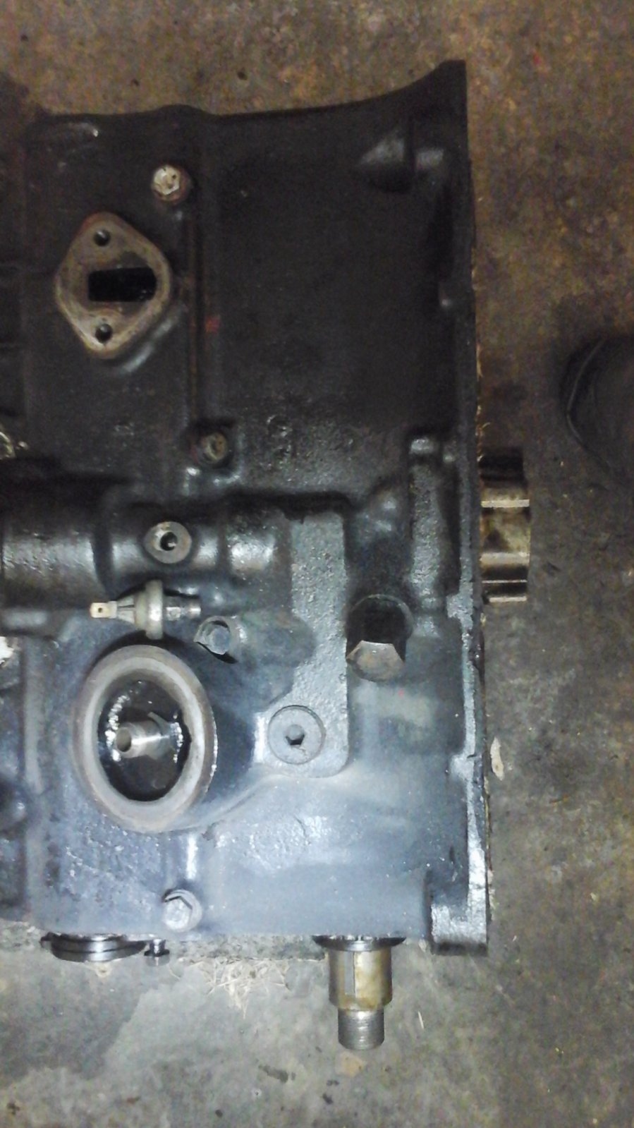

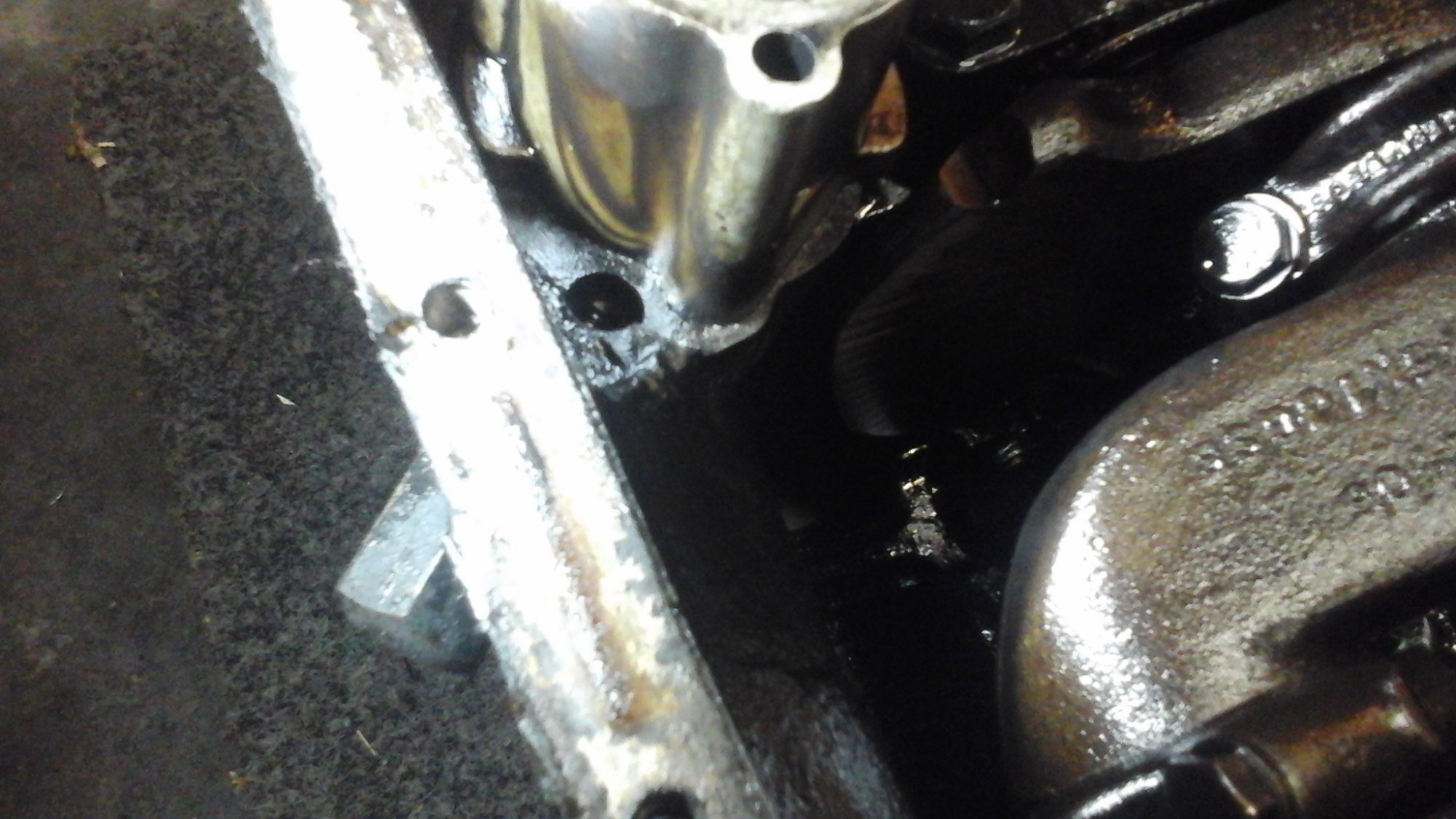

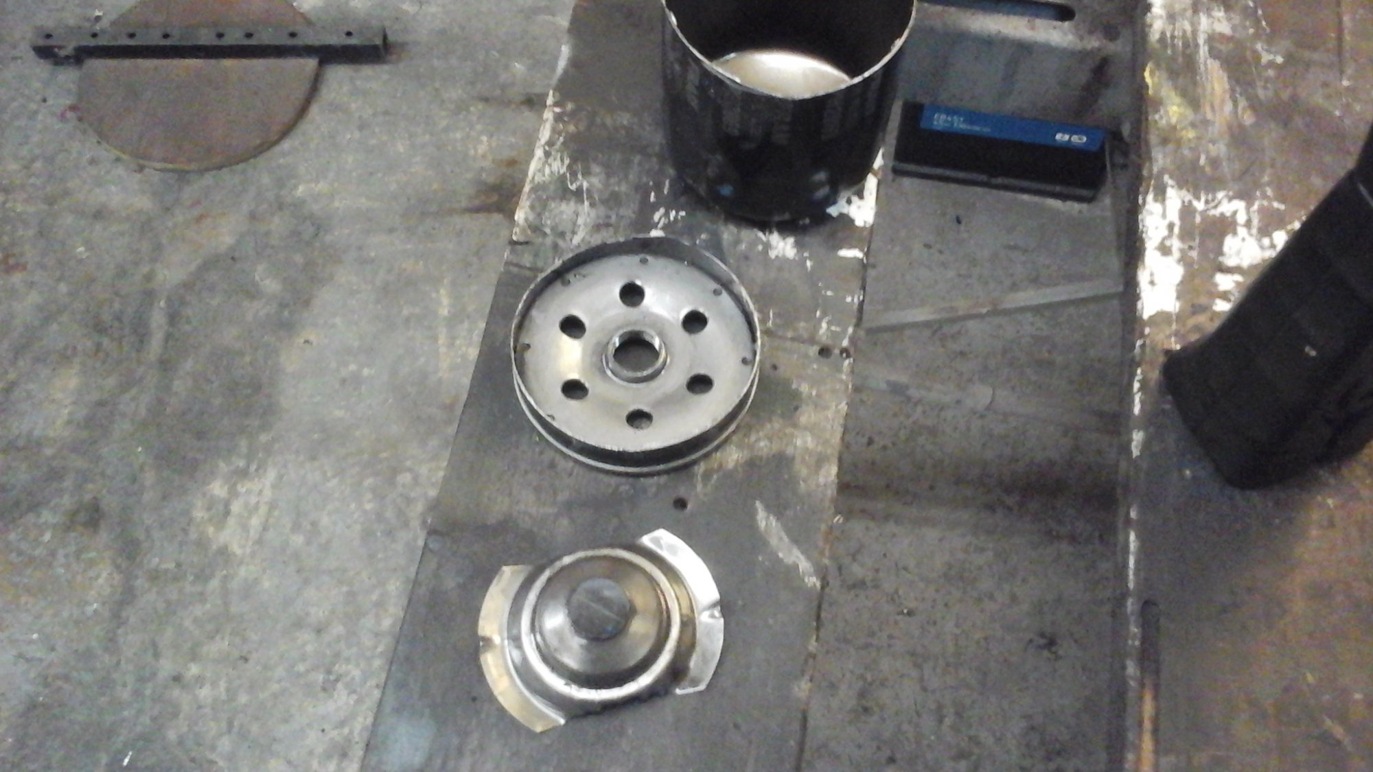

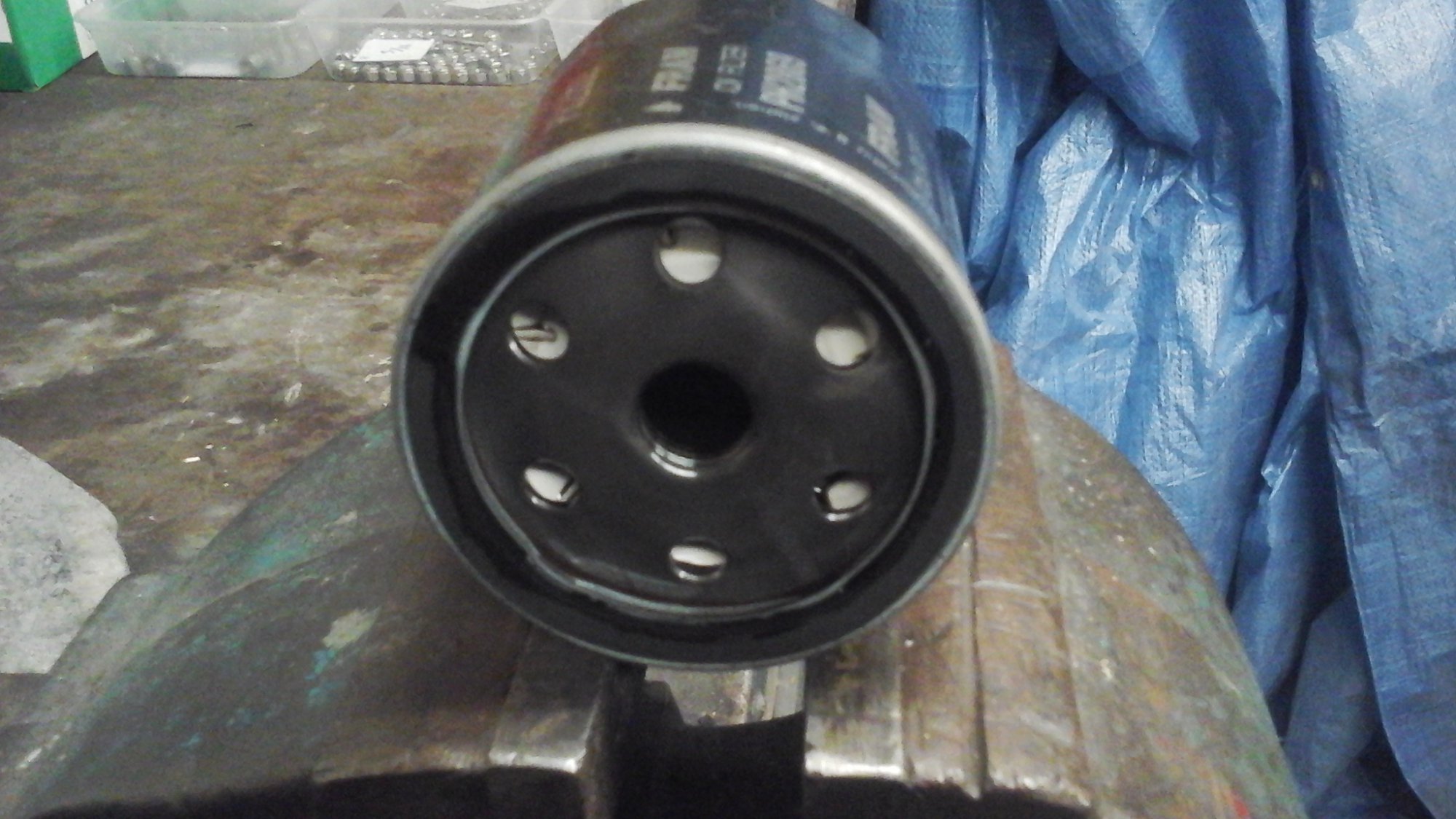

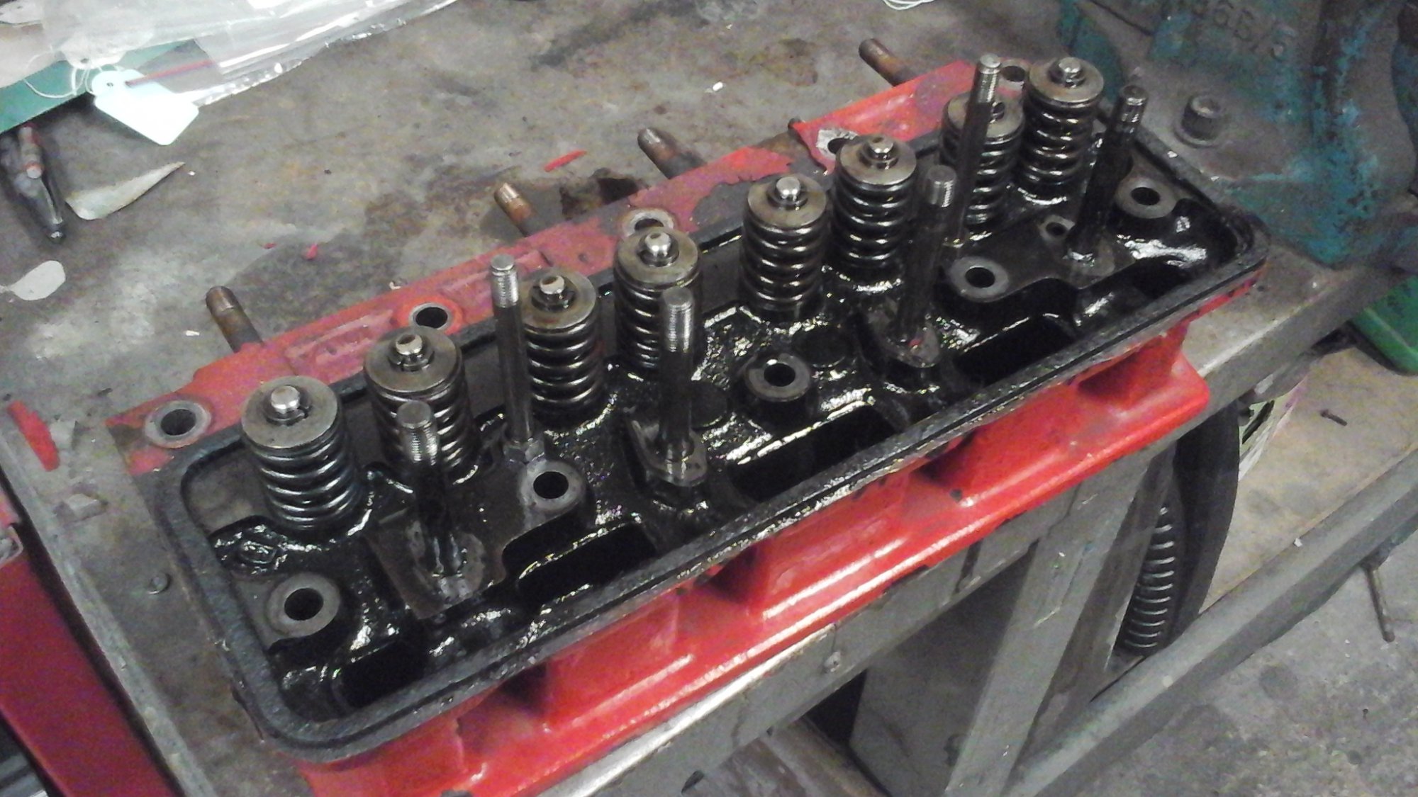

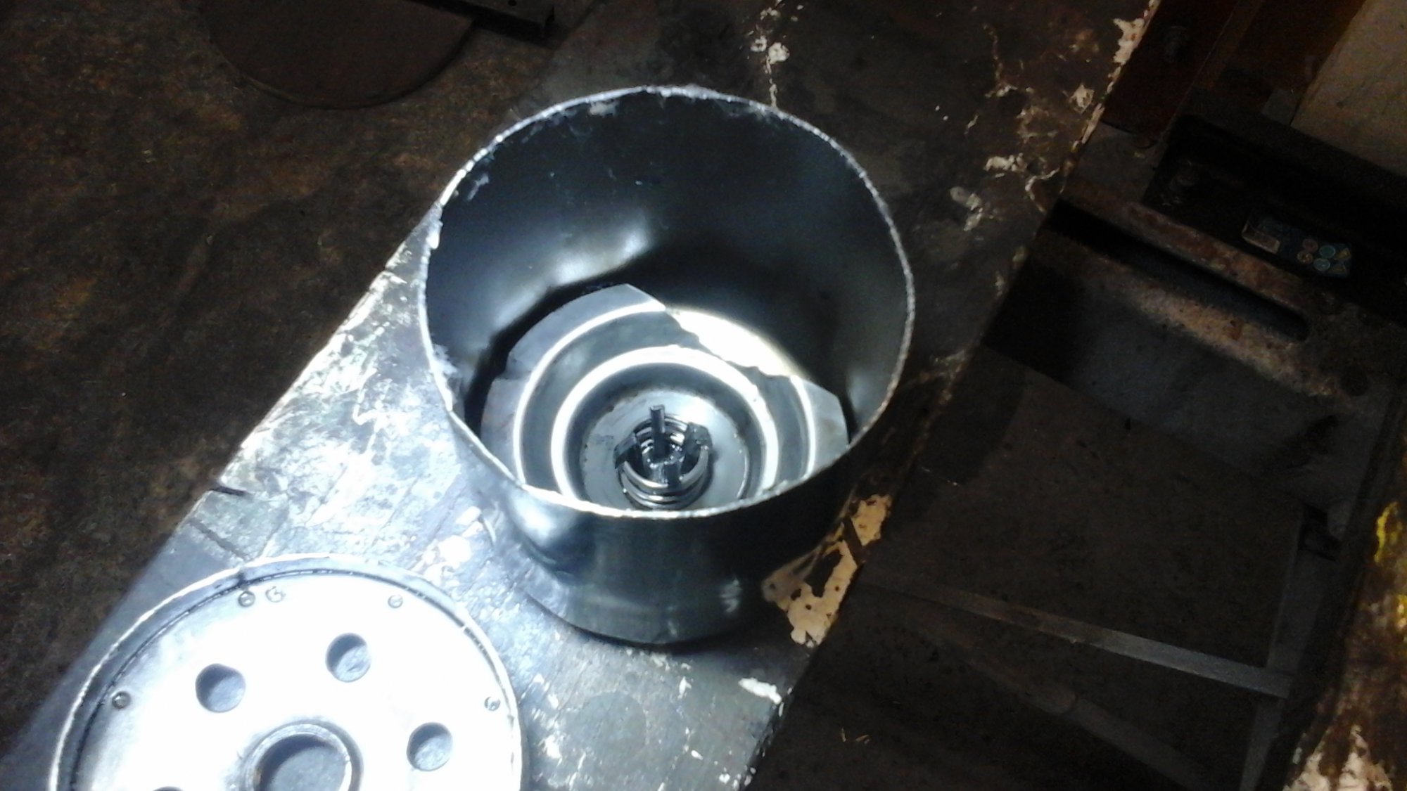

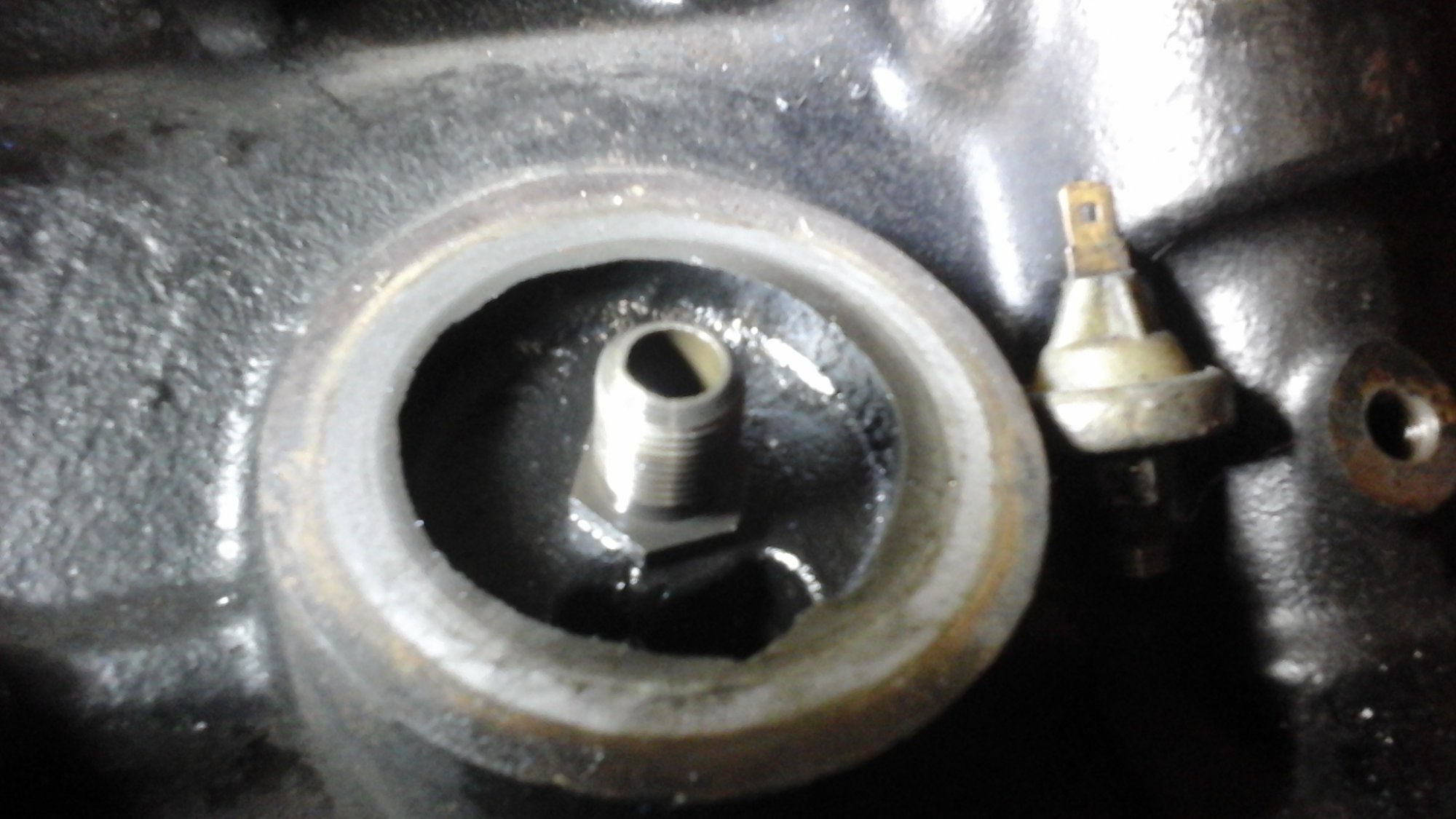

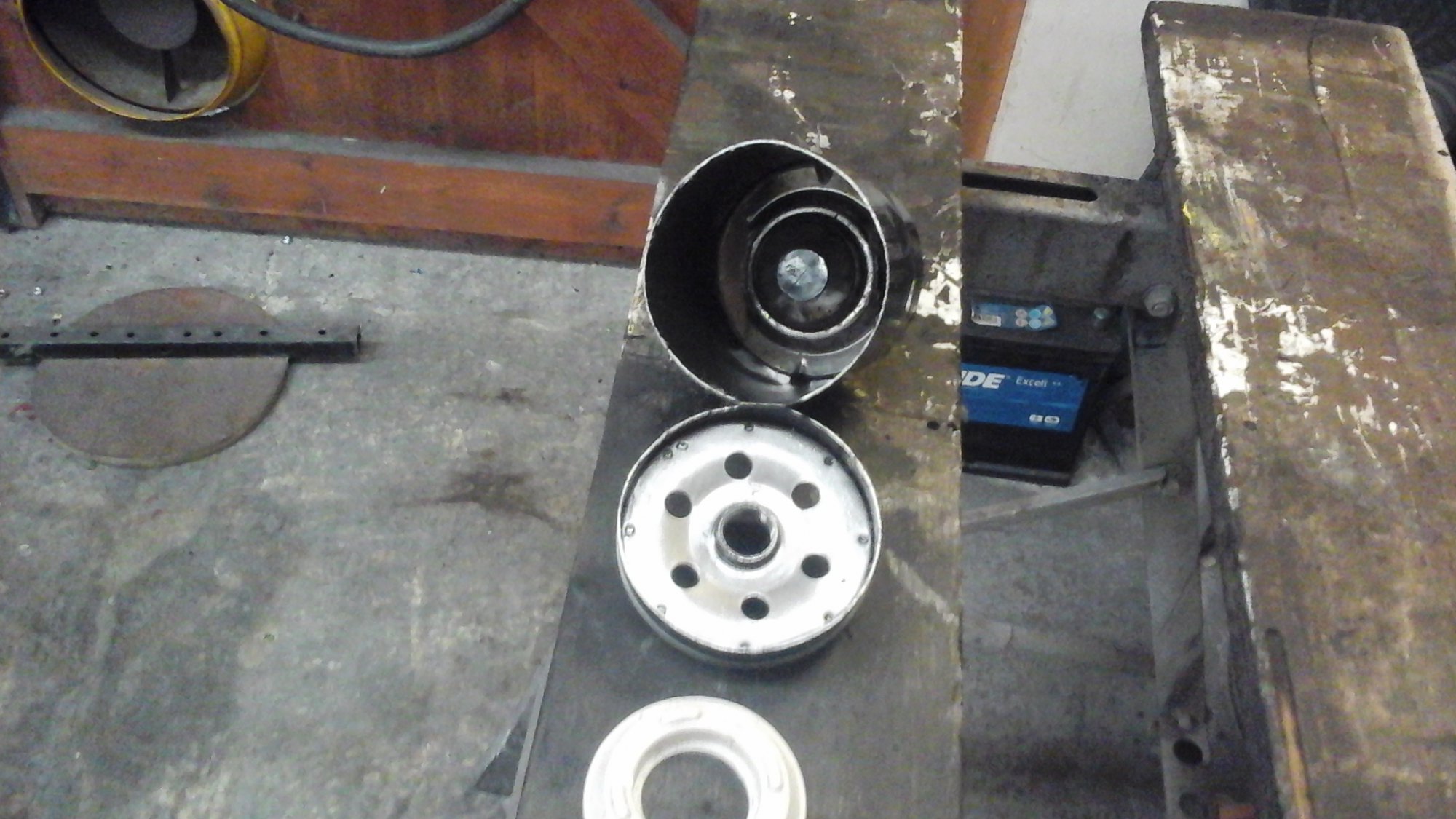

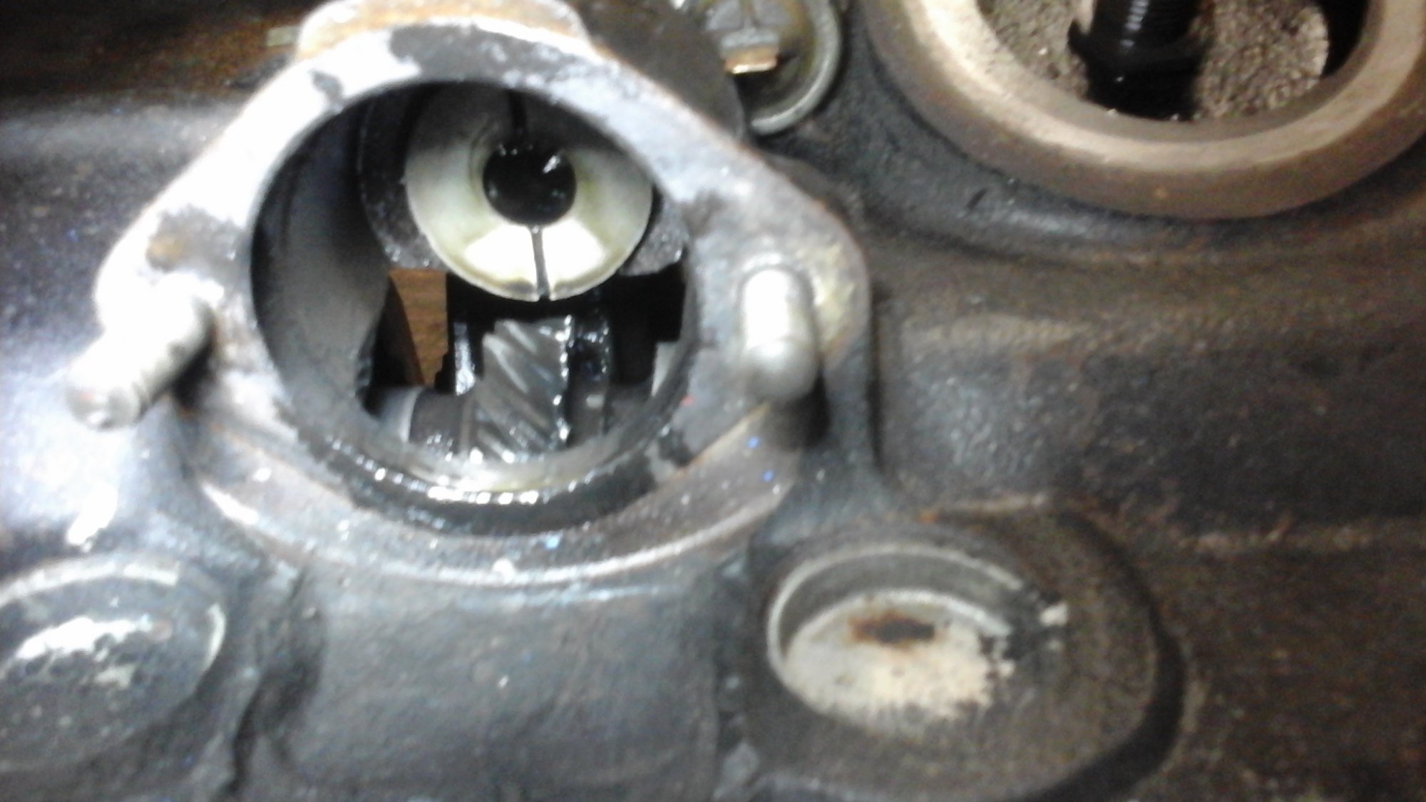

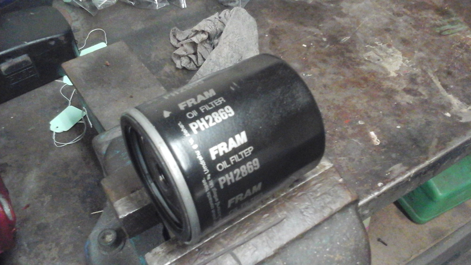

Totally. It turns over no more than two cycles then the light goes out within a second of firing. Having now stripped the whole engine, the only places that don't have oil apart from water galleries of course is the filter. I can see the white elements inside
even if the BPV opens a certain amount of oil gets to the filter element.
