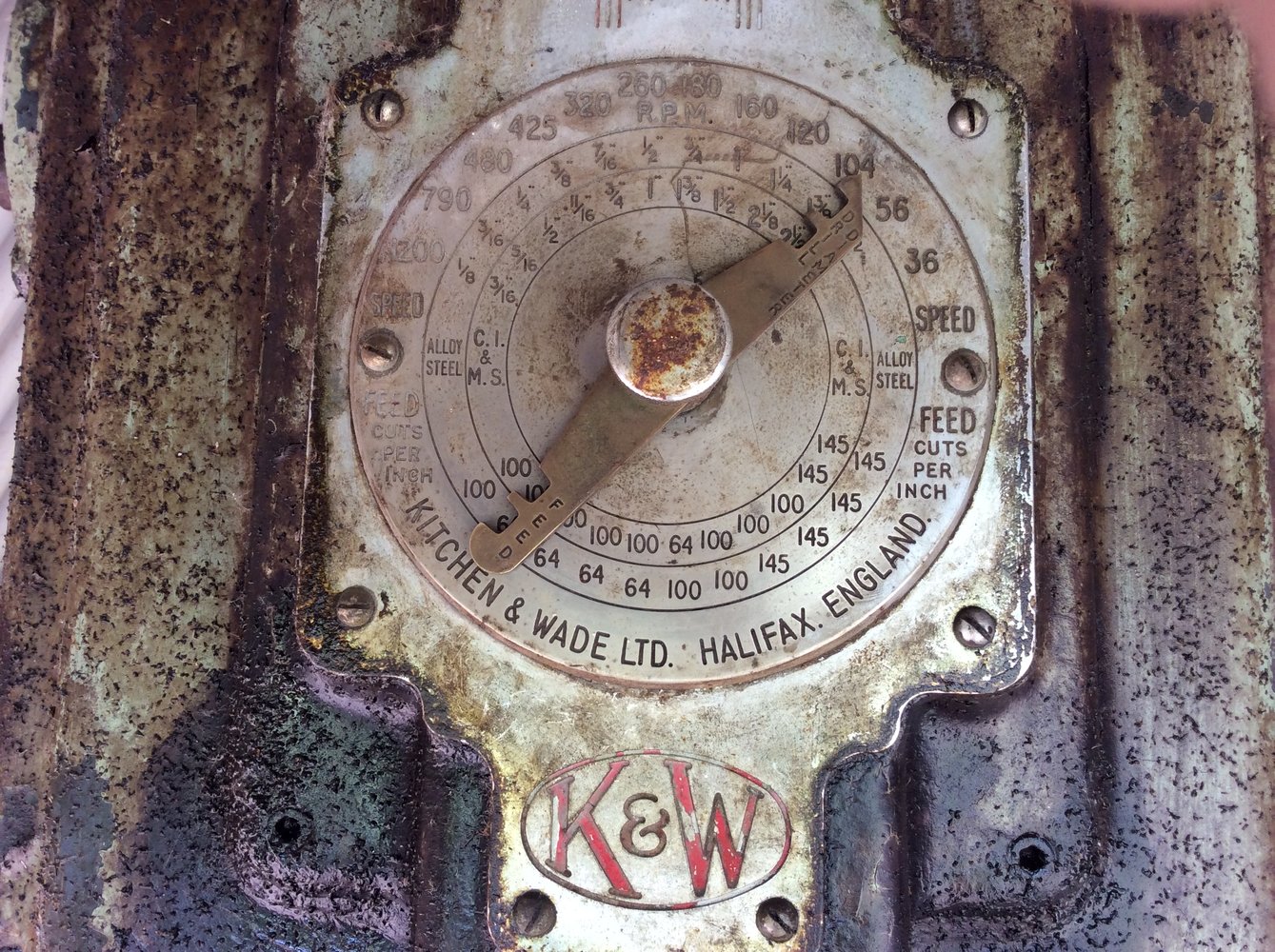

There are still plenty of good pillar drills made but the quality is reflected in the price.As for Pillar drills, if it's not 40 / 50 years old it's not very good unfortunately.
