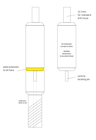

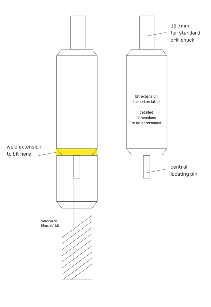

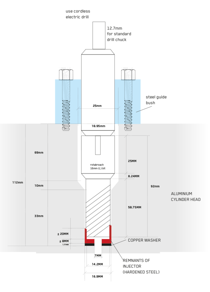

Haven't you got it out yet?Thanks everyone for your valued input. Some great ideas here. I've updated some drawings which I'll attach below. My thoughts from some of the input here from @Kram and @James1979.
See what you think. Mag drill may be better but then would have to make the top end of the extension compatible with the ?Weldon? chuck? If I had a larger guide bush I don't see why a hand drill would not work...
View attachment 367655 View attachment 367656
even better if it had been soaking in injectorex ,,,Just an idle thought but what's to stop you trying to cut a M15 thread in the bit of injector that's stuck in there?
According to your Drg the stuck bits got an internal diameter of 14.2 mm which is about the tapping size. If you can get a tap started and cut a thread all the way down you might still be able to pull it out without drilling?
Got to be less risky than the drilling lark, and you never know, if you can get the tap started the twisting force might even break it free?

I mentioned tapping it further up the thread as well.Just an idle thought but what's to stop you trying to cut a M15 thread in the bit of injector that's stuck in there?
