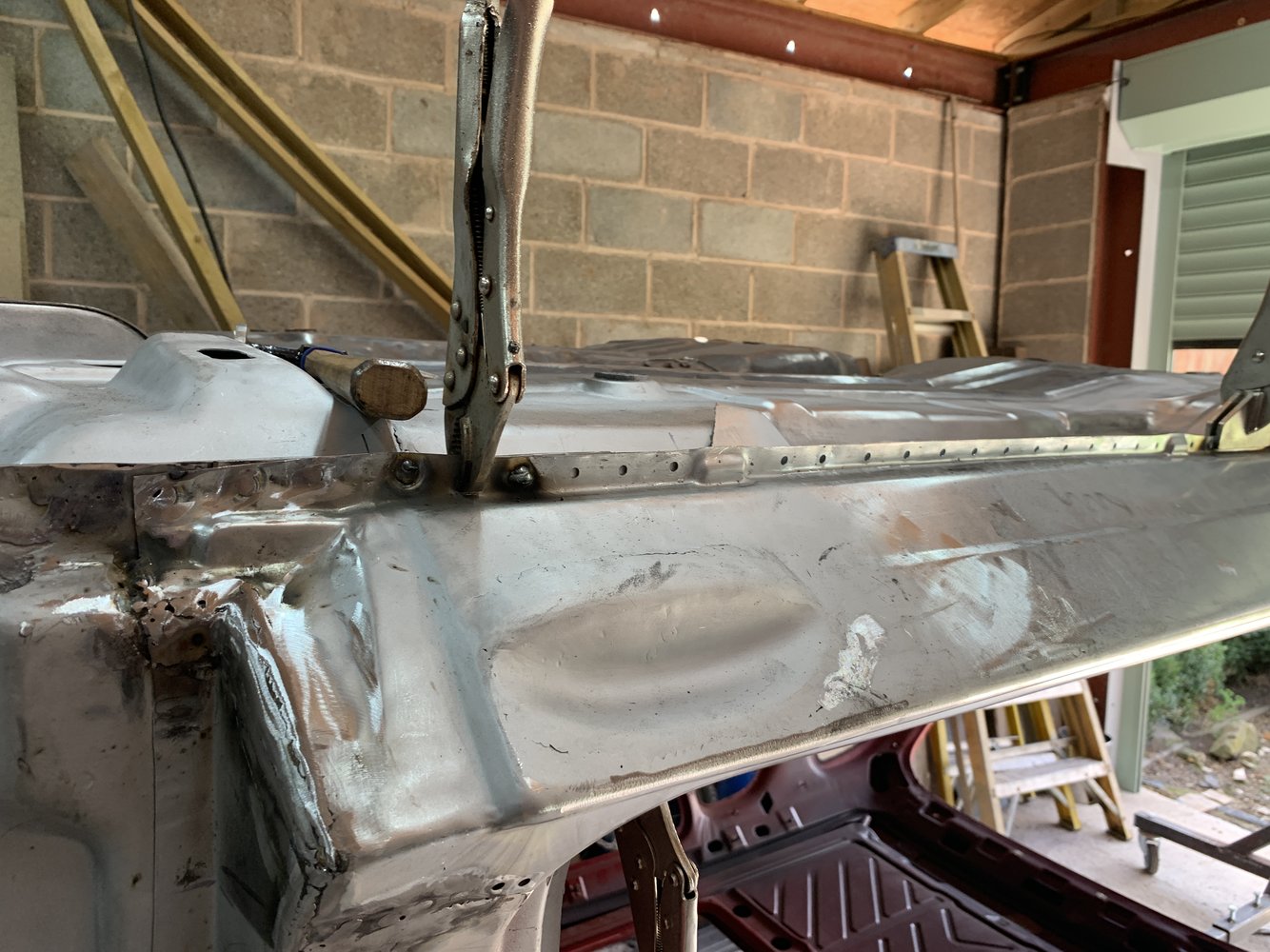

You would be better off practising butt welding on car gauge steel where long beads = heat distorted panels so it's more like joining the tacks with a mig.
Don't buy a joddler, lapped panels will just rust out at the weld point 5 years later due to the trapped moisture, assuming you mean to drive it anyway.
