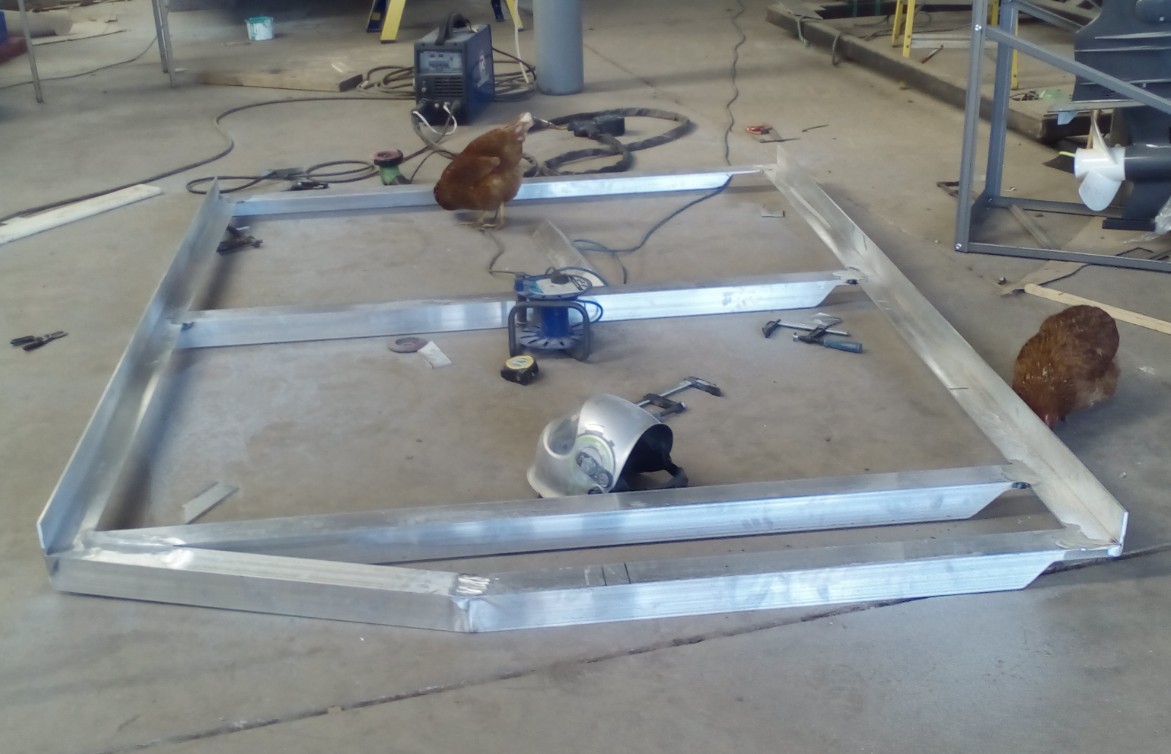

The one I have at the moment is not the best as it had been designed for a limited space workshop so it was to tilt out of the way when not in use. As I just started to progress with the build I got gifted a shipping container so that was now the home for the plasma but I had to continue with the original design (minus the swivel) due to it being already started and also I didn't have time to alter as the table was needed for a few jobs I had lined up.
Electronically/electrically it is good, no changes needed there, so that part will remain the same on the table I am currently constructing.
