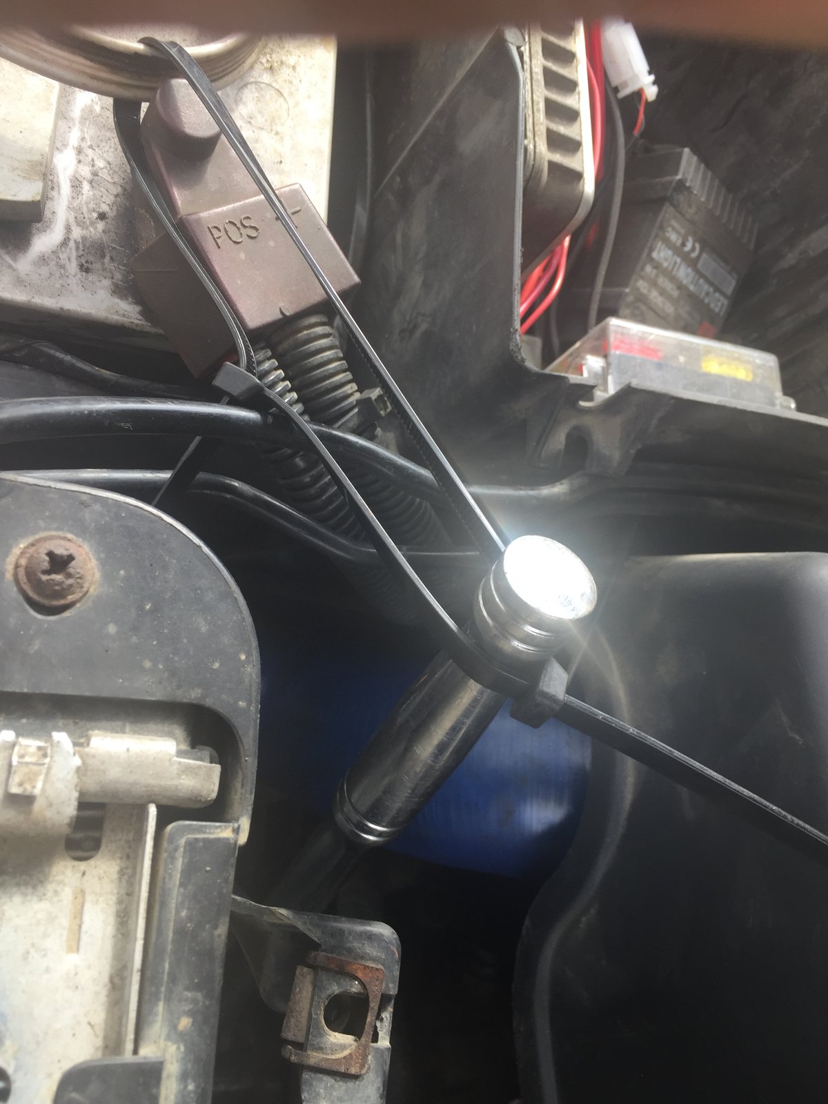

    That looks fairly simple to do the @Kayos, Off with the rocker lid and then replace the loom? Gotta say that seems an odd design to have it inside the casing. But then it's LR they saw fit to make a gearbox drain plug 32mm.
    Are you running with your EGR or not?
  2. Ashley Burton
    Ashley Burton Member
    Messages:
    2,225
    Location:
    Northamptonhire
    Same design as VW PD Engines
    The loom normally ends up failing typically
  3. Kayos
    Kayos Member
    Messages:
    4,369
    Location:
    Yorkshire
    5 minute job, I also put some flange sealant on the gasket as my big oil leak was the half moon at the back of the rocker cover
    No egr, blanked when I got it
    aguycalledsteve likes this.
  4. armalites Member
    Messages:
    3,661
    Herefordshire
    The loom is another one of things the scaremongers make a song and dance about but they cost £25 and if you change it every couple of years there's never and issue and they take minutes to swap.
    fizzy likes this.

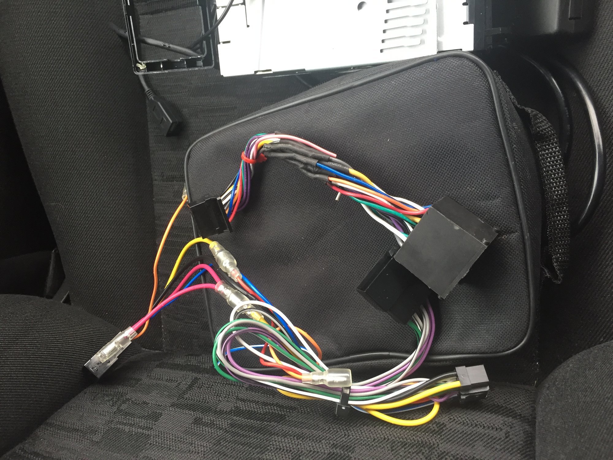

  18. Kayos
    Kayos Member
    Messages:
    4,369
    Location:
    Yorkshire

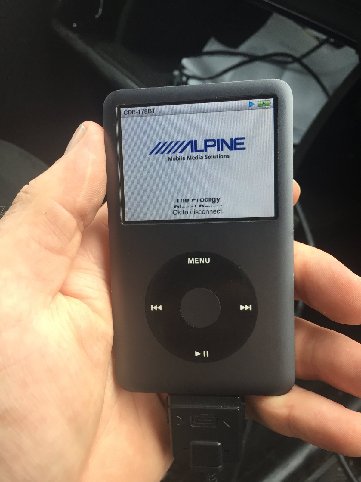

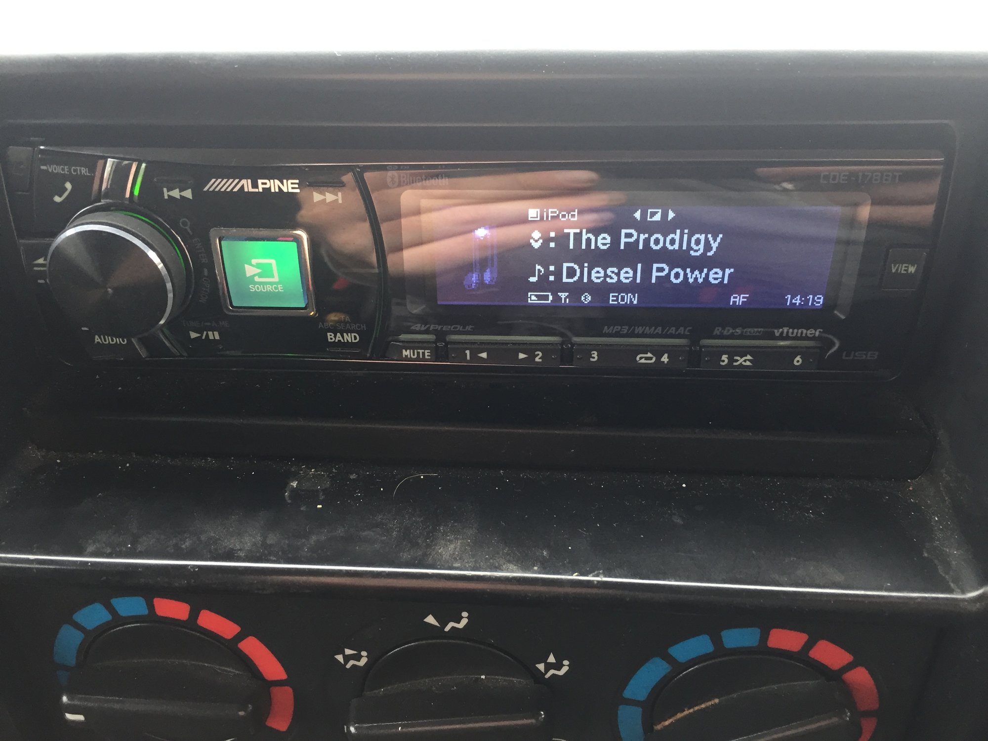

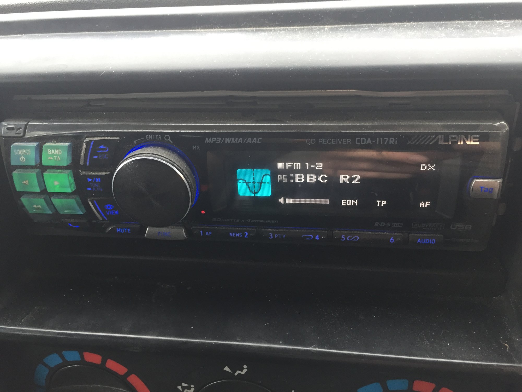

    Audio upgrades today
    Out with the old
    Bought brand new in 2010, CDA-117Ri, first Alpine with usb iPod control so it doesn’t need an adaptor cable or module. Was my front end when I won prize for best audio
    Wiring is the same, on the left is standard loom and on the right is my Alpine to Land Rover loom I made (with bits from a BMW)
    New unit is a CDE-178BT, no Ai net but I’ve not used a cd changer or Alpine processor for years so won’t be missed
    All fitted
    My now vintage iPod still working well
    Main reason for the swap is the built in Bluetooth, I’m bored of pulling over when the phone rings
    I’ve still got amps and crossovers awaiting installation but no speakers so the rest will wait
    Given to me by a friend in exchange for servicing a boiler. His current car has the head unit so tightly intergrated that it will be impossible to swap it, going to use a Cleansweep or similar to upgrade the audio

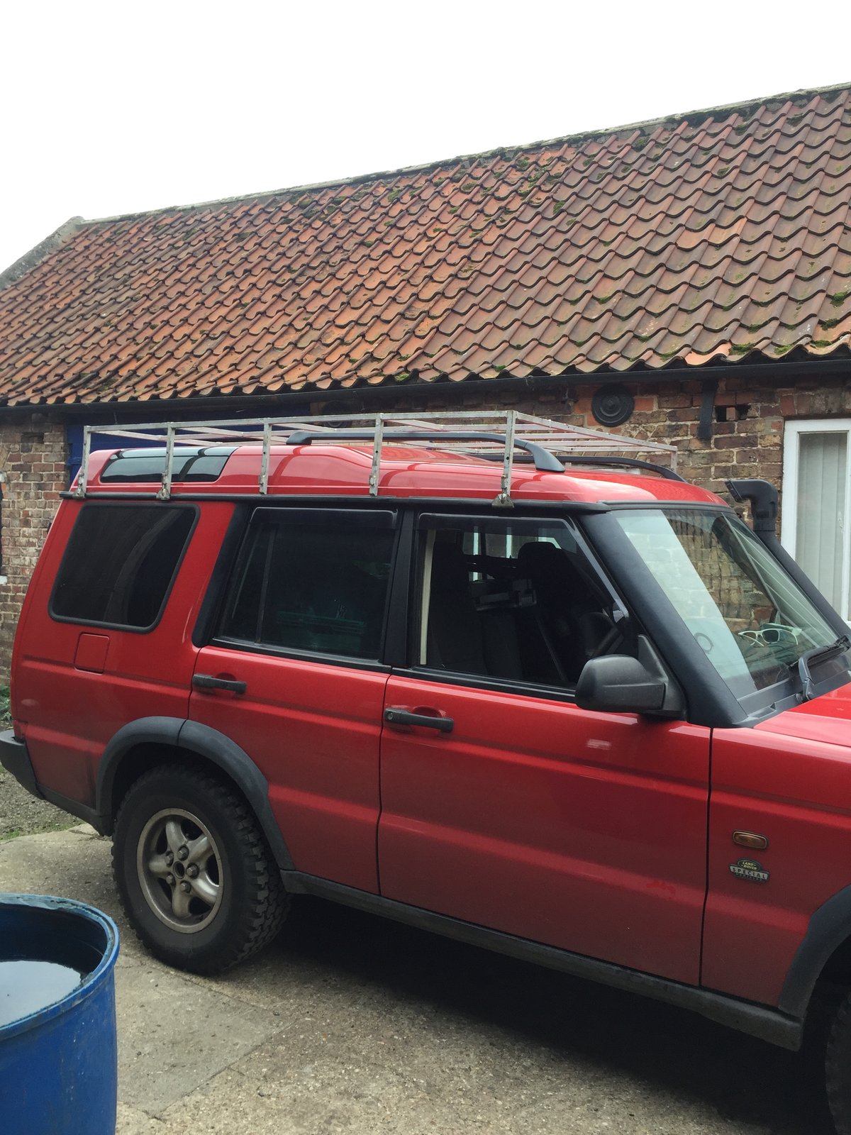

  19. Kayos
    Kayos Member
    Messages:
    4,369
    Location:
    Yorkshire

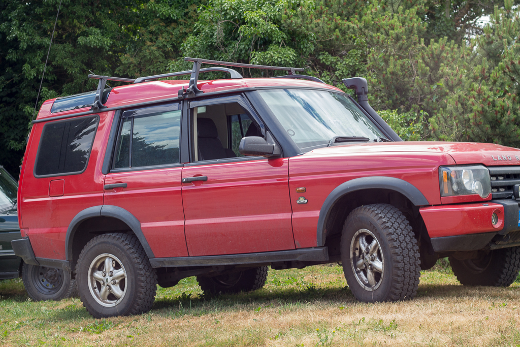

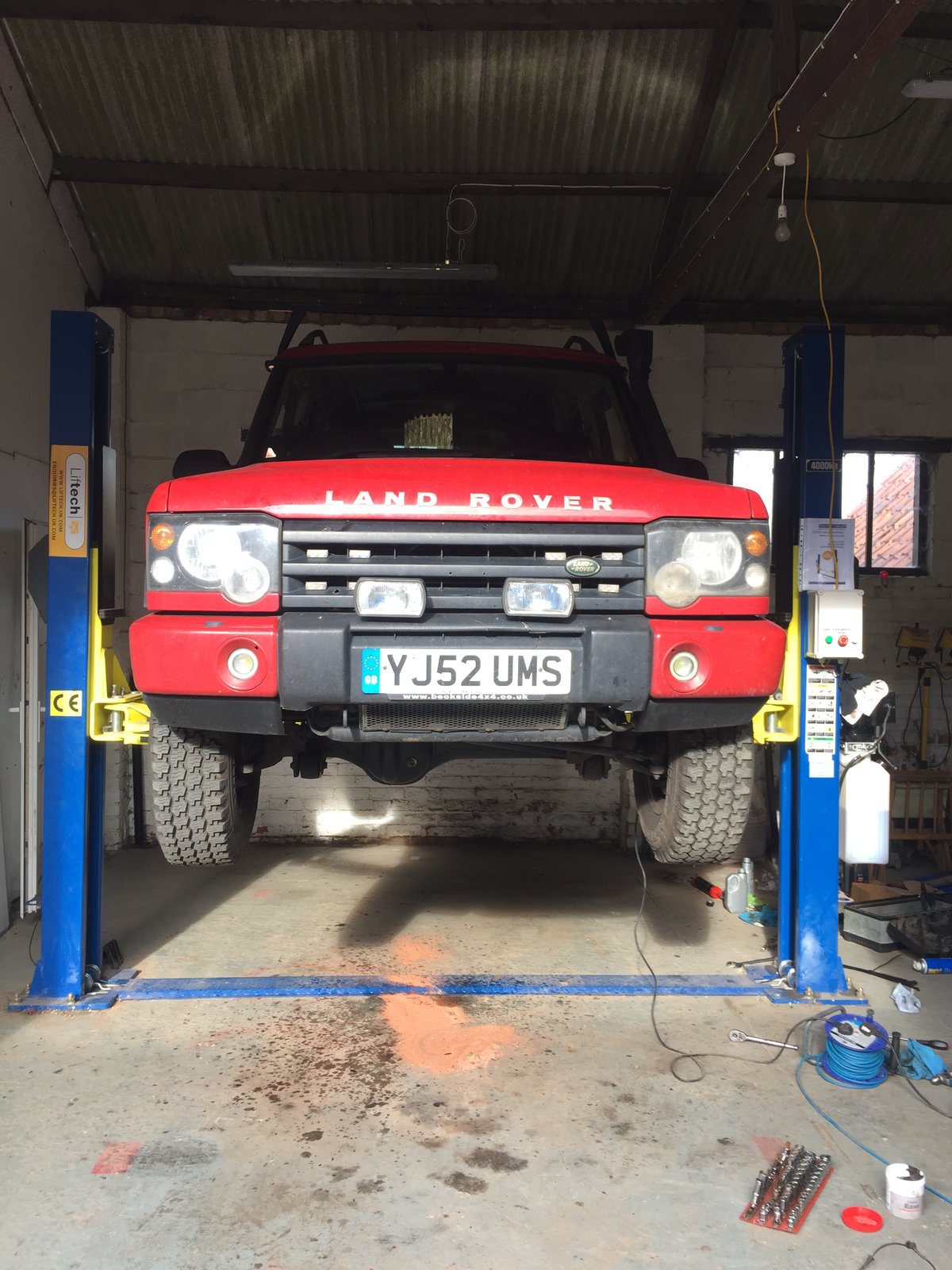

    Big service today, all oils and filters. Helped massively with a kind offer from someone. Also fitted all new bump stops and swapped the front hub so no more amigo’s
    Added a roof rack, needed a bit of chopping and changing and it needs painting next year

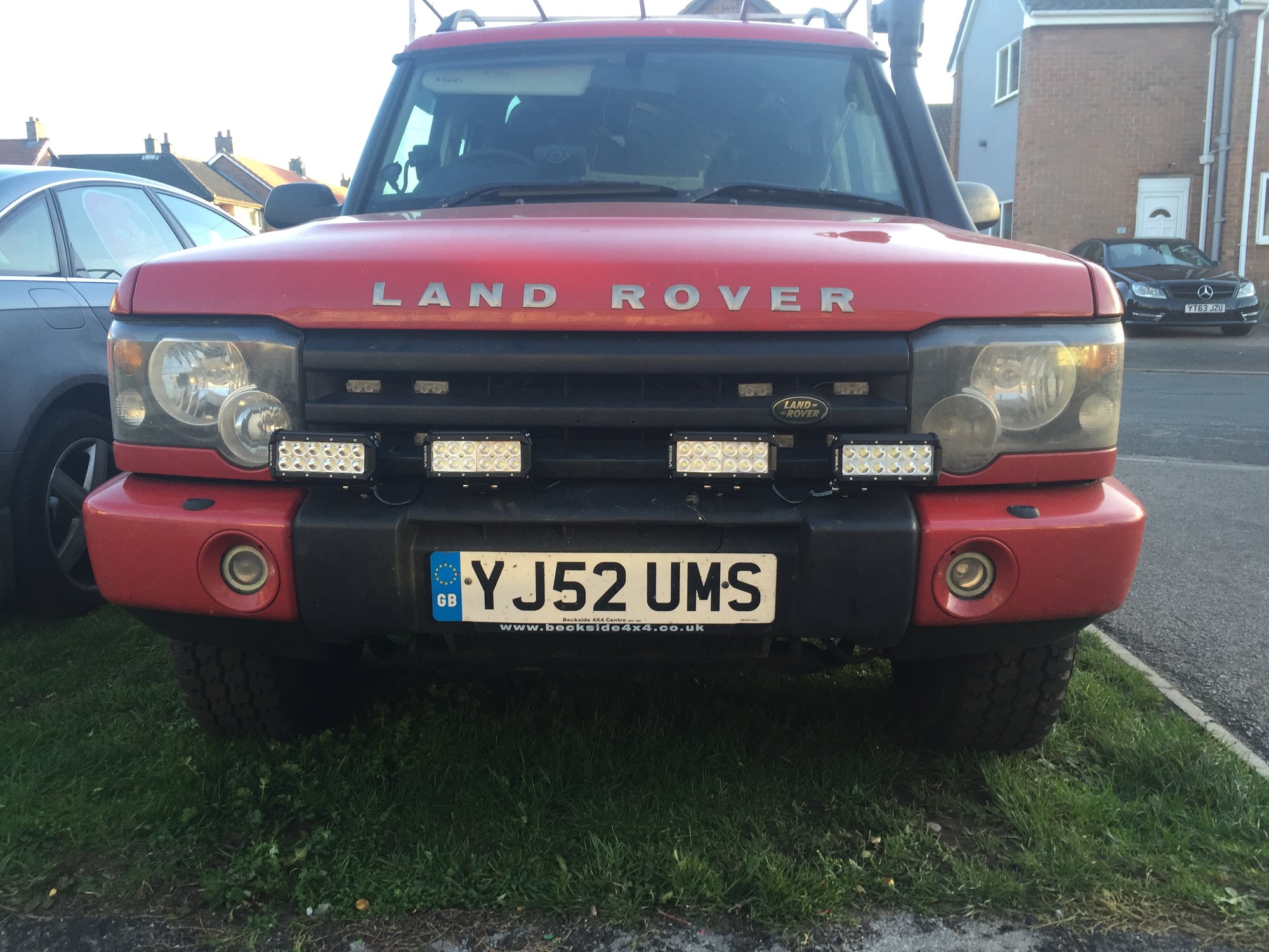

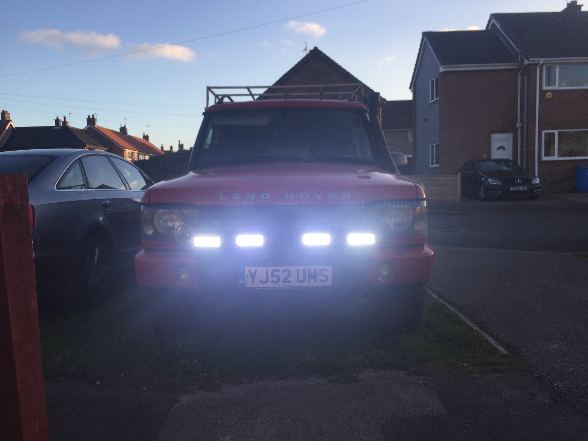

    Little light upgrade today
    Middle 2 are spot and outers are flood
    I will try them on an unlit road tomorrow night
