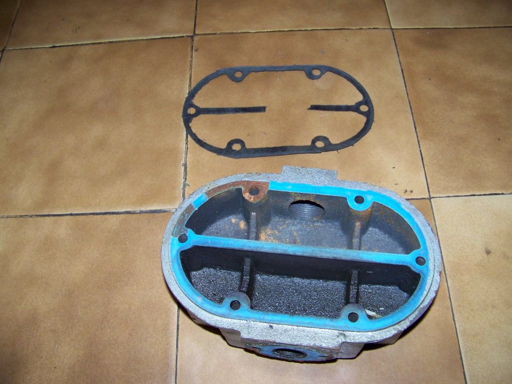

and therefore making the gasket cooler ? This head is cast and you can clearly see the piece out of the gasket you also can see the size of the inlet chamber which is the top section and the fact that if the gasket is made wider it will be in cooler air.You can't destroy heat, you can only shuffle it from one place to another, so if the gasket is passing heat from the block to the inlet stream it's heating up the inlet stream.
