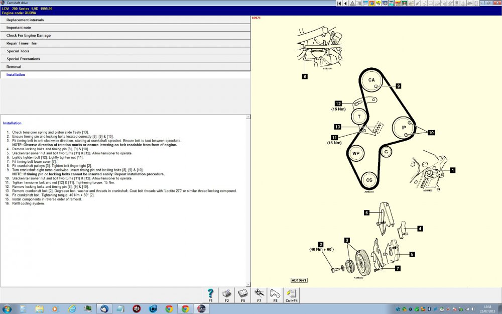

I was following the instructions i have and with the head off 1 & 4 were at TDC as they should be.PS

Will check Autodata tomorrow, see what it says.
1-you must use a pin through the front of the crankcase behind the starter to lock the crank
2-does it have one of the injectors with a 2 pin electrical cable on it,if so did you put it back in the cylinder it came from?
tappety?this is valve to piston interference- see (1)
also check the keyway on the crankshaft gear as theres an issue with them shearing
just friendly observations,as i used to work as an engine technician/builder for a reconditioners for years.
I haveWill check Autodata tomorrow, see what it says.
It's a single cam with a keyed sprocket so can only be in one position and has a hole which you bolt it to the head and the pump has two bolts all have to line up for the pin to go into the flywheel
By that statement Are you now saying you didnt pin the crank?I was following the instructions i have and with the head off 1 & 4 were at TDC as they should be.
No I didn't only thing I did at the pump was loosen the unions to move the pipes out of the way and then bleed it.did you have the banjo bolts off the fuel lines at the pump? did one look different to the other?
