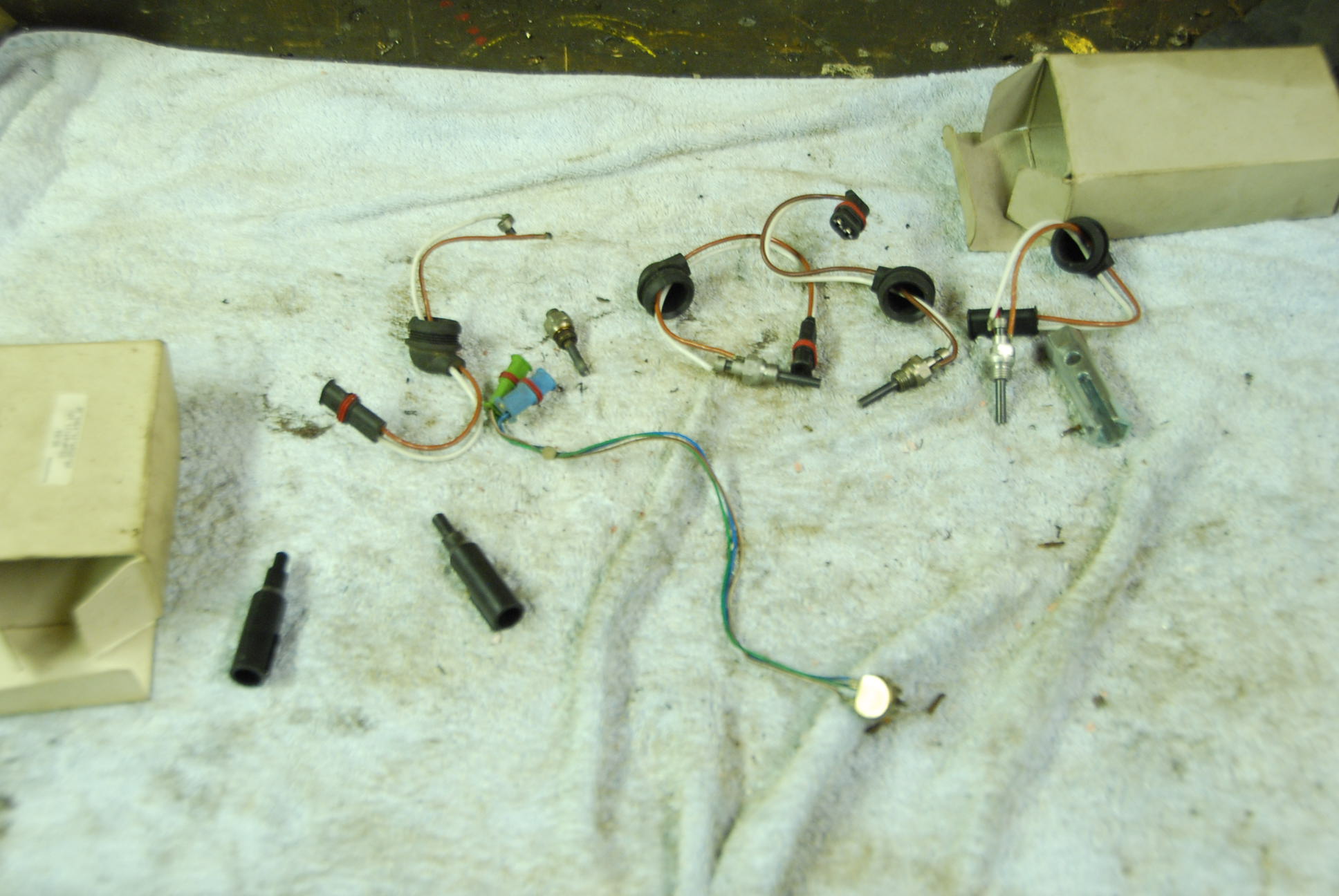

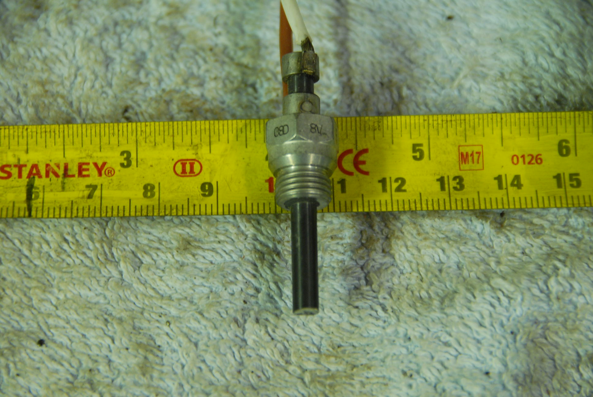

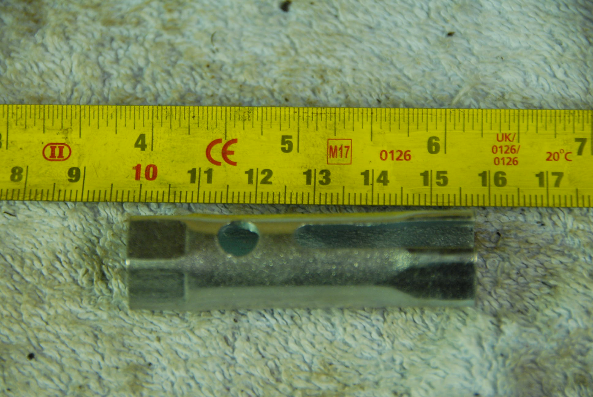

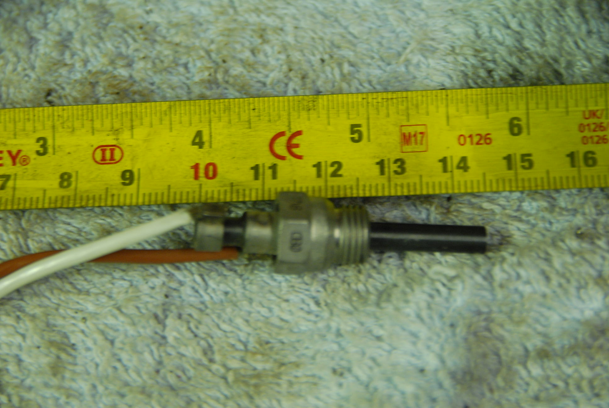

thank you and your father it’s very generous and kindAll posted Sammy you should get it tomorrow or Saturday at the latest. Father said while your waiting for it to arrive grab yourself a 12mm box spanner and make a 4mm wide cut down the side 30mm long
else you will have the same problem getting the glow plug in if its the same setup as the eberspatcher ones. Tool station do a hole set for less than a tenner.

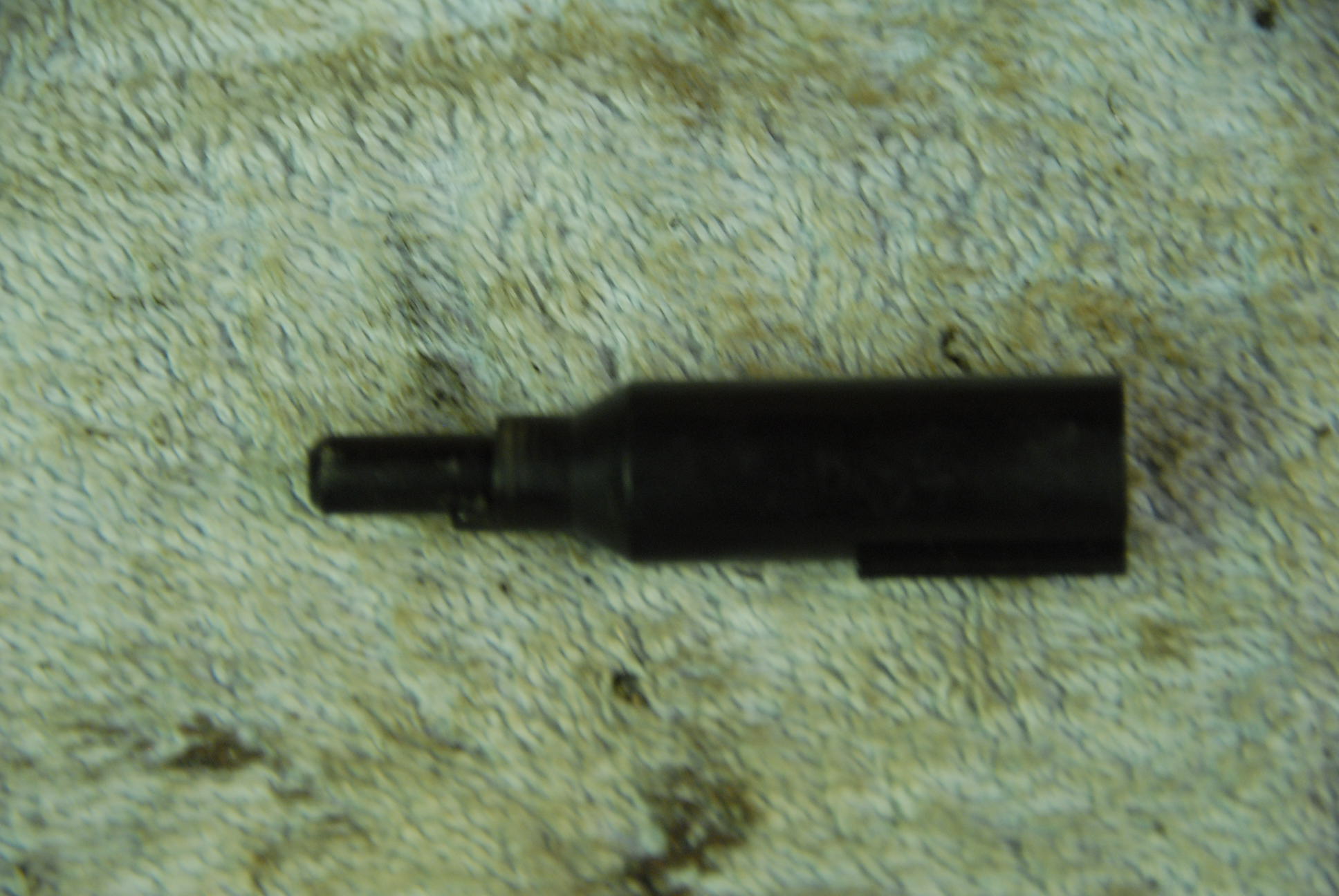

Oh and the little black thing
also in the package is for removing the mesh screen should your have it in your and need to remove it to clean it. Father has a few spare ones so he said chuck it in.Fathers in a good mood today
