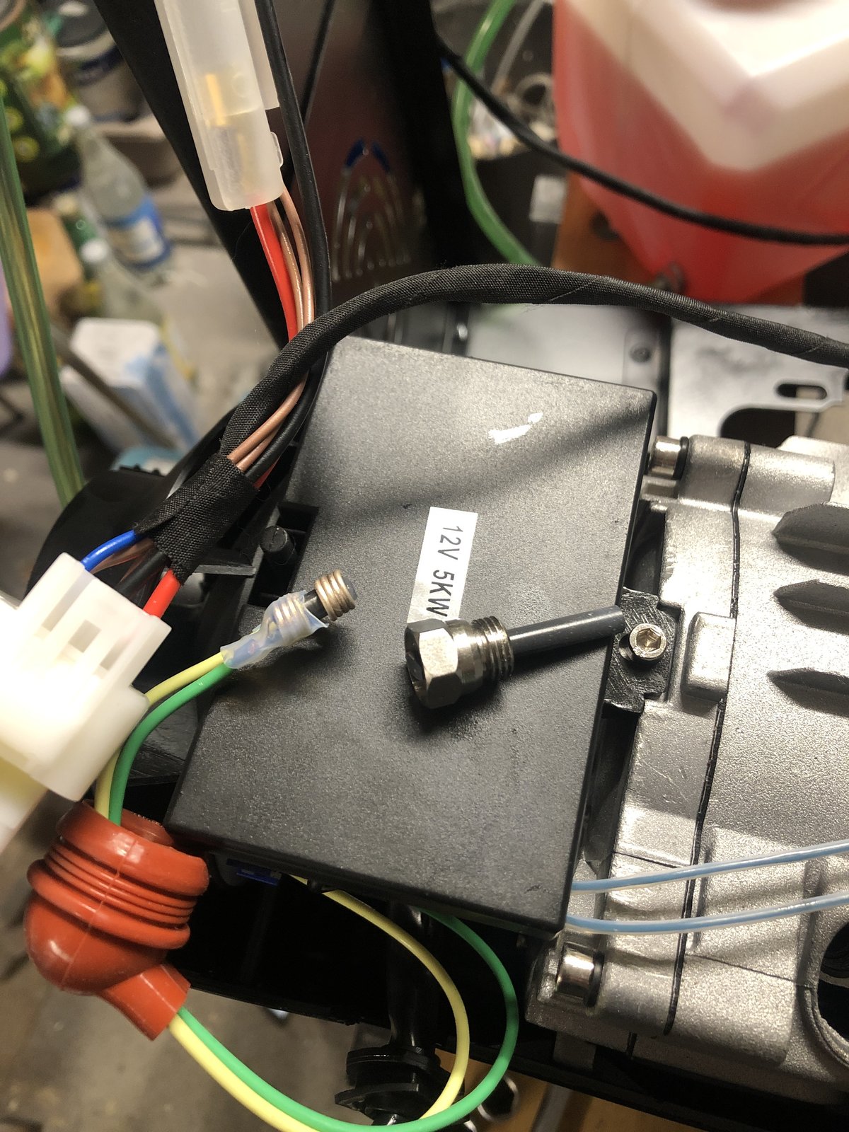

Dam 5amp 12v supply ! That would make sense not enough juice

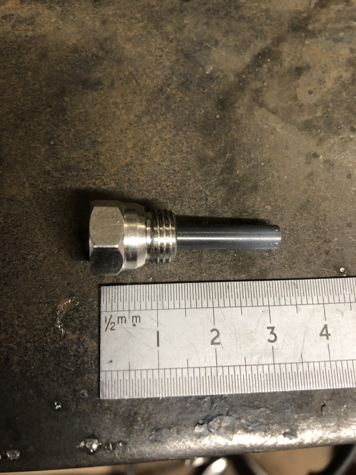

However to make matters worse i’ve just snapped end off glow plug trying to remove it. So can’t even try car battery now.
hence the special box type spanner its got a cut out so the wires not damagedAnyone know where to get a new glow plug from? J91118 printed on side.
I wish I had seen your post before I started dismantlingHow are you powering it? The glow plug will draw about 12 to 15 amps at 12v and some power supplies aren't upto it but the voltage doesnt drop low enough to display the low voltage error.
5 years mine didn’t last 15 minsJust wondering if it the same as the eberspatcher ones what size heater is it, if it the same as the D2 or D4 I might have a spare or good second hand one on the shelf as fathers changes his after 5 years weather needed or not. and he don't throw nothing away

How many amps is your power supply?
