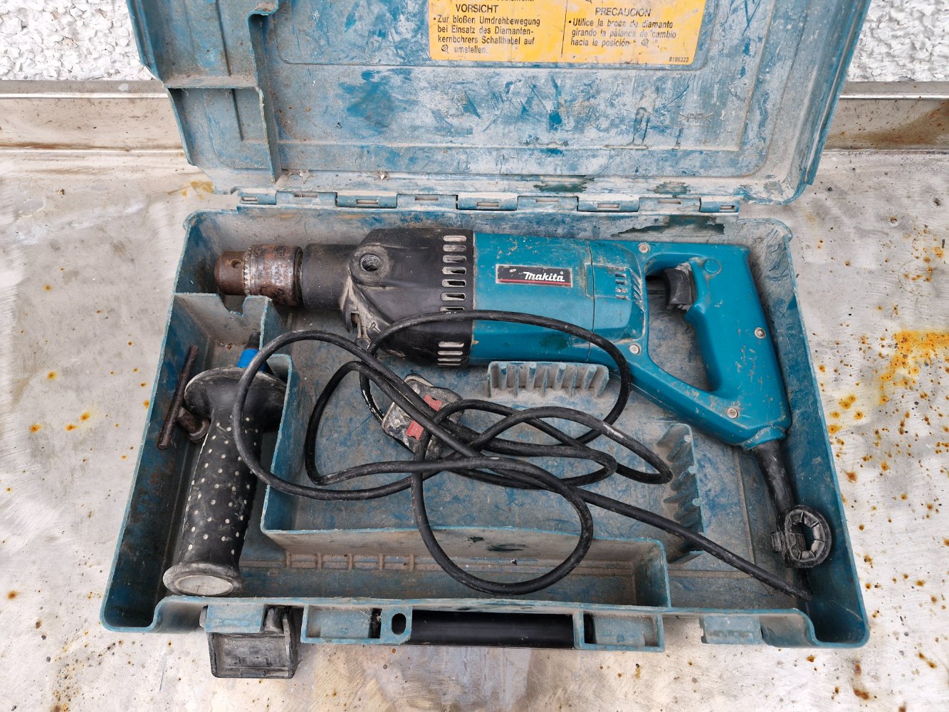

Well I finally bought one. Locally on FB £25. A bit rough around the edges but it runs fine and is 230v what I wanted.
I have a 50mm core to run through a 300mm masonry wall in my garage this week. Ill test it on that first then if successful ill strip this drill and clean out the vents + replace any worn bearings etc to keep it good. The case is banjaxed too so ill be needing one of those and the proper handle.
The overtorque clutch in those is a service item (like an oil filter). It is worth keeping an eye out for a replacement as prices for that part vary considerably, from sub-£70 to over £100.
From memory, the handle thread is M12 fine thread which is unfortunate as it limits what you can screw into the hole.
