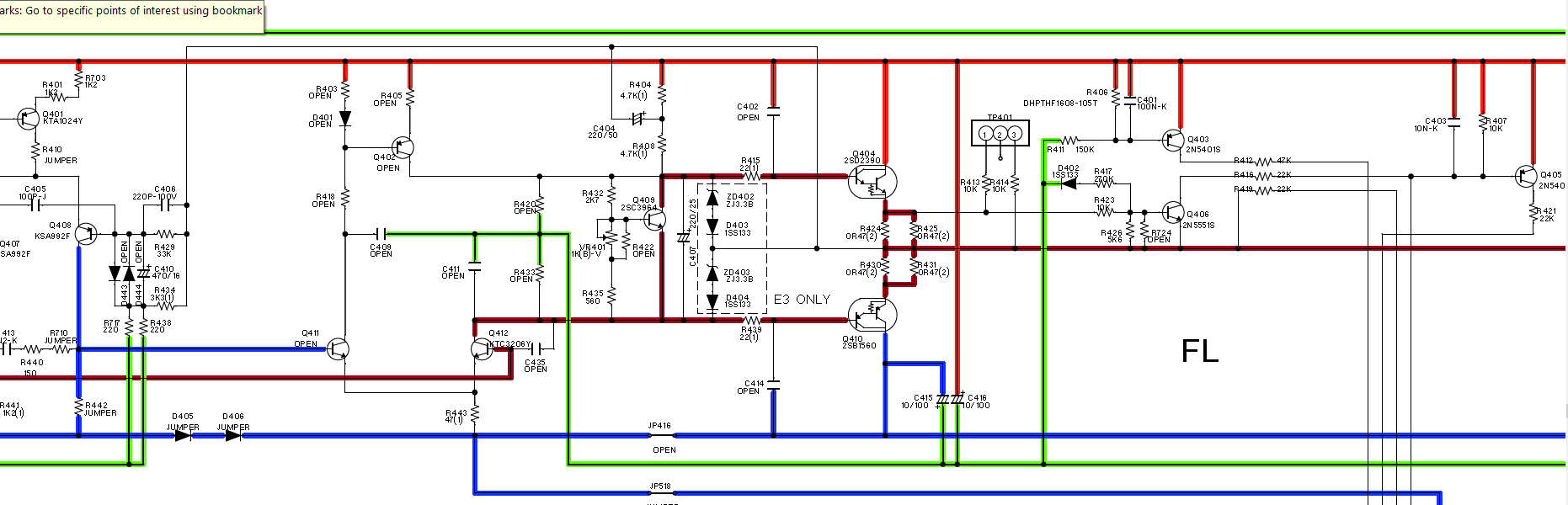

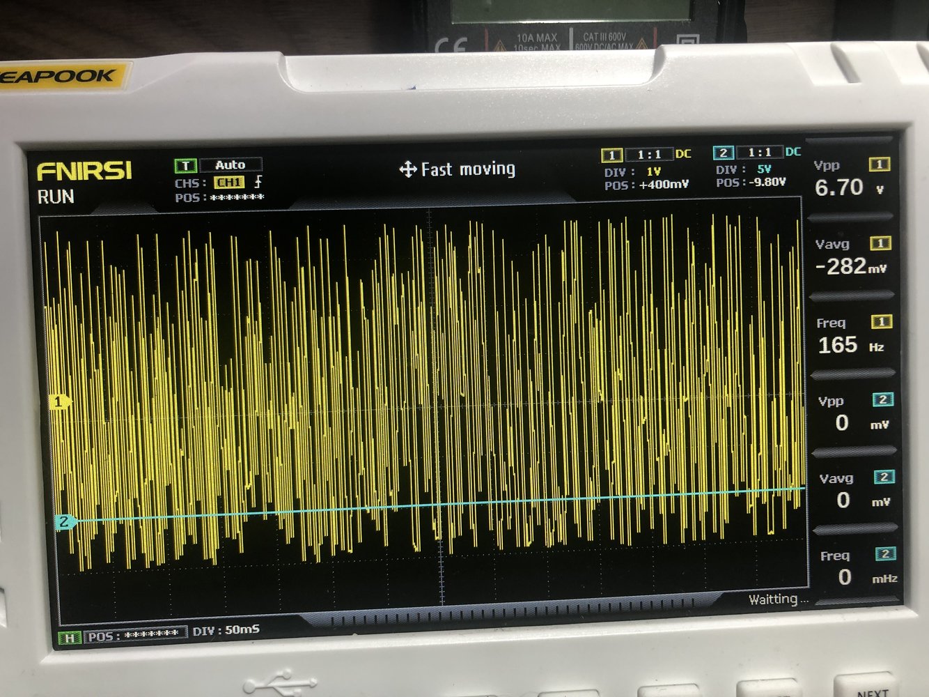

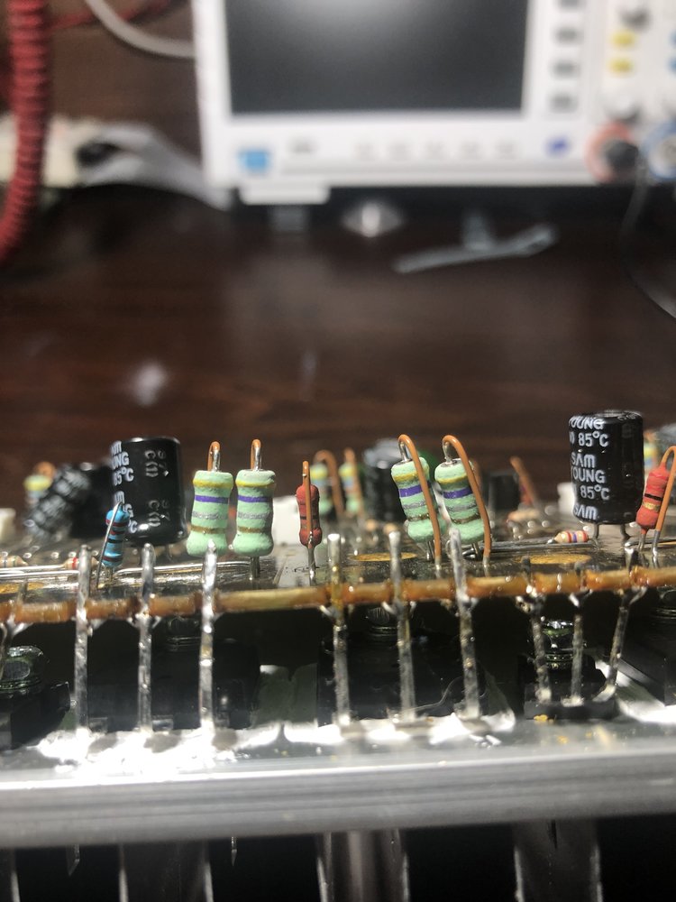

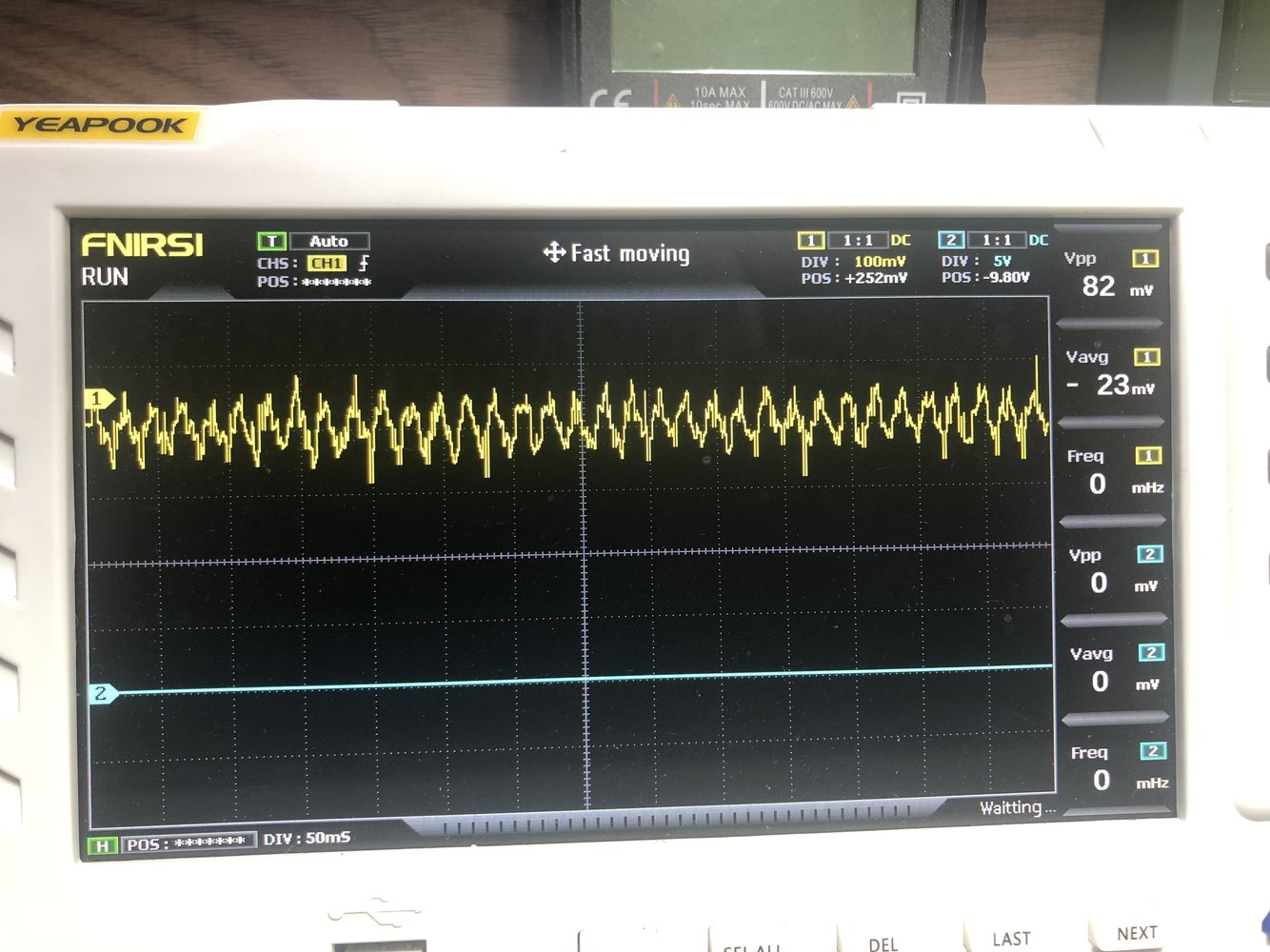

As detailed on another thread, I am working on a surround amplifier that has been got at in the past. It has been taking out its power transistors on the front left and front right channels, seemingly at random although all Voltages are in sensible figures. I have a new set of expensive transistors in there now and am trying to set the idling current. This is done by adjustment of the trimpot to achieve a Voltage of 6.5mV, waiting ten minutes and then setting 8mV. This is specified with no connections anywhere, to anything. The interesting point is that there is no Voltage being developed at all, which tells me that the output transistors are not pulling any current. I have tried two other Voltmeters plus my 'scope. The circuit diagram is particularly unhelpful in terms of Voltage readings so I am scratching my head a bit.
Before the last transistors died, I did have an amount of wooly audio from the front channels with the volume set flat out, but nothing like what would be expected. Circuit of one channel below. The test voltage is across the emitter resistors, via a 10K to TP401. I have plus and minus 60V DC being supplied to the PA board.
