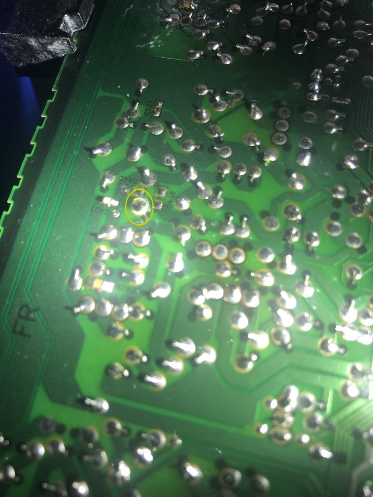

Thinking out loud a bit:Centre good channel:
With respect to chassis and no output load or input signal...
Q434 Base 1.2V, Collector -58V, Emitter 47mV } Fairly typical across all but FR channel.
Q428 Base 1.1V, Collector +58V, Emitter 27mV }
All idle currents set in allowed range.
FR channel...
Q422 Base 1.2V, Collector -58V, Emitter 200mV
Q416 Base 1.05V, Collector +58V, Emitter 188mV
Heatsink is warming up but not getting excessively hot.
Just to confirm that the parallel resistors in the emitters (R424, 425, 430,431) are definitely present and all 0.47ohm?
Biasing instructions say to set test point (e.g. TP401) pin 1 to 8mV? Therefore the emitters should also be at 8mV ± 0.5mV when adjusted correctly?
