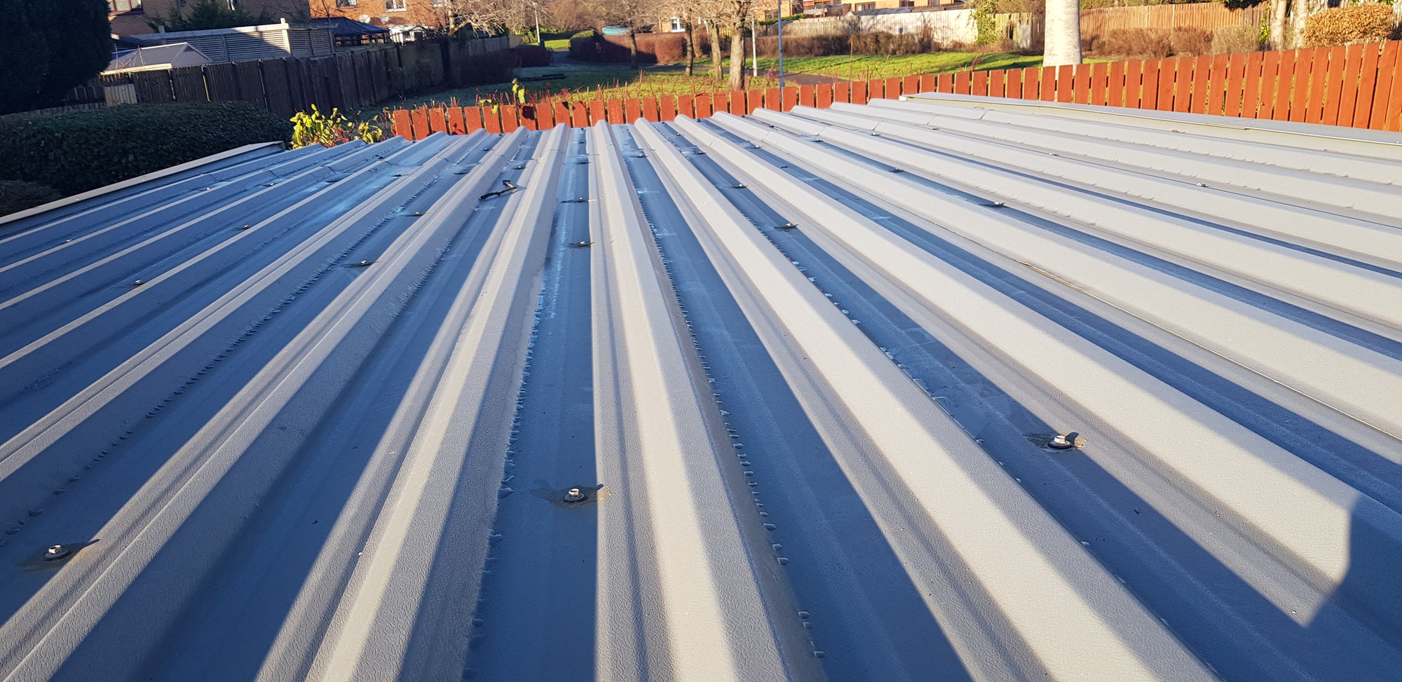

You could lift the roof with counterbattens and fit a membrane, could probably be done for £100 in timber and about £50 for a roll of membrane.any recommendations

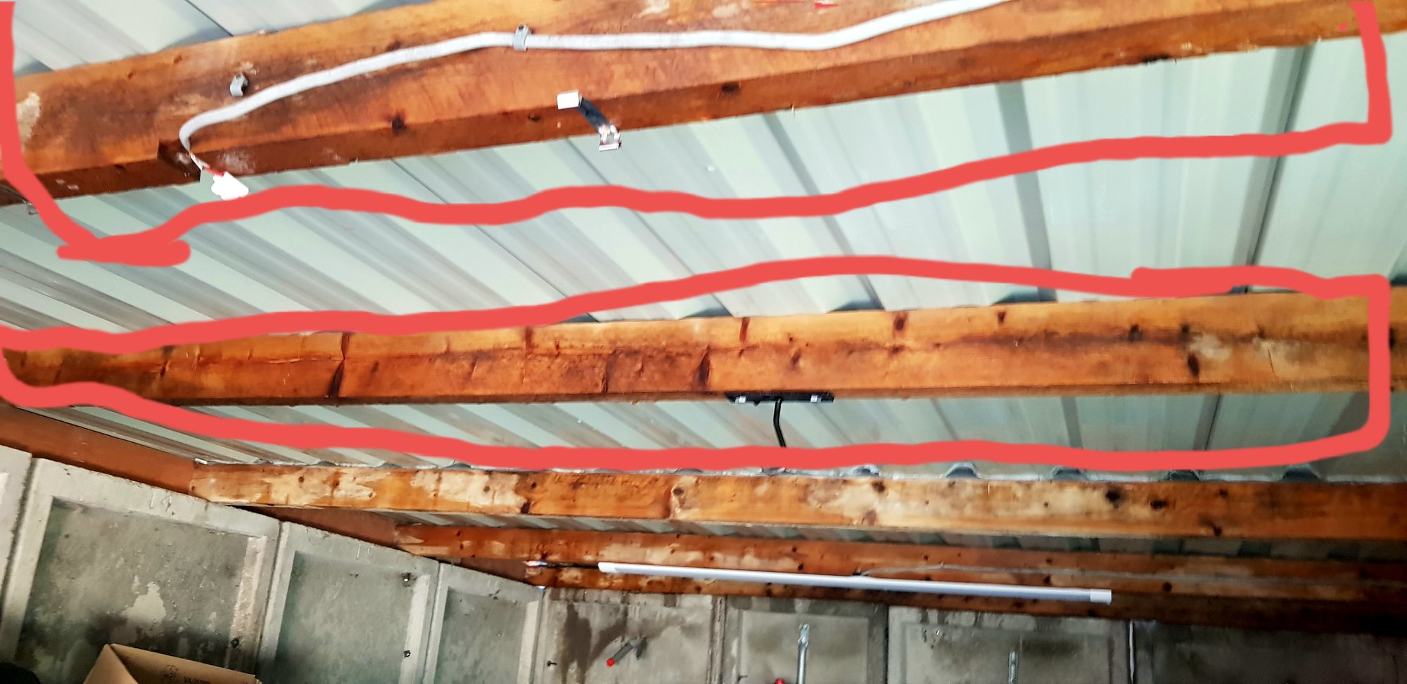

Hi knight thanks for reply .So as a newbie just bear with me : the reason of condensation is warm air rises and has to have a exit . As Tigdlo replied I would have to put counter battens on top of the joist then put a membrane down then put the roof back down is that correct.but how would that stop the condensation within the garage?.we do have a problem with the floor it leaks every time it rains there's always puddles inside .I'll fix that in the summer hopefully .I turned the electricity off because water was going into the lights as you can see in pictures I can just put them on top of the slabs instead Any other ways of insulating or stopping condensationdon't insulate them, better off leaving them open to let them breath
if you want to insulate you'll have to insulate ontop of the roof (so insulation/another roof ontop)
Cheers newbie question were would you put the roofing sheet,like would I have to take roof off and lay it or within the garageIf those roofing sheets are single skin metal there is simply no chance of avoiding condensation, on the inside, during freezing weather - unless the humidity inside is zero. If the roof gradient is adequate (such that condensation will run down towards the next joist) the condensation will stop at the joist - where it will soak in, unless those joists are sealed.
I would think that the best way to protect the joists, in the long run, is a good insulated roofing sheet. Cheaper solutions for one aspect is not always the best one overall.

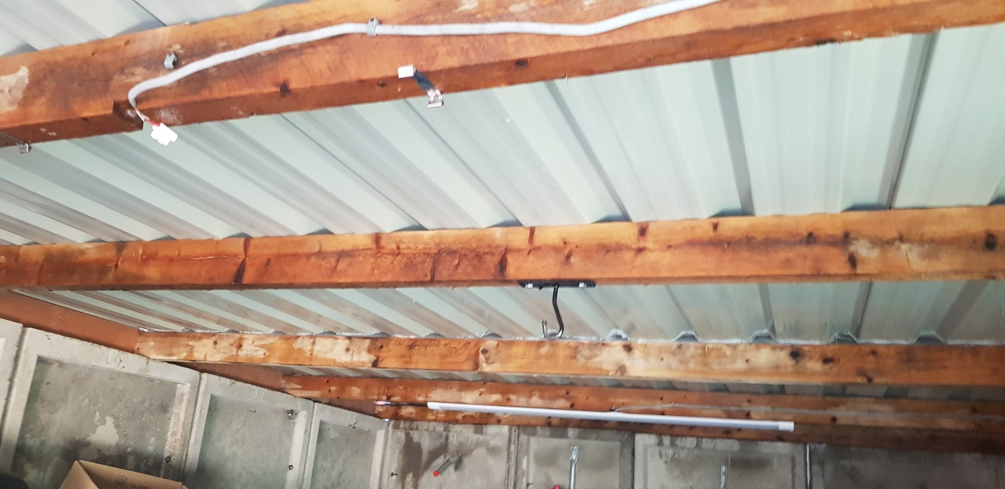

I built my first shop that way, thought I would just use it for vehicle storage....Until the layoffs came, and then I converted itHi guys looking for some information have an old garage few years back I had the roof replaced .Few weeks ago I noticed the joists we soaking I thought there is leak maybe with the screws or something else but then there was no rain last few days and they are still soaking so I'm thinking is it condensation the temperature inside is minus its freezing .Have posted a picture. If it is condensation should I insulate at joists any recommendations

View attachment 427343 View attachment 427344
The membrane becomes the barrier between inside and outside the shed, the roof sheets are now completely outside with air flow under them so any condensation will dry on the outside of the shed not the inside. The membrane will be less likely to form condensation and breath enough to allow the shed to dry under normal conditions. My shed roof is steel and has the membrane hanging loosly like the felt on most houses in the UK.As Tigdlo replied I would have to put counter battens on top of the joist then put a membrane down then put the roof back down is that correct.but how would that stop the condensation within the garage?

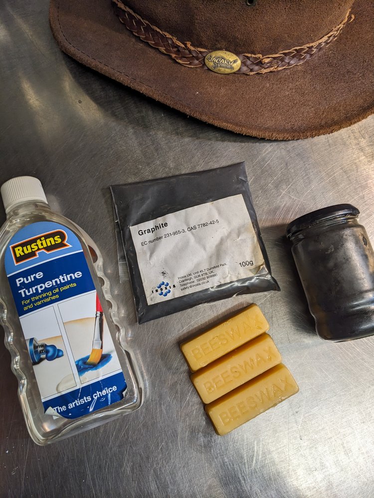

I think it was @Turbo who mentioned this stuff and I tried it out
Many moons ago Matt very kindly sent me a couple of Drummond change wheels which were coated in a similar concoction, it does leave an impressive finish putting to shame my splash a bit of oil on it and wipe it with an old rag approach.The Golom aka @MattF posted this recipe a while back.
Ingredients are cheap and can make loads, can also make it thicker/thinner depending on application required.
Hat not required, been hissing down here, its all I wear in the shed, sorry for the nightmares to any I've met

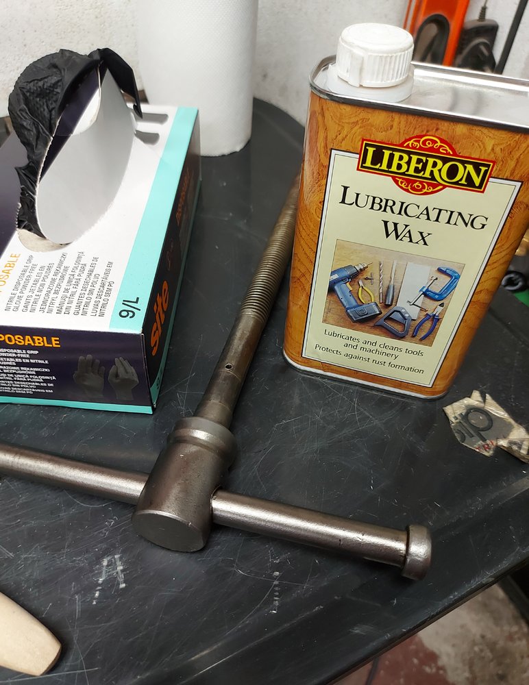

Best stuff I ever used was some sort of aerosol wire rope lube. Possibly Rocol. Thick black stuff. Elliott Sturdimill and may Colchester Triumph were good for 20 yerars. Wipes off easily with wd40 and a cloth. I used it so long ago I can't remember the right one thoughWhat oil do you spray on? My stuff is all small tools really but some metal on the pillar drill and bandsaw tables could do with longer term treatment.
Tool wax seems to work well. I used a squirty can of engine oil to rub on the vices this evening in addition to the wax. (May add strips of wax paper on top of the oil if I get around to restoring a few more vices)
