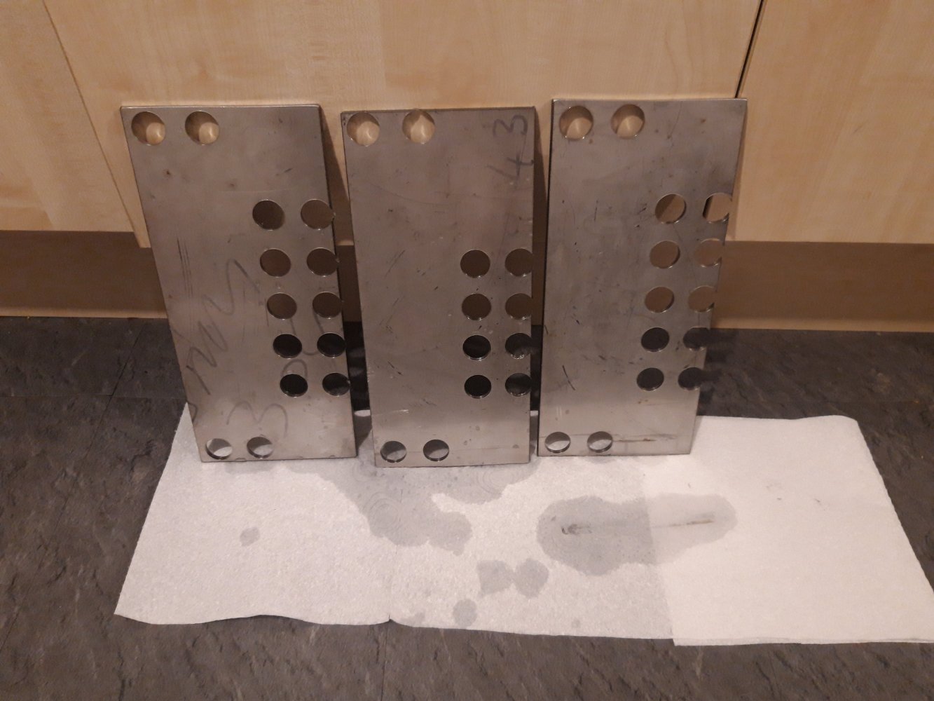

Is it possible put a magdrill cutter on standard pillar drill
Yep, drill adapters are available. But you will need a very low geared pillar drill to use one.
.Holesaw would be my choice. Drill a suitable pilot hole first, seperatly, and fit a peice of HSS lathe tool on the holesaw arbour where the pilot drill would go. It will give a better quality, rounder hole as it wont wobble so much.
Or you could rough cut a 28mm hole, deburr and round with a carbide burr and then finish with a step drill.
32mm step drill?and then finish with a step drill.
