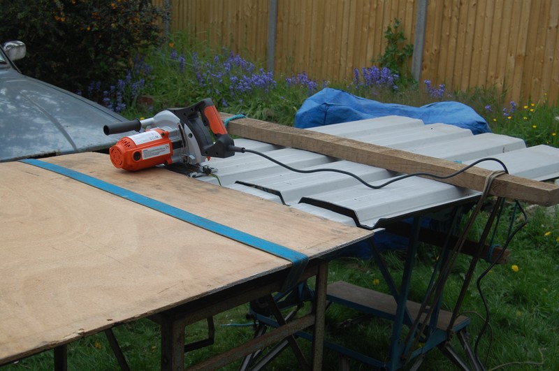

I bought the bigger version of that metal cutting circular saw blade to rip down 6mm sheets, aside of the shower of hot metal snurgs the noise is incredible, laying the steel sheet on ply when cutting does help but still noisy.
