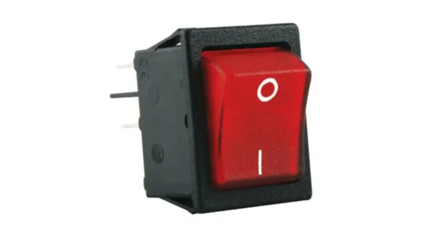

That's going to involve cutting lots of holes in the sheet metal (probably steel, but could be aluminium as I think I have some of each) for the various things to poke through. There will be quite a few push buttons requiring 22 mm diameter circular holes and quite a few other things requiring square/rectangular holes of various sizes (the smallest being for a mains toggle switch, the largest being for a PID controller).
