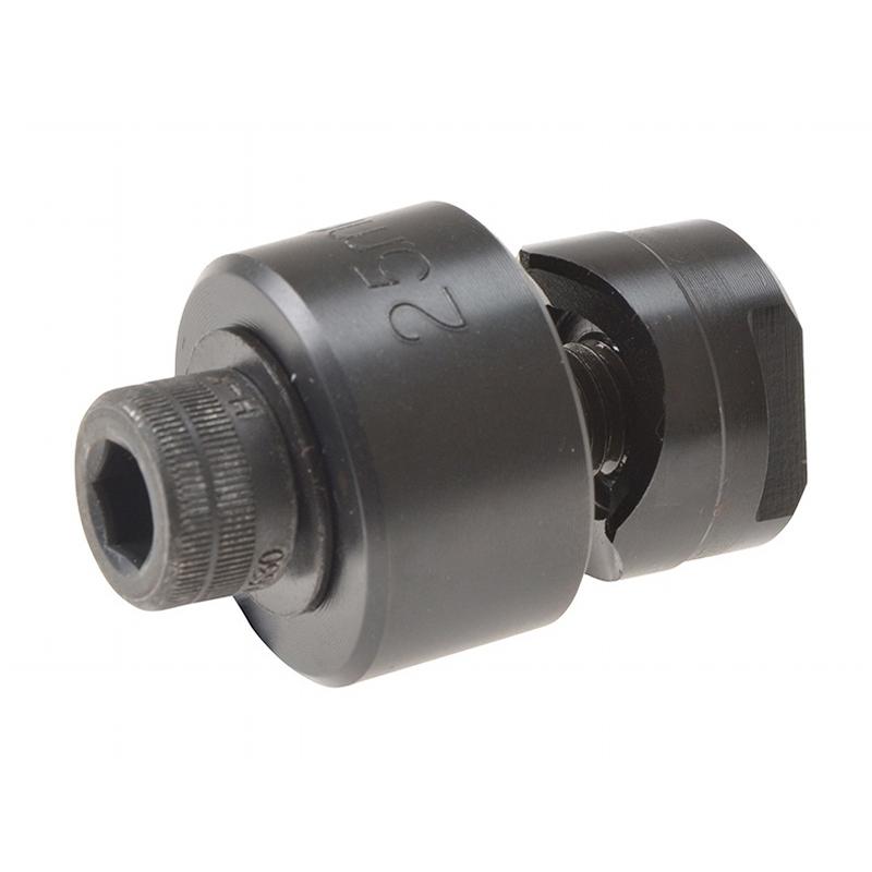

They do make square hole punches too - rs carried a good selection.
I use the starrett/armeg/dart style short holesaws - the one piece ones not the interchangeable arbor ones.
I keep a few of the round knock out/punch ones on the van for when i can't get a drill in or there's cables on the other side. Drill a small 6mm or 8mm pilot and away you go.
