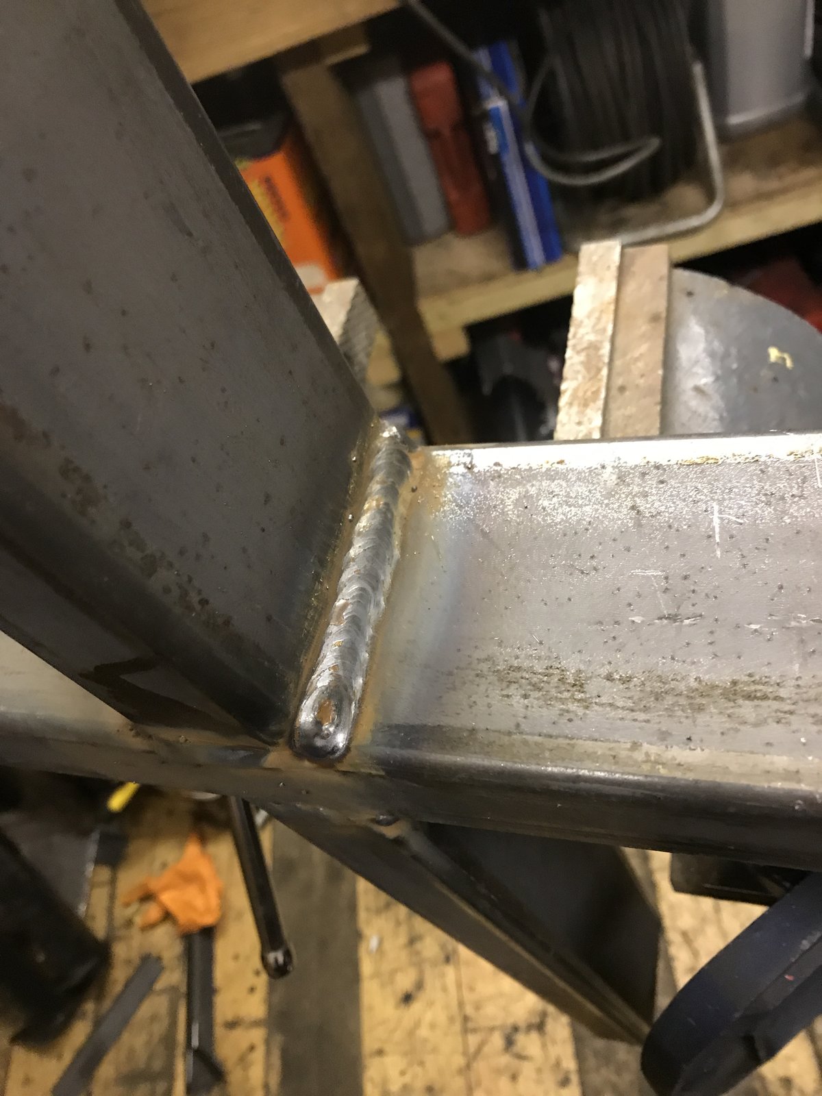

Thanks Gazactually nice welds there kim![]()

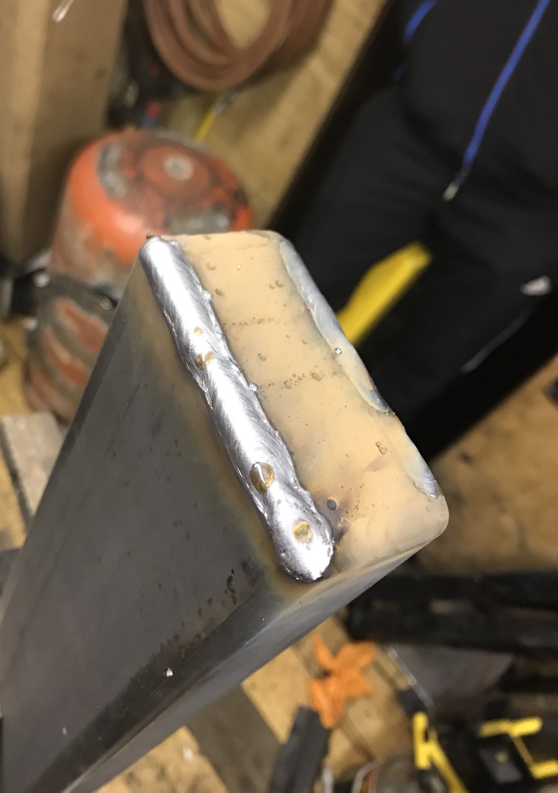

Yes that's it. Makes sense.The glassy stuff? Thats just impurities floating to the surface, my guess is silica, it's very common.
Look very good Kim, I would try and sped up a little bit and don't weave/zig zag/aimlessly wander around for no apparent reason
I had a reason. I thought it'd be stronger
would I be better doing three beads then rather than weaving slightlyCommon mistake/misapprehension, you are far better using stringer beads, unless welding vertical upOkayI had a reason. I thought it'd be stronger

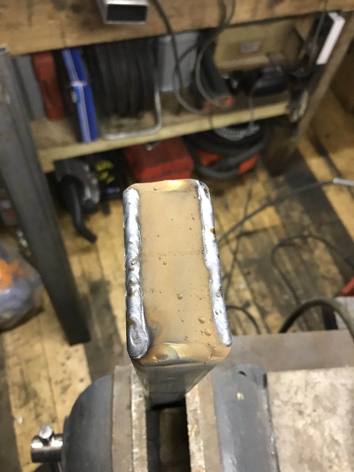

You leave my oak floor out of it Haha.Very tidy, hang about for at least half an hour when your finished wood floors burn......
I think it's been there for ten years.I do mine almost the same although I do mine vertical downIf its purely a decorative end cap, I tend to do them downhand, especially smaller box like 50*3, but even on larger 6mm wall stuff.
Get them nice and neat and requires virtually no clean up.
I do mine almost the same although I do mine vertical down![]()
It did. I ordered some 30x8 flat bar which fitted perfect.Erm, wotsit? Did the end caps fit into the box section by a few mm?
Thanks richard. I'll keep that all in mind. Got some more welding to do later. I'll see if I can get some picsThey are tidy enough and certainly not gonna be falling apart any time soon.
As backpurge said don’t fall into the trap of weaving and waving about. A big fat weld performed with lower speed is quite likely to be a weaker weld than one put down straight and faster (all other settings being equal).
