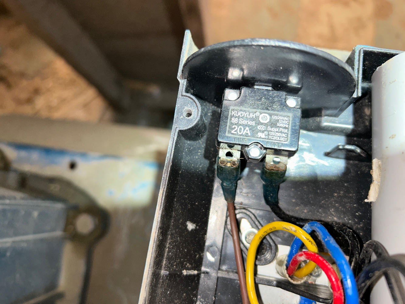

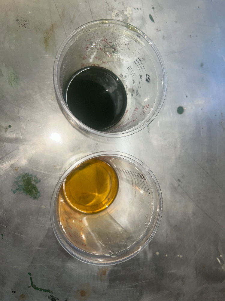

do easy stuff first oil water in the drain then do the hard stuff after cheak the current by putting your clamp meter over the brown wire only on its own (assuming its a single phase)

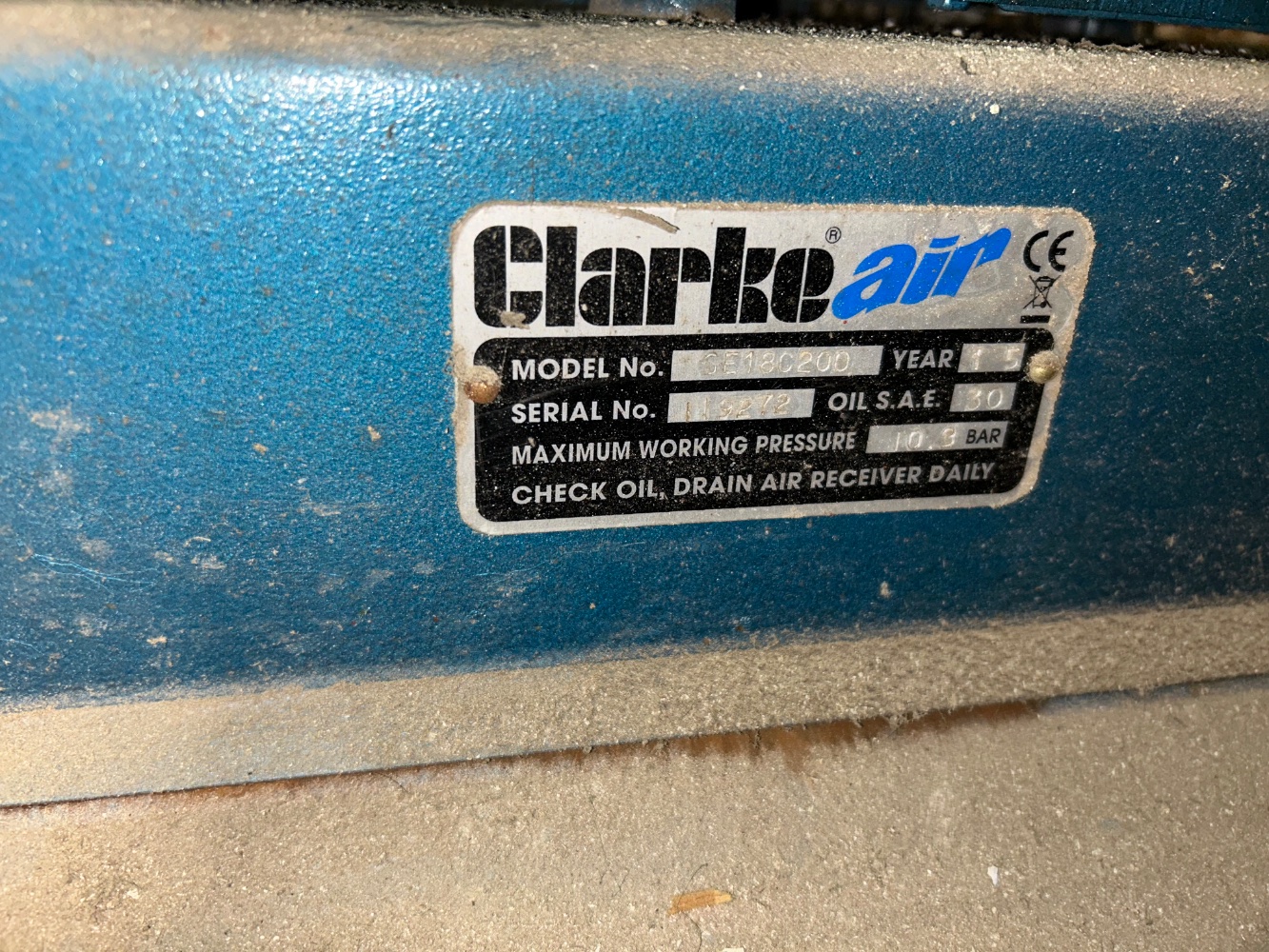

and post a pic of the plate on the compresser so people on here can give more informed ideas
