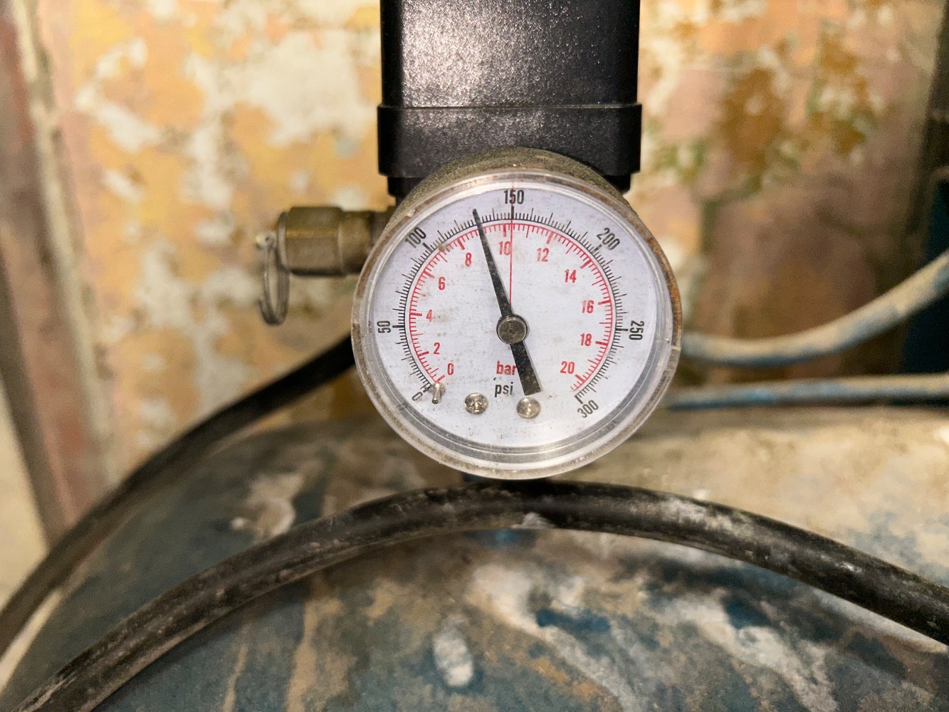

My four horsepower Clarke compressor is stopping before it has completed its cycle by the built in trip switch popping out. It stops without unloading the air in the pipe although if I push the button down on the pressure switch it releases the air.
I changed the pressure switch but without improvement. I unscrewed the pipe which attaches to the check valve and there was no leaking air. I checked both capacitors with the multimeter and they showed a normal reading. I took the front of the motor to check the clutch that moves back and forth, It seems ok. That’s the limit of my troubleshooting knowledge.
Has anyone any ideas what else I might check.
