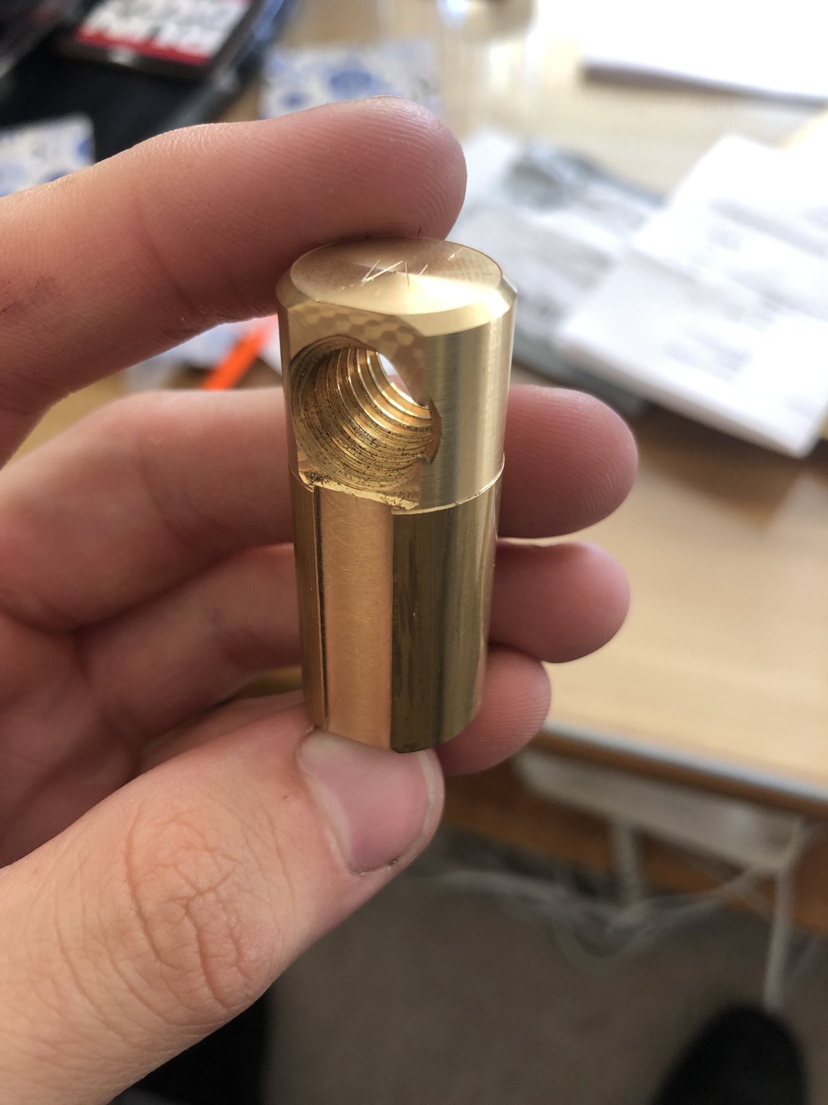

A part which was totally mashed on the original has arrived, bought this from a guy in Cardiff who seems to make them himself. £30, not at all cheap, but a working compound slide is invaluable.
