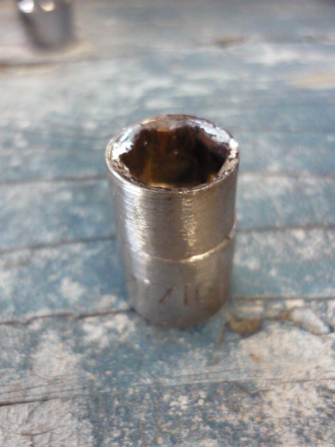

    Went down to the local secondhand shop and picked up a handful of 7/16" sockets for 50c each including this sturdy 6-point one which I butchered (reduced the outside diameter) in the lathe to get the clearance needed. This got another three bolts out so four of the twelve left now - the awkward ones with really poor access.
    brewdexta likes this.
