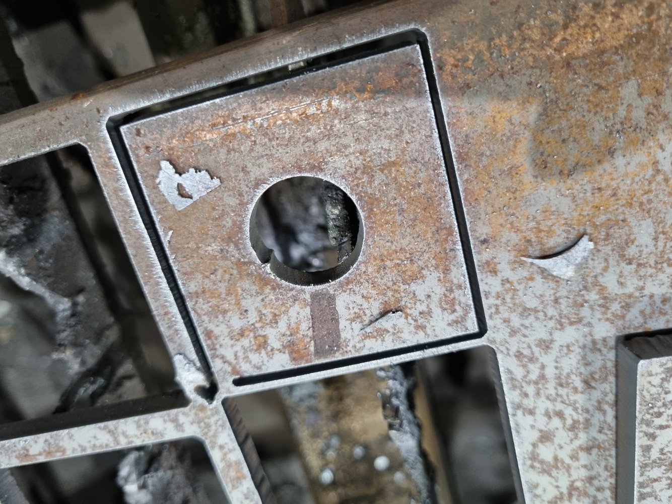

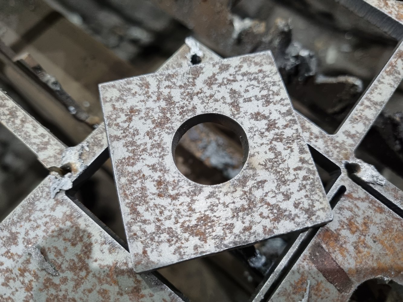

I have never used or even seen a shielded torch so I can't say how they fit together or work.
Regarding the cut height, my THC has a pot on it to adjust the arc voltage and thus I can lower or heighten on the fly, it is very handy when doing a new thickness or material type as I can intentionally choose a higher voltage than I think and then tweak as the cut progresses. I then write down what the voltage was and I am set for the next time
 I didn't use a DTI, just a mark on a bit of plate. I like that idea a lot though, I think I'll do exactly that. I maybe can get a enough performance out of it to be happy.
