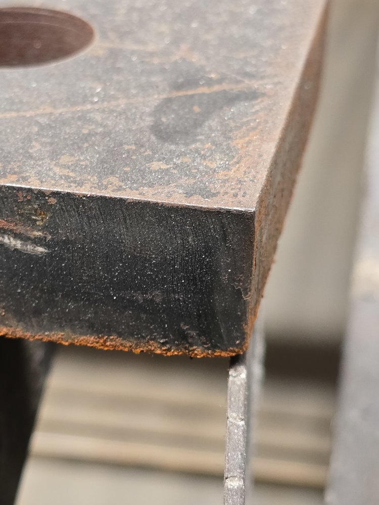

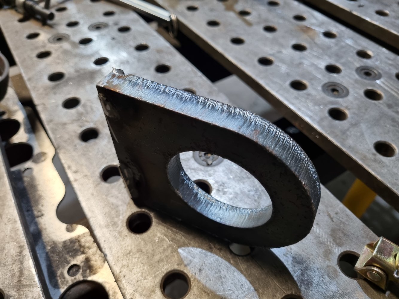

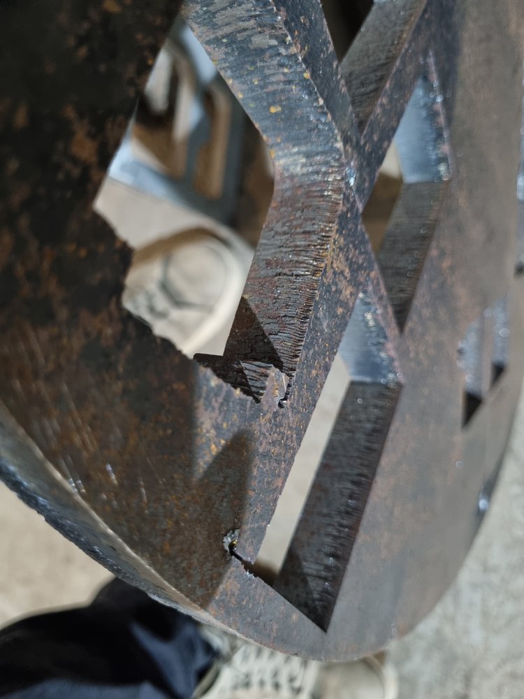

on a plasma forum I visit, one person was doing similar with a Powermax 85, by tweaking the torch air passages.Yes, 50% moreAlso a lot slower, 80mm/min and edge start, max pierce I do is 20mm although I have done 25mm
I wonder if the Jasic torch is modified in that way as OEM ?
Although, his travel speeds were slower than I can do with oxy using Koike hi-speed tips at 100 psi.
