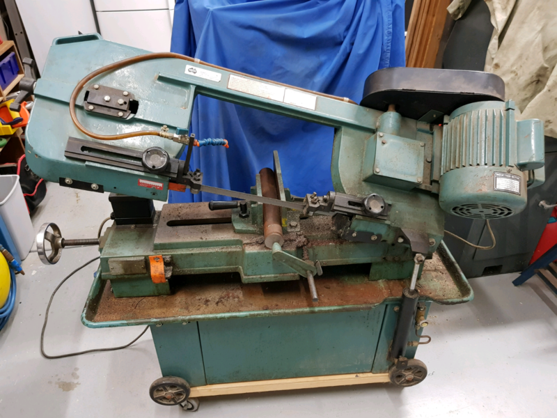

Meantime I need to make up some 1/4 20 finger bolts for the blade cover.
1/4" Whitworth, surely?

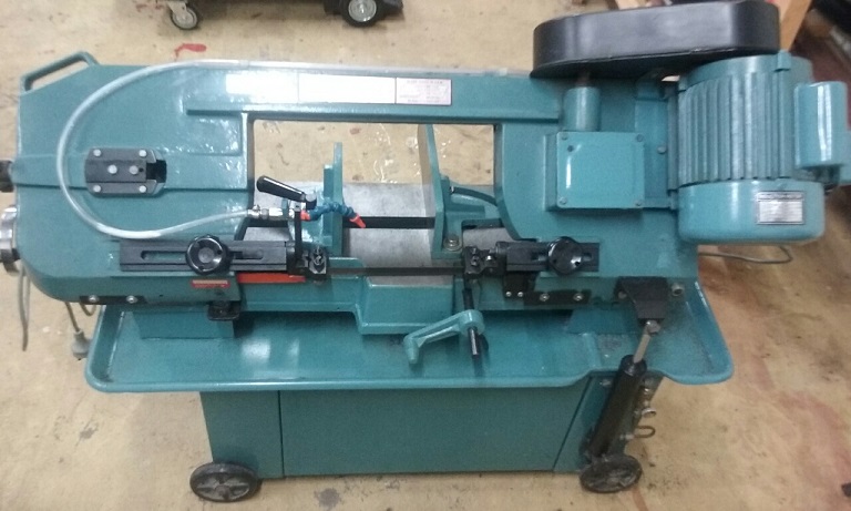

Much better than the original table which is always a joke what ever version / make / colour band saw.Finished bracket prior to paint.
Stuck on some super sticky, heavy roof jointing membrane to dampen vibes.
Fitted. Works well, very solid base, very quiet in operation.
I might do something similar to the other end if only to allow adjustment for square/droop (just in case) but I think it may be overkill.

I just need to get this machine finished so I can make up my welding table and sort out the workshop.
Matched the paint by eye with help of the Dulux colour machine
